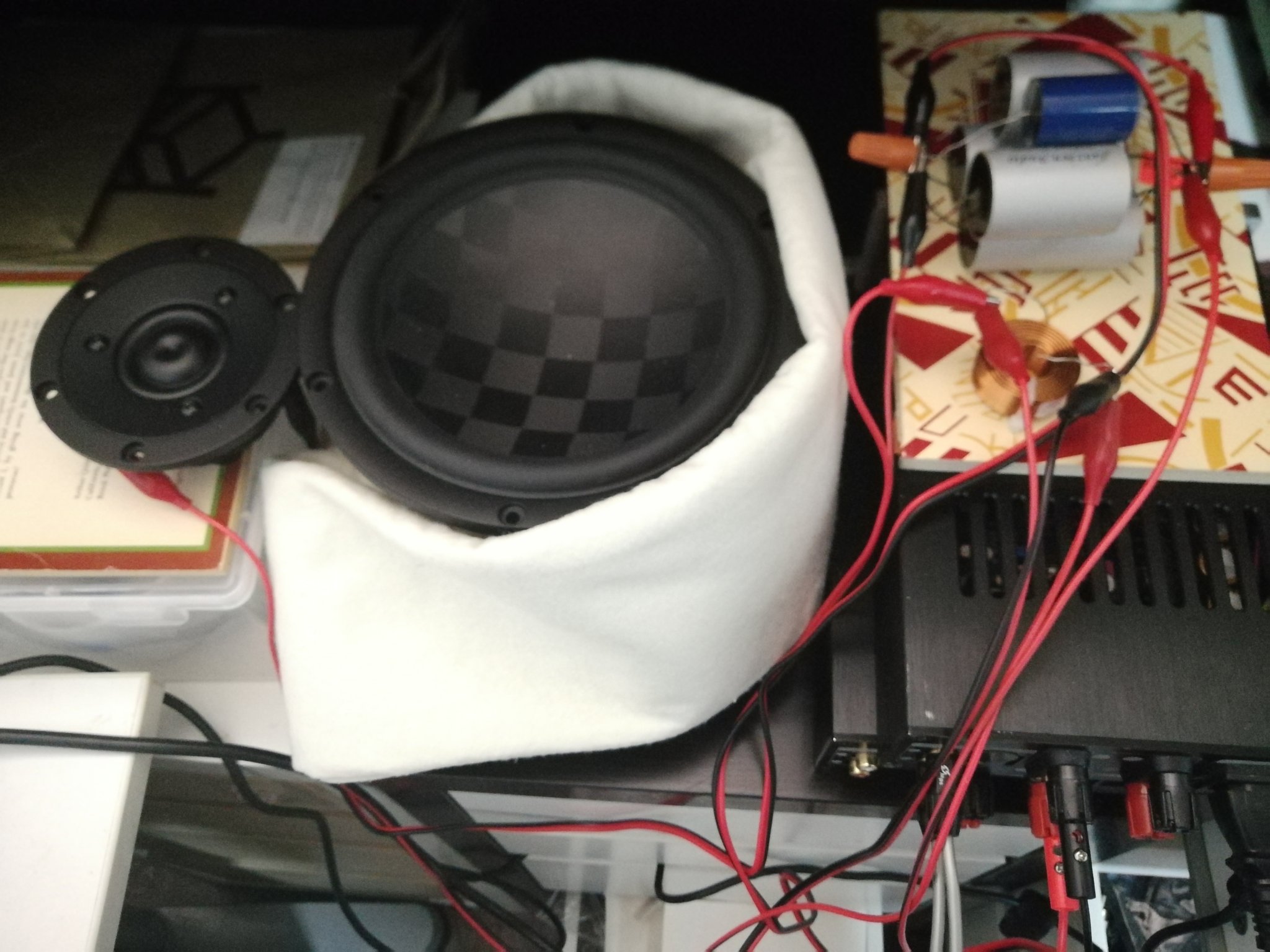

Having lucked into a pair of TW29R at 25% off, I then went for broke and "fished" the MW19TX-8 at 35% off. (Whereas during the Covid years I stayed frugal and DIYed mainly $1-200 speakers, such as 5" honeycomb+AMT 7L TL.) Early this morning I had a few hours before a short trip to Qingdao (I'm on the train now), so played with the drivers and XO.
First I was pleasantly surprised that (judging by ear while playing tone sweep) the Textreme only had a small <3dB bump at 5khz (and then at ~12khz), and only exactly on-axis. This is flatter than nearly all my fullrange drivers. So the MW19TX-8 could be used by itself with a basic notch filter (0.47mH || 4.7uF) or simply slightly off-axis. I then added the ring tweeter 2-way 1st-order parallel (0.68mH LPF; 14.8uF HPF), and lastly 1st-order series (0.68mH, 21.6uF) XO at ~1.9khz. To my ears flat on-axis 850-10500hz (other than 2-4khz natural loudness curve). Played string music pretty nice. Except low bass -- tested without cabinet/baffle (wool scarf wrapped around back of driver). Not yet settled on the tweeter faceplate offset from midwoofer's to try to align acoustic centers; does anyone know?
After my short trip I will try testing the midwoofer in my general-purpose 8" 17L 1.5m TLonken, somehow.
(XO parts are from my Jantzen DIY-reuse coils and caps.)

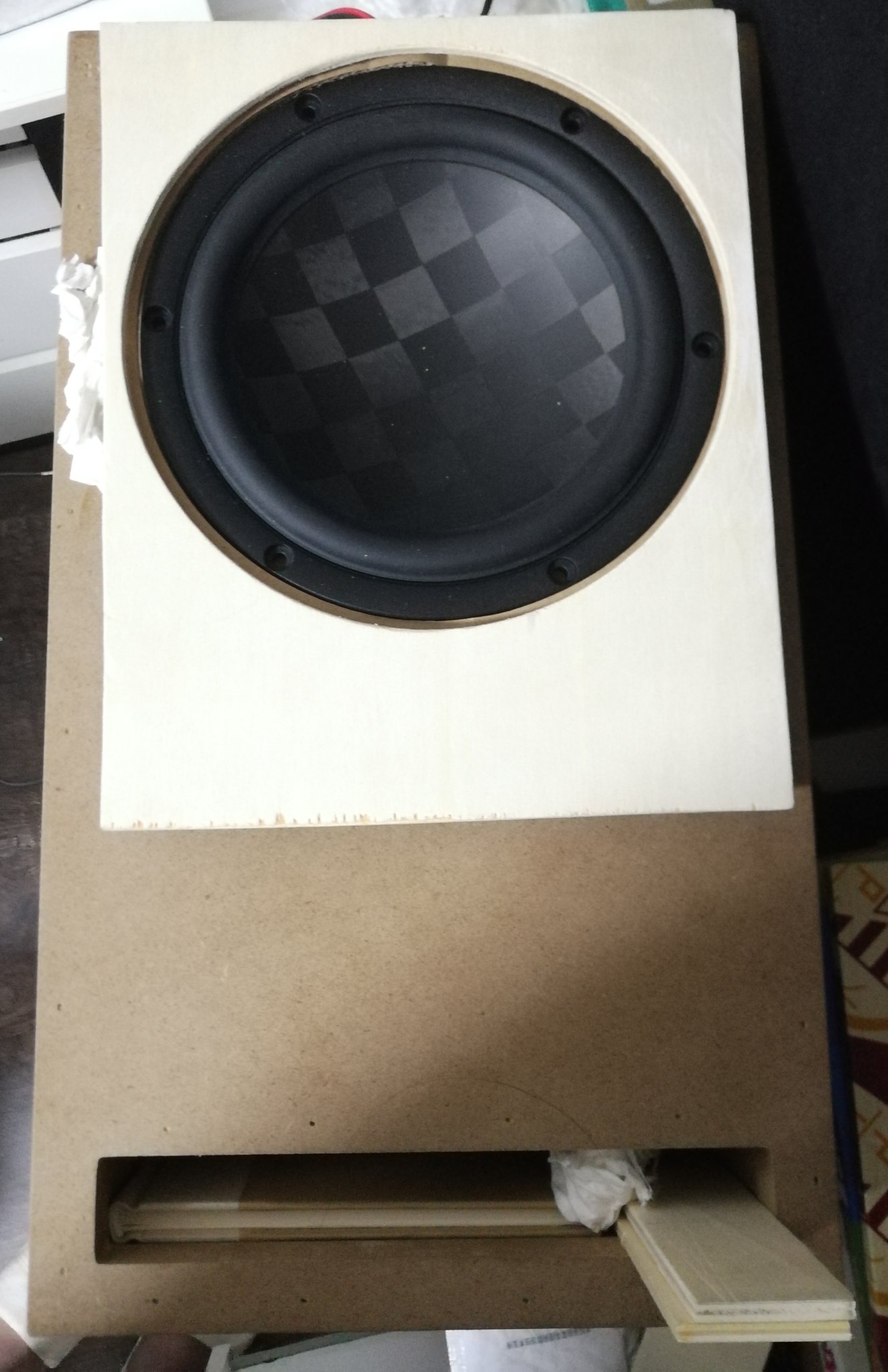

I managed to test the MW19TX-8 "over" my second 17L 1.5m TLonken that hosted an 8" plus topside Wavecor 045 tweeter. (Tapered line cross-section from ~11.5cm to ~2.1cm yielding effective length ~2m by MJK and QW frequency ~43hz which was confirmed by ear using the Textreme.) Baffle-step dip ~315 but the TL effectively augmented the driver response 85-180 so it sounded flat. Below 85 the TL exceeded the driver's direct output, filling in nicely the 60s valley in the FR chart. The 50s dropped quickly i.e. a bit light weight.
Like the Mark Audio MAOP5/Alpair10 mentioned in another post, these are new drivers. The first time through my test suite (organ, piano, double bass etc.) the lowest notes were weak. The second round was much much better! Low bass came alive.
As for the Mark Audio 5&10, I'd say they sounded "reserved" especially at frequency extremes -- a bit like ceramic-on-aluminum. Maybe that's the price of extreme resolving power (yes) or maybe just too new.
addendum: I think the TL contributes three ways: (1) classic backwave phase-shift, 113hz (3m) delayed 1.5m becomes 0deg in-phase +6dB, 57hz (6m) and 170hz (2m) become +/- 90deg +3dB, constructive over the range 37-187hz (1.5m*6 to 1.5m*1.2); (2) MJK quarterwave resonance multiplier effect for R:1-tapered line R^1/4.75 (my redux) here ~1.4*1.5m ~43hz; (3) other, weaker resonances from sections of the line delimited by ends, folds and bends. They can actually be heard.
