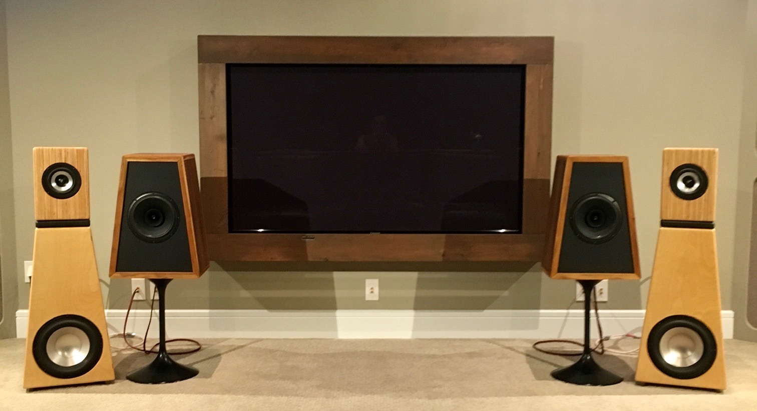

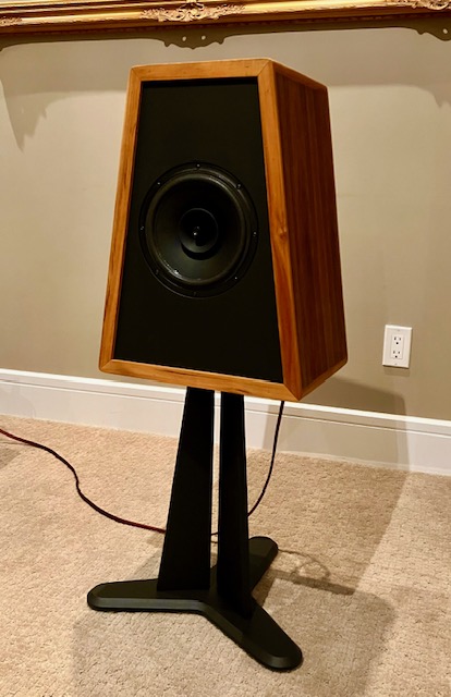

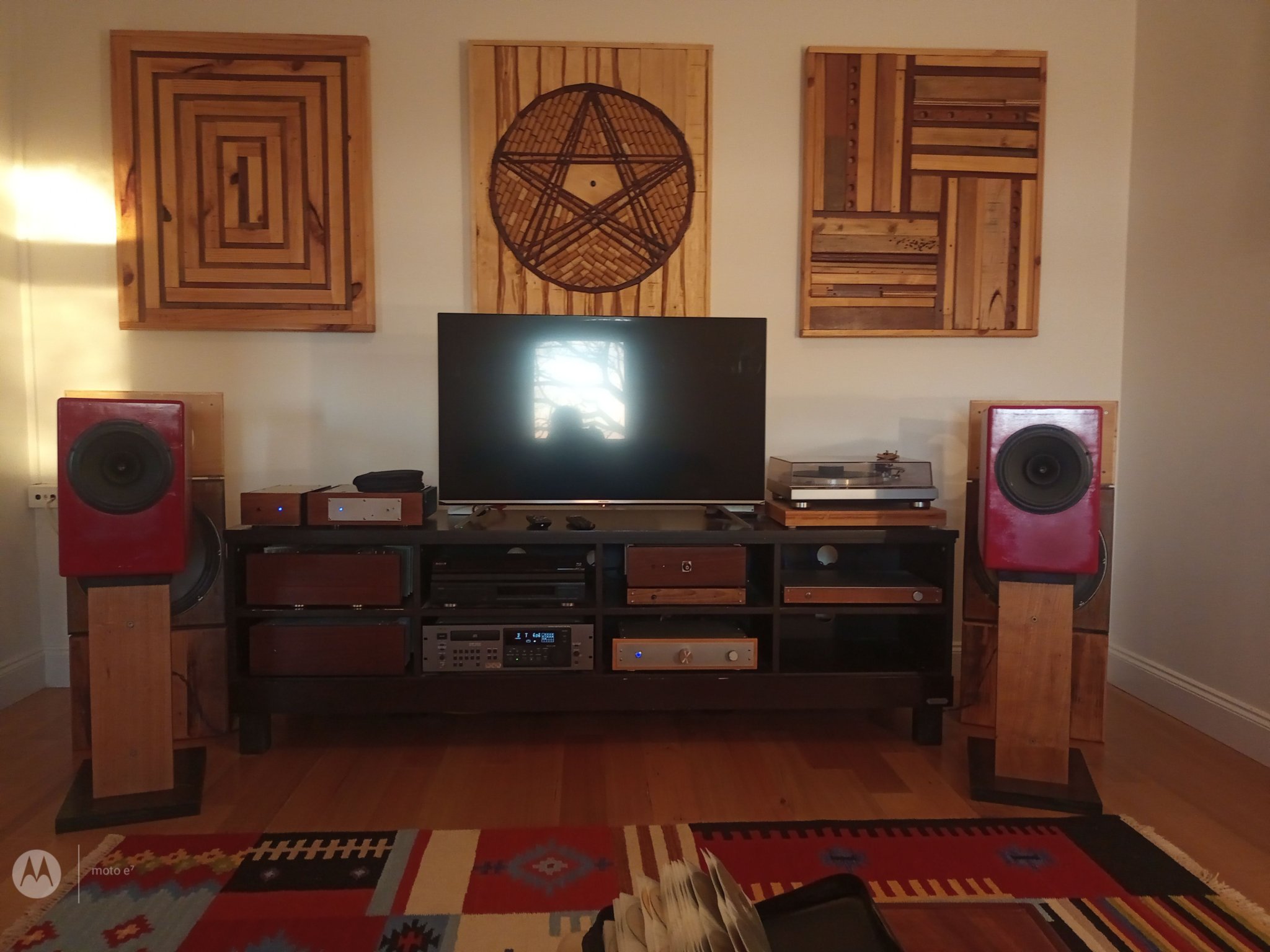

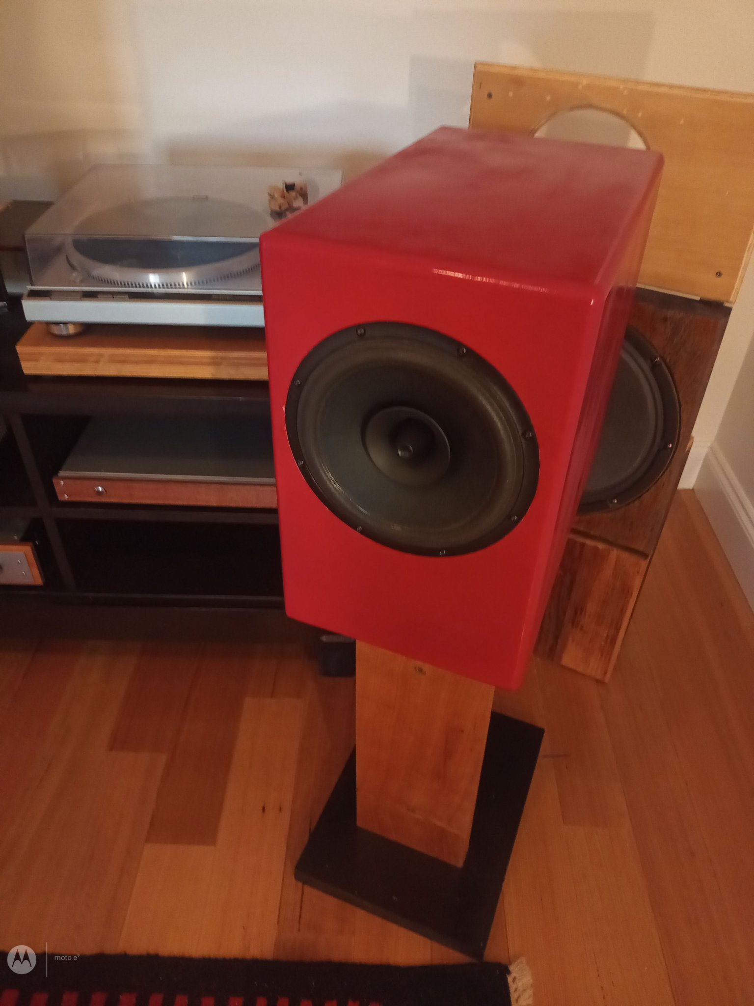

SB 8" full range driver is very impressive! Just finished these last week. 30L sealed heavily damped cabinet. Finished in Teakwood, internals, front and rear baffle in baltic birch. View attachment 1124025View attachment 1124026View attachment 1124027

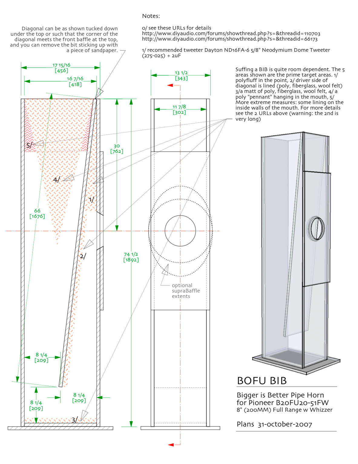

The SB Acoustics SB20FRPC30-8 has specifications close to Pioneer B20FU20-51FW, huge cabinet with deep base ! http://frugal-phile.com/

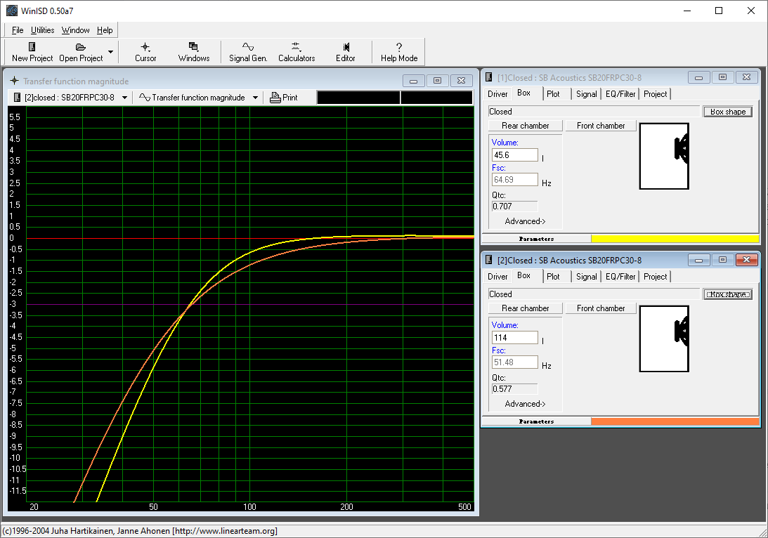

Easy to calculate in modern times with a Spread sheet / Simulator.
Since equations are already included.
Sealed, Max flat response is Q or Qtc of = .707 which is 45.6 liters (yellow)
Max flat delay is Qtc = .577 which is 114 liters ( orange)
The response matches transfer function of lower Q Butterworth or Bessel filter.
So if you want more punch or bass you can add that with normal EQ with different music.
If Q is higher which some use, ( smaller box ) Any speaker can be likely to get boomy or sound like EQ already added but cannot be turned down.
Like .6 to 8 Qtc or to small box makes peaks in lower response.
For ported. Driver Total Quality or ( Qts ) is not really high. but is high at .45 for this driver so it will want a bigger box. To also not be too boomy, flat response. So EQ can be added depending on music. High Qts usually use 4th order filter to align the response. So use .577 Qtc volume = 114 liters. Expect leakage with port is expected
100 liters more reasonable.
No guessing with port tuning, Driver Fs is answer. No more than 3 to 5 Hz below or above. 3rd order tunes above , 4th order tunes below or same as Fs
We want 4th order. Fs is 39 Hz so tune below 3 to 5 Hz or 34 to 36 Hz
100 liters 35 Hz port tune
Assume driver has typical 6mm front plate Xmax likely not more than 3 or 4mm, power wont be too high so port really doesnt have to be too large.
Normal 2" to 2.5" inch size is fine. In 100 liters wont be much longer than 1 to 2 inches for 35 Hz need to calculate yourself when you buy port based on size.
View attachment 1400678The SB Acoustics SB20FRPC30-8 has specifications close to Pioneer B20FU20-51FW, huge cabinet with deep base ! http://frugal-phile.com/
By my quick calculations, the SB20FRPC30-8 asks for a BIB of about 420 liters. But his design would also be acceptable.
I highly recommend the BIB style of design. It allows very deep extension and very open, realistic bass sound. If you can live with it's height.

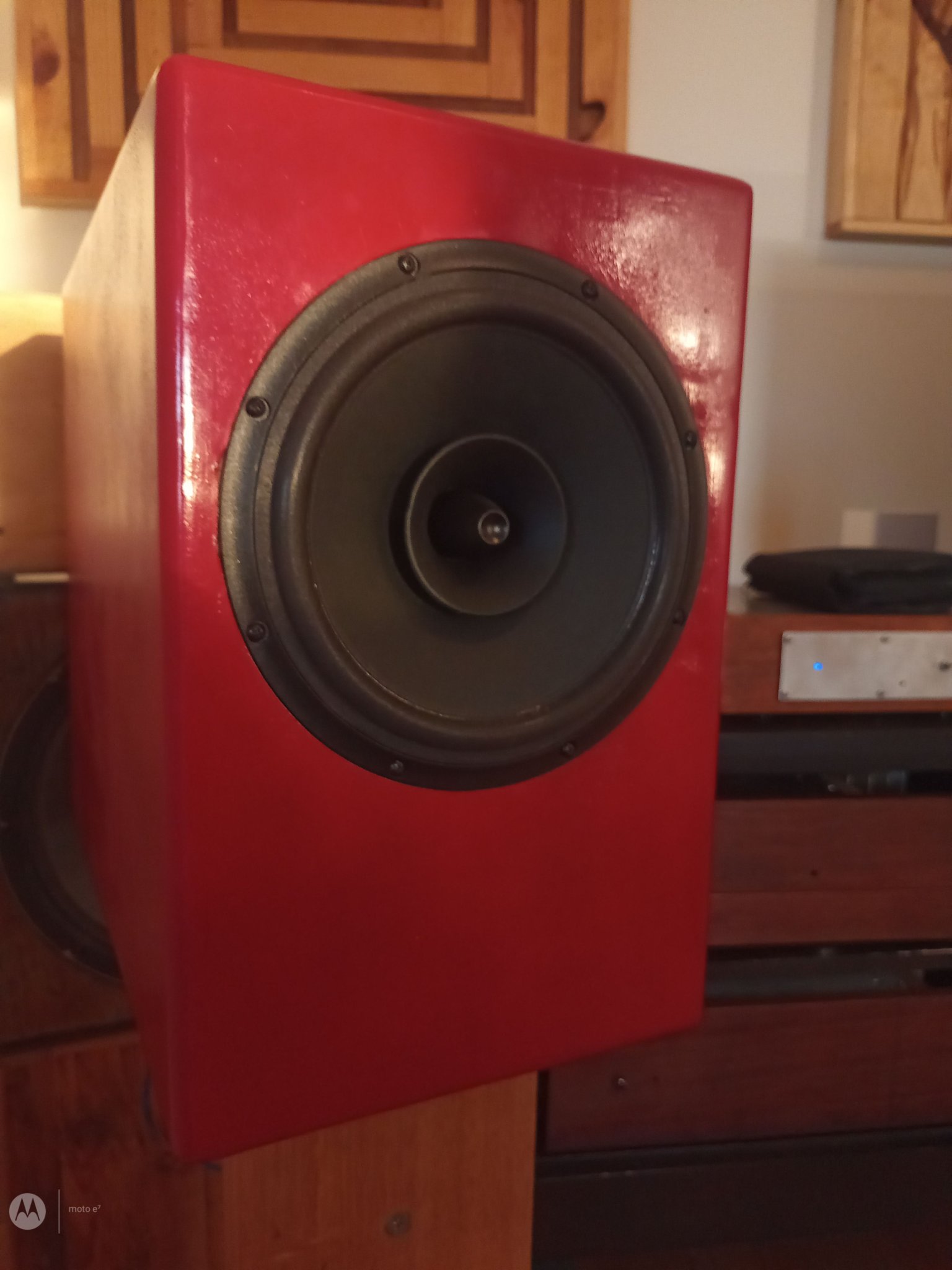

My SB20 in a 30L aperiodic (technically leaky sealed) cabinet.
Very powerful bass response.
Fantastic clarity and detail.

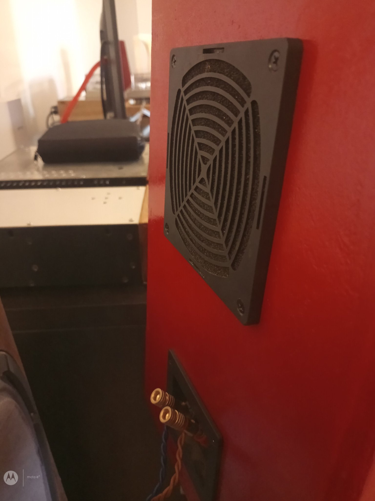

Hi @Stanislav
Very nice compact enclosure.
Could you share how you made your enclosure an aperiodic enclosure. Looks like a cooling fan protective plastic screen with a dust filter but I could be wrong.
My pair of SB20 is being delivered this afternoon.
Thanks,
Eric
Hi Eric,
It's very simple to turn a sealed box into an aperiodic one, just cut a hole, either at the back or at the front, stuff that hole with some felt or foam and start measuring the impedance of the speaker. Aim for a flat impedance at the resonance. But then listen to some material you are familiar with as if you stuff the aperiodic vent too much you are back at a sealed enclosure. The idea is to restrict the air flow, but not to block it completely.
I've been using aperiodic boxes for a very long time as I found they, like open baffles, have excellent transient response and produce the most natural mids and bass.
The vent itself is indeed a fan protective cover with a layer of felt inside.
Dynaudio had some variovents long time ago which had relatively soft foam in them.
Cheers
Stan
