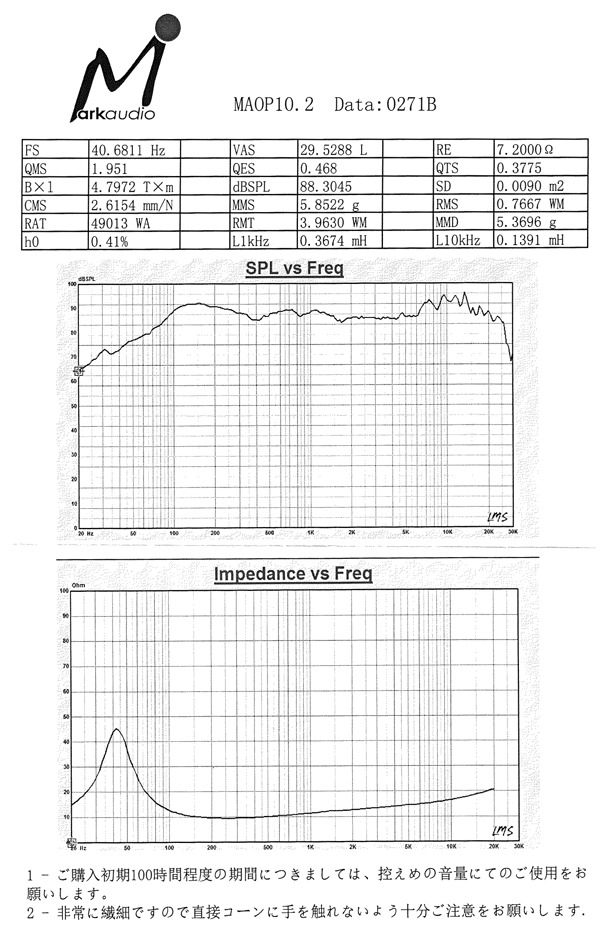

MAOP 10.2 still has a rising response of 15dBs from 6kHz to 12kHz! 😀Maop10.2 dont need off axis.

Well, I thought a 15dB rise starting at 6kHz was easy to understand, but a picture is worth a thousand words, they say, so here it goes:When listening to the Maop 10.2 I can't hear the volume increase as you claim.

Thanks. It start to raise at 6000hz.Well, I thought a 15dB rise starting at 6kHz was easy to understand, but a picture is worth a thousand words, they say, so here it goes:

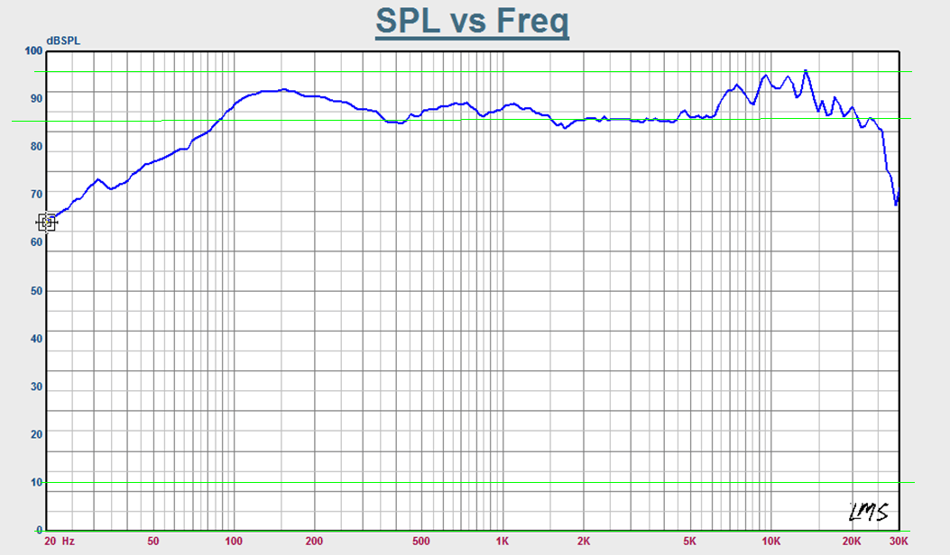

It also shows the danger of pictures. 😉 It's actually averaging about 8dB - 10dB, give or take a touch for a given TL mode. Owing to the way LMS outputted data, if you look carefully (not easy with small drawings), you'll see that the vertical scaling values aren't aligned to the horizontal graph lines -if they were, it would be a 120dB Y axis scale rather than the 100dB it actually is. It's one of LMS's little presentational foibles if you went with default settings at certain scales. Go figure.Well, I thought a 15dB rise starting at 6kHz was easy to understand, but a picture is worth a thousand words, they say, so here it goes:
See attached: I've roughly drawn in two of the 10dB vertical divisions between horizontal green lines. This is by hand in Windows Paint for brevity so it's not perfect but ~'near enough' to illustrate.
