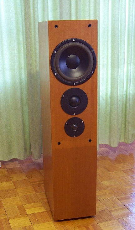

I think you are going to love these drivers as they are very similar to my Satori 7.5" and beryllium tweeters. I listened to them for the first time las night and they are great. Still need burn-in time but the bass was very deep with a calculated F3 of 41hz. You could probably enjoy these without a subwoofer.
The tweeters have very good imaging. When I close my eyes, it sounds like the singer is right in front of me even though my speakers are about 9 feet apart. There is no harshness on the ears, very smooth.

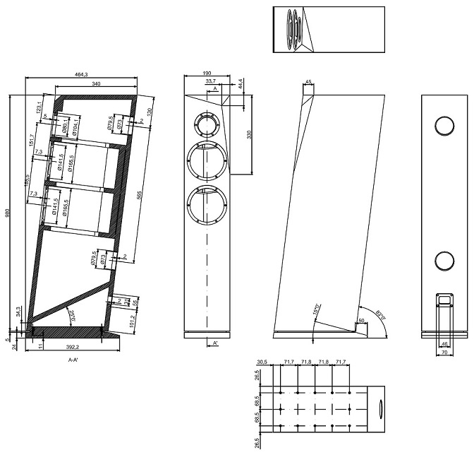

I just happened to finish my second speaker build last night at midnight using the Satori 7.5" and the beryllium tweeter. Looks like the Satori caught your attention too. Haven't had time to listen much, didn't want to wake the kids last night, but I'll let you know what I think of the sound.
My design is a 2-way, 28 liter box using 1.5" thick MDF with bamboo veneer, 2" port. I actually considered an MTM design like yours but chose my 2-way design with a sub for simplicity and cost reduction. Good luck with your build, looking forward to hearing about it. Here is a picture of my design.

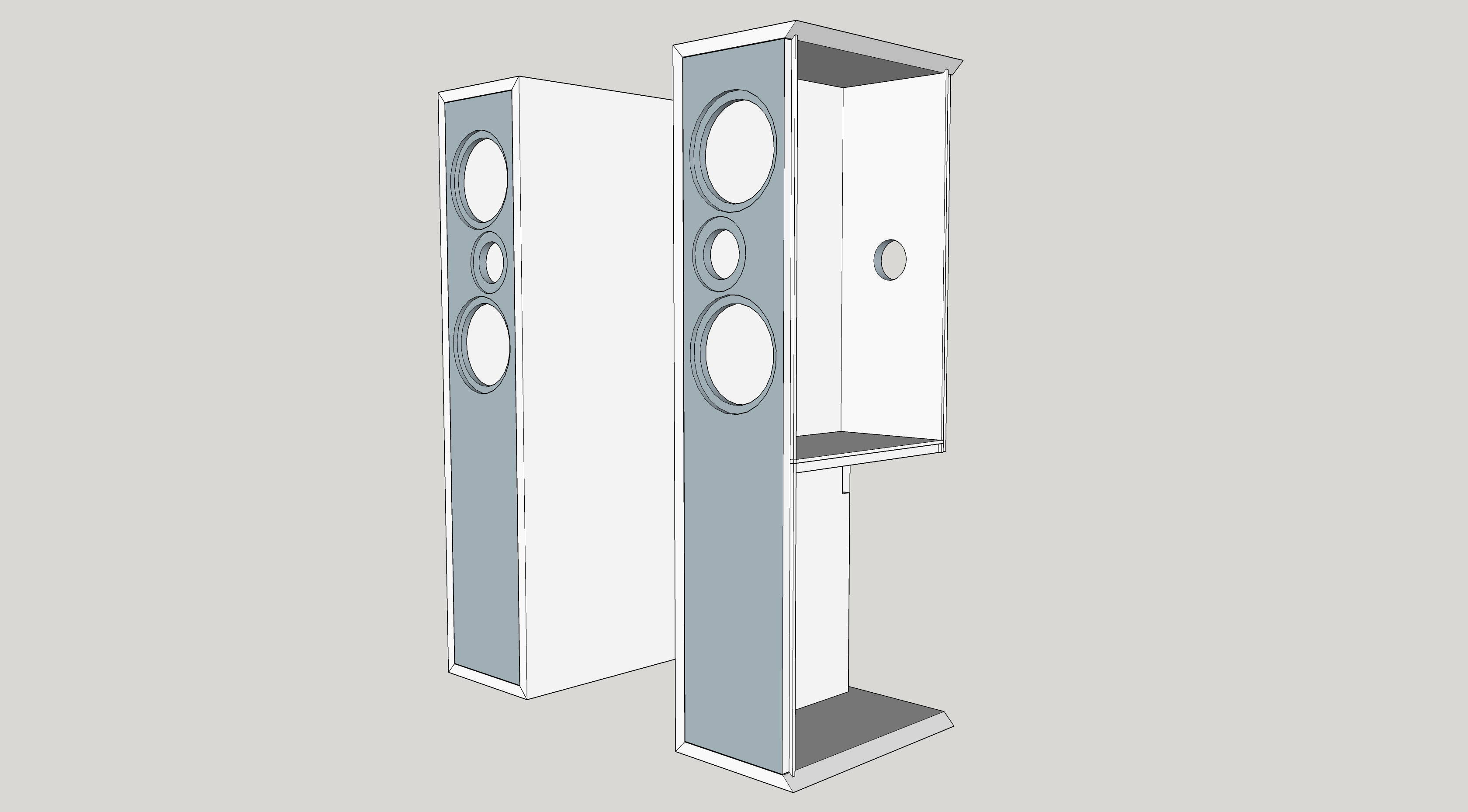

Thanks for your encouragement Curt. Enjoy the music. The pictures make those cabinets look quite big. I think I have settled on making cabinets just as big as the driver enclosure rather than towers as per my original posts - as you say, there is a greater possible versatility with the addition of subs to supplement the bottom end.

Have settled on just the driver enclosure (not tower) but with changed external dimensions to accommodate altered geometries inside i.e. some non parallel sides.
