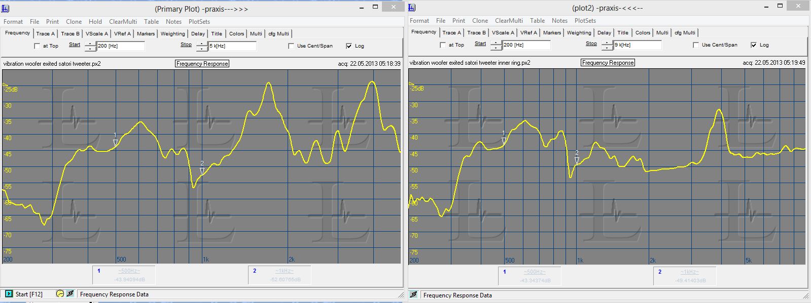

When i read this i got an idea. I have an accelerometer that i can fit to the silver outer ring and to the black inner part of the Satori tweeter.
Lets see if i can find some reduction of resonance.

So the excitation is voltage input to the crossover, and both woofer and tweeter are inputing inertial vibration with the woofer pressurizing the cabinet. Yes? I am guessing the inertial input from the tweeter dome is negligible.
The outer ring shows higher vibration below the crossover frequency and lower vibration above. The inner ring shows the opposite. Yes? If the inner and outer ring were "decoupled" (connected) by a spring, we could expect a resonance between them, which must be well damped. Such a resonance would form a second order low pass filter to reduce tweeter (inner ring) motion above the resonant frequency. This behavior is not obvious, but could the "decoupling" be tuned at about 1500 Hz?
Is the tweeter backed by its own sub-enclosure? Or is the tweeter subjected to pressure forces in side the cabinet from the woofer?
These measurements are difficult to interpret. I suspect that the people at SB Acoustics must understand these, and have given it much thought.

I measured the tweeter without a crossover in a test cabinet, woofer not connected. I will pupish more details.

The woofer is not driven, this was a good choice as it is simpler. The decoupling corner frequency is at about 1800 Hz or maybe two similar modes at 1500 and 1800. The damping at 1800 Hz is fairly low, so maybe not too much hysteresis.
Another informative measurement would be with woofer driven only. Presumably we would see similar result? Reciprocity, if sufficiently linear.
Wise not to comment, as it is easy to jump to (perhaps wrong) conclusions based on so little information.
The relevance of these acceleration measurements depends upon their magnitude (in say m/sec^2) compared to tweeter diaphragm acceleration at the same drive voltage. Yes?
Charlie

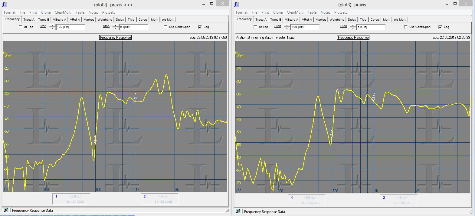

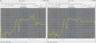

Interesting. Praxis lets you plot both measurements in different colors - would be easier to compare.
The 1800 Hz peak reduced by 25dB, the 3900 Hz by maybe 8 dB. The transducer resonance is well above this frequency, i assume?

Yeah. Doesn't look good. But if posted side by side with similar ring radiators, may be worth a few hundreds words.
I posted the measurements side by side because my Praxis software has a bug and i can not do overlay. I will talk to Bill Waslo how to solve that.
Yes, i could make a comparison to a tweeter that does not have the decoupling ring.
Anyway, it has a positive effect.

My assumption that the purpose of the decoupling mount is to isolate the tweeter dome from cabinet vibration must surely be false. The coupling would need to be far softer for that purpose, with a corner frequency below the woofer's Fc. Perhaps the purpose is to reduce spurious vibration, radiation and energy storage in the tweeter structure. Note the acceleration spectrum is significantly flat with frequency (which would imply mass-controlled motion).
Since these measurements are made at one location only, we don't yet know how it changes around the surface of the face plate inner and outer rings. This is a deep subject, and a laser vibrometer would be most helpful...
But, yes, it would be interesting to see how a similar tweeter of conventional construction behaves.

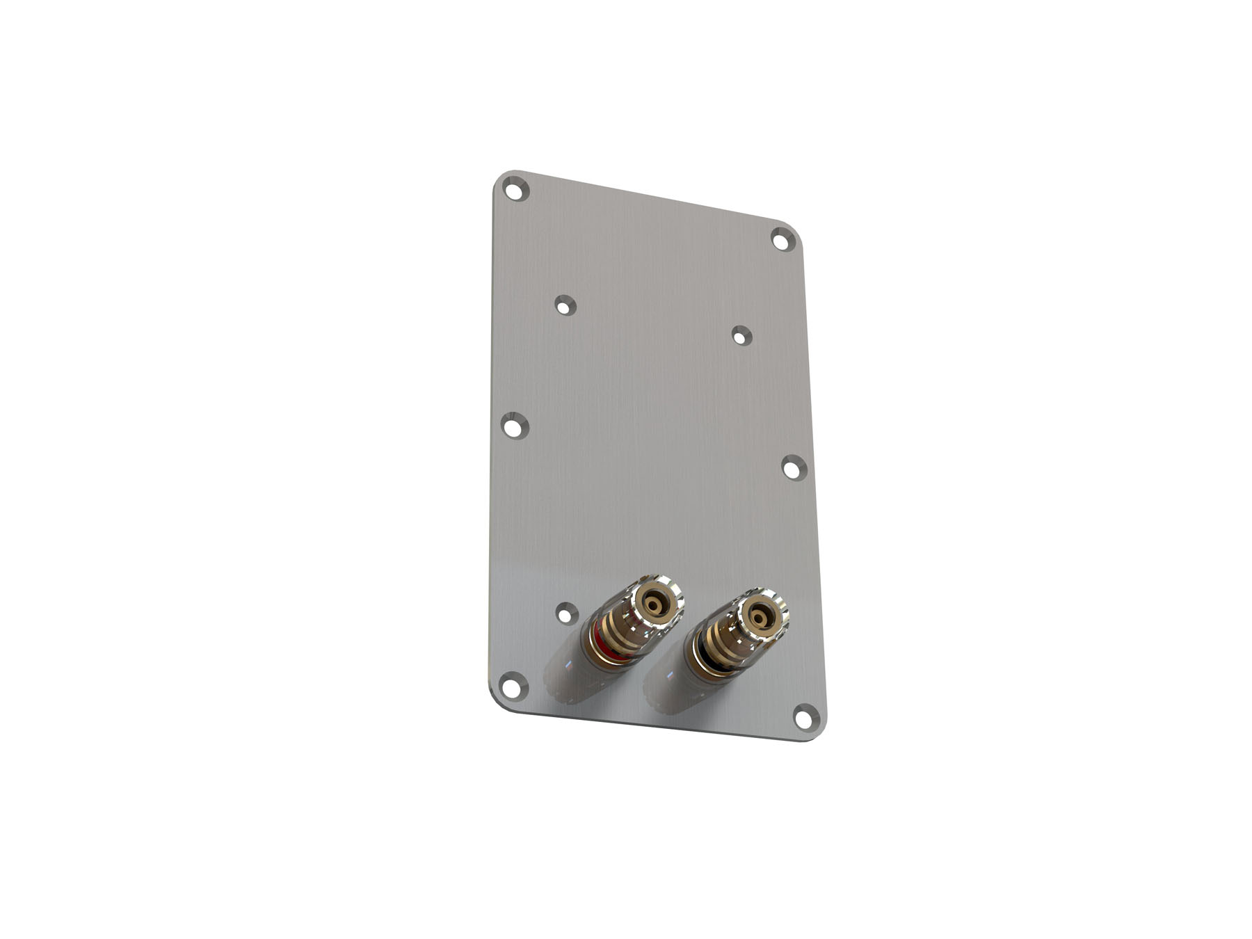

I just would like to remind everybody that the official Satori Monitor Kit needs an
8 OHM WOOFER, and NOT a 4 OHM WOOFER:
I do not know why, but there was some confusion about it.
SB is now working out the details, for example how to fit the crossover.
The space inside the monitor is spars so we decided on a aluminum terminal at the back that also carries the crossover.
Cabinets are ordered and will be available soon.
