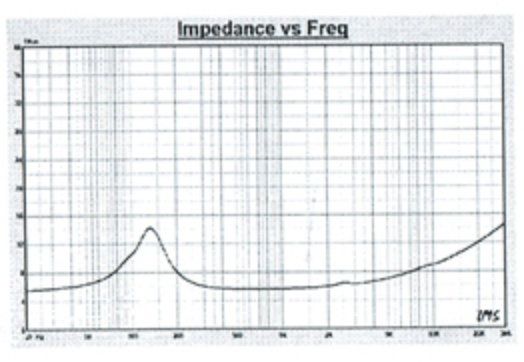

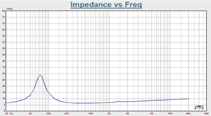

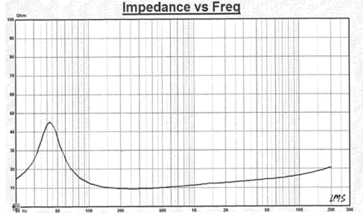

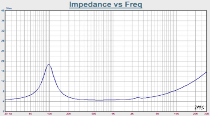

As far as i know they do. Look at the indictabce and the high frequency impedance. CHN-50 is a cheapy, it might well not (depends on whether there are a ton of Alpair 5 polepieces sitting unused. Looks like that may well be the case.
CHN-50 Le 1kHz = 0.06 mH
MAOP 10.2 Le 10kHz = 0.1391 mH
MAOP 5 Le 1kHz = 0.0681 mH
Alpair 5.3 Le 10kHz = 0.0399 mH

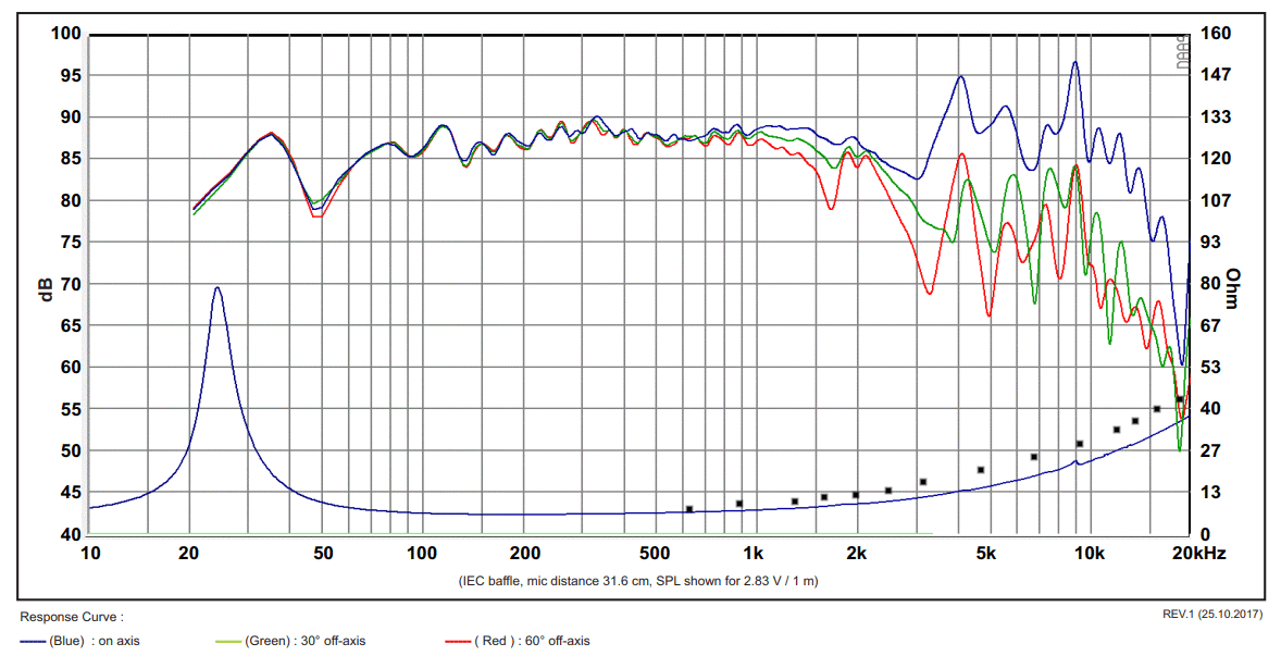

I must admit it's hard to tell just from the graphs. ~20 ohm @ 20kHz (for 8 ohm nominal) seems like a good low value, but is it 'magically low'?
I checked a couple of datasheets and maybe they're a bit coy -- like for the chn-50 they mention "careful motor design" as the reason for the modest impedance rise. And for the Alpair 5 they make no mention, so it could be that they don't advertise the feature, or they use a shorter voice coil with less over-hang. Pics would solve the mystery.

So if you look at the dotted part of the curve...
...that won't be perfectly stable. With low frequencies moving the VC around, that is likely to bounce up and down a little, causing amplitude modulation of the mid-range, especially 1kHz and up.
The (not so) 'ideal' fix for that would be a near-perfect current source with 1k ohm+ in series, so that +/- 1 or 2 ohms variation will have virtually no effect on the total current, but that's impractical, and could cause other problems like thermal runaway if the voice coil starts to get hot.
