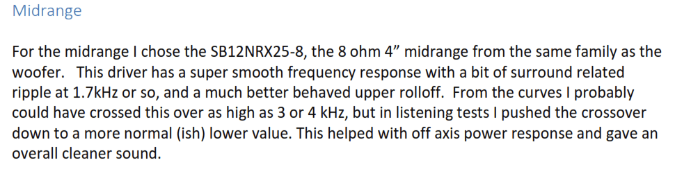

Actually looking at the schematic, there is no resister in line with the tweeter. You could add one between the input and C3. Not much, start with 1 ohm.
Any resistor added to this circuit will alter the shape, phase, and response. Adding a resistor to the amp-side (rather than tweeter side) is the least disruptive way to attenuate.
You could also install an adjustable L-pad. I have never used one, but other people have had good results.
Oh wait, you were talking about increasing tweeter output. Since there is no attenuation on that tweeter, I can't see an easy way to increase tweeter output.
Yes, R1 is 47 ohms. It's in parallel with C2 and the woofer's coil. It's not a resistor that's intended to lower the signal going to the woofer like a resistor in series with a tweeter or midrange driver. It's been 12 years since I built the Sonatello and I don't remember specifically what its purpose is, perhaps some amount of damping, but it definitely should be there and that's the way I built it.Hi Paul sorry to bother you again but I notice that R1 is 47.0 ohms is that correct as it seems very high.

Let me explain a bit further. The Sonatello was designed with the woofer low on the baffle in order to benefit from the floor boundary and not need as much BSC and result in a higher sensitivity. Then the crossover was designed to optimize the system response with the other drivers, especially the midrange, based on their locations. If the woofer is moved up very much those two design accommodations may not work out well. With the three drivers located as I built the Sonatello, one could design it as an ML-TL, which is in essence an optimized ported box that takes into account the internal dimensions of the enclosure, not just only the enclosure's volume, and the woofer and port relative locations which affect the overall bass response shape up to 1 kHz. Typical ported box design software or equations do not allow such optimization. As I have shown you with photos, the backs of my speakers are also located close to the wall, yet sounded just as good to my ears at DIY events where they aren't so located.If you do what you describe using the same drivers and crossover as in the Sonatello, you may not be happy with the results. Placing them close to the wall will not be an issue. Moving the woofer up a small amount may not be problematic, but the air velocity in the port will be significantly higher than in the terminus of the tapered TL in my build. Also, unless the modeling software you use to make it a ported design also takes into account internal dimensions of the cabinet and locations of woofer and port like the TL modeling software from Martin King I use, you may cause some problems in the overall smoothness of the woofer's response.
