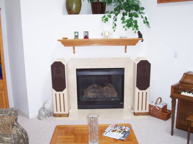

The back of my Sonatellos' cabinets were 5-6 inches from wall. They sat on the fireplace hearth, which is level with the floor where the fireplace front is in a corner at 45 degrees (I will dig up a photo to show you this arrangement but it won't be the Sonatellos, instead another pair of speakers similarly arranged).Hi Paul

Hi Paul,The back of my Sonatellos' cabinets were 5-6 inches from wall. They sat on the fireplace hearth, which is level with the floor where the fireplace front is in a corner at 45 degrees (I will dig up a photo to show you this arrangement but it won't be the Sonatellos, instead another pair of speakers similarly arranged).
Thanks again so close to all walls then.

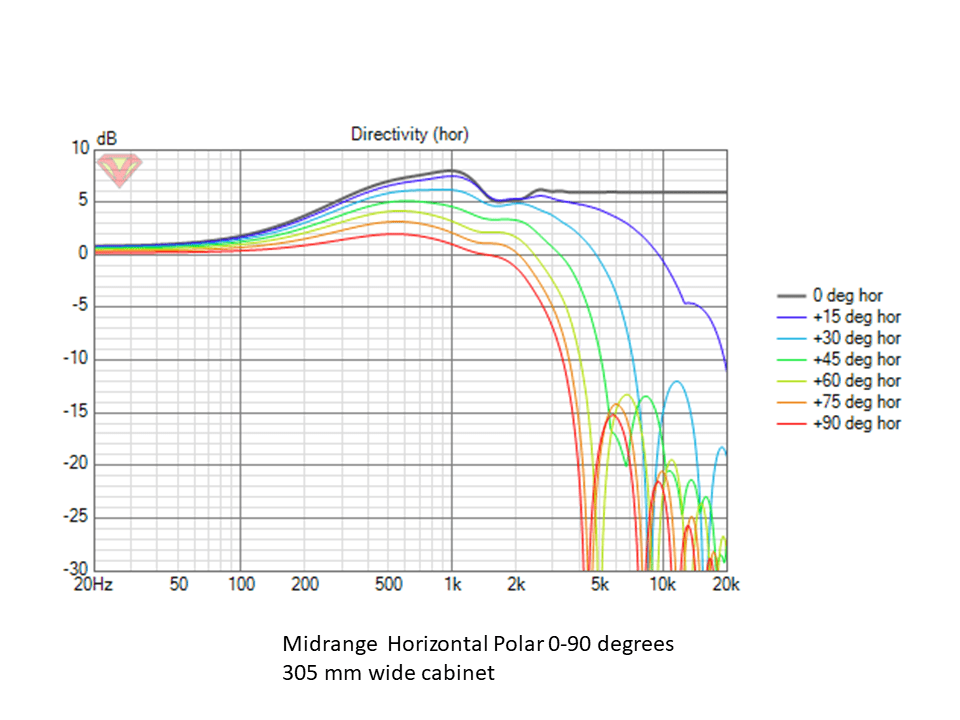

The Scott Hinson does look interesting but it is a bit wider than I want to make it, if I made it say 10.5 inches wide would that be a problem with the xover and also it will be very close to the back wall.
I see the crossover is around 400hz from Woofer to Mid on the Scott Hinson design so I woild think that changing the cabinet width from 304mm to say 260mm is not a big deal.

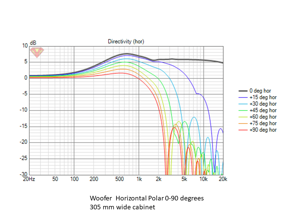

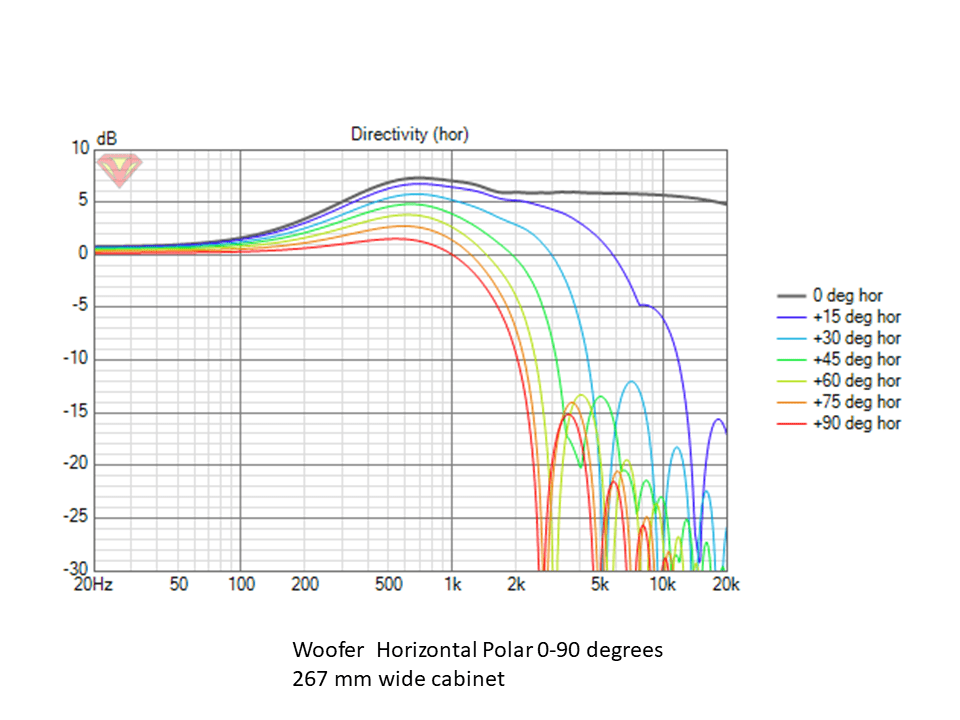

I slapped together a quick simulation of baffle diffraction to see what the differences would be between the original 305 mm wide cabinet and a 267mm wide cabinet. I simulated the woofer and the midrange in their proper vertical orientation, the only thing that changes is the width.
It is not a big difference, but there is some difference. The BSC features of the original crossover will probably be acceptable. I suspect that a 267mm wide version of this speaker would sound similar to the original... subtly different, but similar.
Be aware that the whole cabinet will have to be redesigned to maintain the same internal volume as the original, and the midrange sub-enclosure should not change shape.
