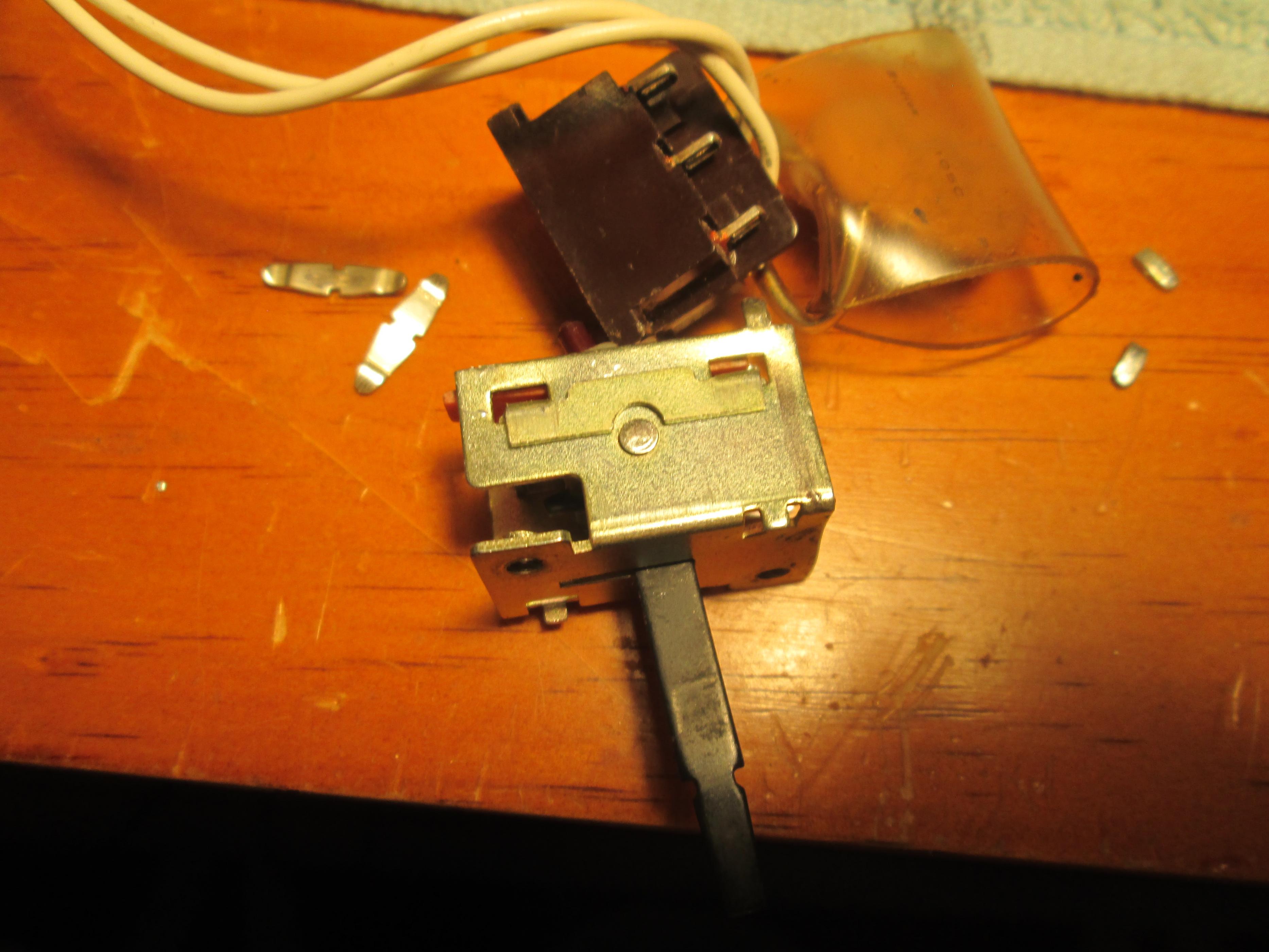

My Sansui power switch was damaged in the post beyond repair, it is for an AU-5500 but I suppose any Sansui toggle type power switch will fit? Any ideas where I can get one? I've checked fleabay, Oatridge Parts, Sansui Parts, etc... 🙂
It is similar to my Pioneer SA-606 amp toggle switch. Perhaps it's the same switch. If You can't find one for mains Voltage. Use a relay for switching the transformer.
Heres a photo, you can see the lugs have broken off because at first, I put it back together upside down, it was working great but Off was On and Visa Versa. So when I tried to reverse it the lugs had had enough bending and two of them broke off. If the Pioneer SA-606 toggle switch is the same that would give me more scope for finding a replacement!

Just thinking here, maybe you can solder on a narrow piece of brass stock on either side of the switch to bend over and hold the bottom on, at this point you really can't make it any worse at this point, certainly worth a try.

I thought of doing something like that but the plastic part that holds the toggle is split down the middle and shattered on one end, I tried to fix it with epoxy resin but it has broken again and one of the tiny springs is crushed out of shape. I'm thinking of getting a Bluetooth power switch for the time being so I can use the amplifier. 😀
I found out what the postage rate for this switch is from New York to Perth Western Australia? It is near $AU200, I kid you not. It's because of this new Global shipping service in the USA plus PayPal and eBay taking their cut as well. If you go to a US post office it will cost $US75 which works out to near $AU130. I've been looking for this Sansui P/N-1170330 switch for a few years now, Marantz used them and maybe Pioneer and some others used them too? But so far most have been for sale in the US. I'm wondering if anyone knows how to check if Japan has any new old stock or used ones? If I can't get a switch at a reasonable cost soon I'm going to have to drill out my faceplate to fit a bodgie switch? I really don't want to do that because the amplifier is fully rebuilt and a switch is all it needs to work.
Find a normal push to on switch and use it.

Use a properly rated reset type circuit breaker, it is commonly used in domestic appliances, inside or outside the unit, as you like.
Additional safety.
And yes, you can jumper ii, and fix the thing back as a dummy, so it does not look damaged.

Using a push to on switch is easy to say but impractical to do, that was one of the first things I thought of but there is only an eighth of an inch slit for the lever to go up and down on the faceplate so the faceplate would have to be drilled out. I had a quick look for a Japanese switch manufacturer catalogue but nothing showed upFind a normal push to on switch and use it.

How big is the slit, length x width?
1/8" is enough for the tip of the makeshift pushbutton for the breaker used in 450 watt domestic mixers, enough for you...

I use a snubberred power strip, and leave the switches on, no wear then... Yay! I found a New Old Stock switch from Greece that was used in vintage Aiwa products, it looks identical except for the tabs there is only three instead of six. I cant see Alps changing the tooling to make the metal parts different? He has more of these if anyone needs one? Thanks for all the replies fellas, they are much appreciated. https://www.ebay.com.au/itm/324754801516
