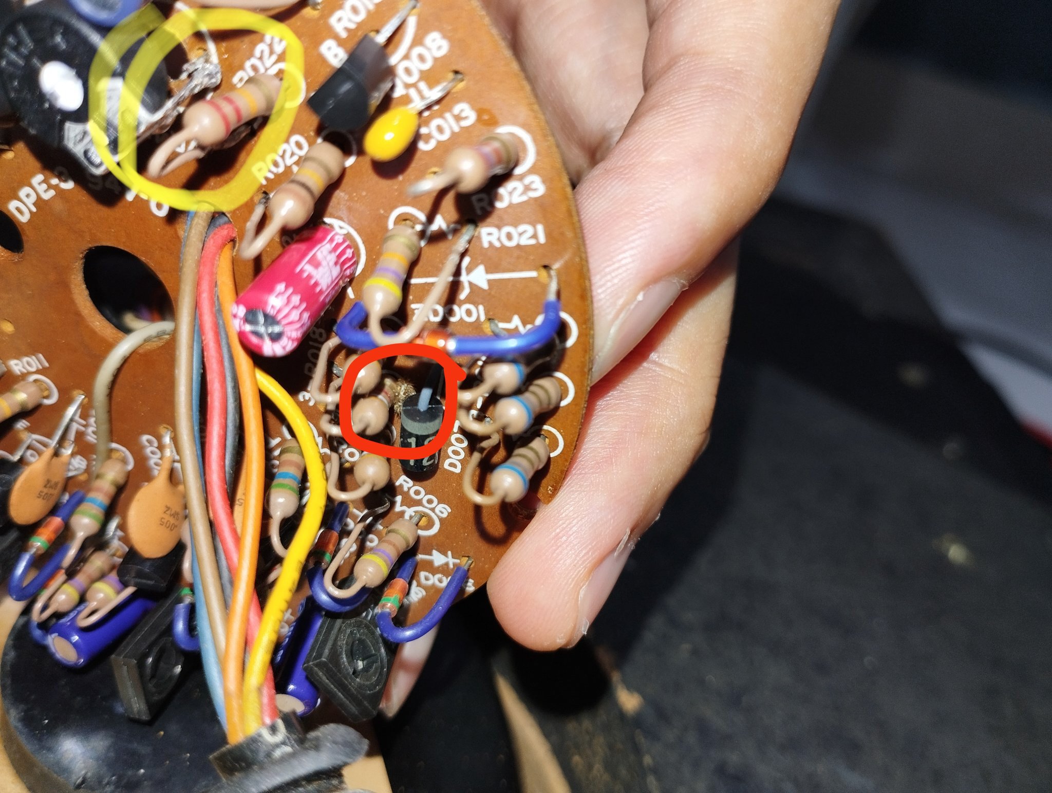

Oh yes, keep going, you will fix it !! Great News is, that you have two different speeds. Is there nothing Happens if you turn the resistors on the Motorboard? Are the resistors correct?
VR33 = 4.7 k
VR45 = 10 k
VR33 = 4.7 k
VR45 = 10 k
Thanks Tim! Yes, the resistors are of the correct value. When I turn the 33 rpm resistor, I am getting 60 - 70 rpm, the 45 rpm resistor 70-80 rpm.
What i can see is, the soldering of the adjustable resistor Looks Not so nice as it should 😉.
