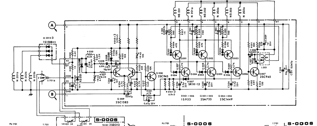

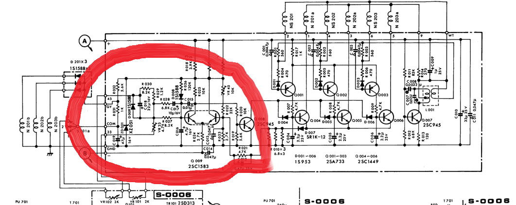

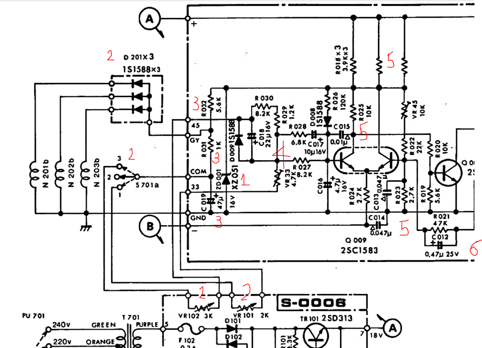

Another tip...R032 (that on the left) reads ok? it feeds the COM node of the adjustment.
I didn't lift a leg, but in circuit it reads as in service manual.Another tip...R032 (that on the left) reads ok? it feeds the COM node of the adjustment.
Thanks for all your suggestions guys, over the week I am going to lift all the resistors to confirm.
@restorer-john I have already replaced this previously (with a 50V rating). Just now, I have confirmed that it is continuous on the negative side with the WHT wire, and the positive side is continuous with C10.

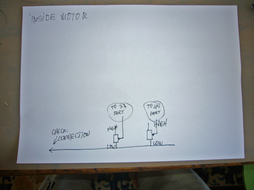

Actually, I have trouble imagining how the switch works? It has 2 white wires (I assume from the power supply) but it doesn't seem to be directly connected to the 3-way selector. Are they supposed to be decoupled or am I not seeing a connection between them?
Hi, the Switches are Just mechanicaly connected to the 3 way selector!
I Just finished the repairing of my 525. Main Problem was the yellow powerswitch. In closed State it hat a Résistance of 800 Ohms.
Resultate Output voltage 17 and -4,7 Volts.
I removed the switch and shorten the two white wires for testing.
