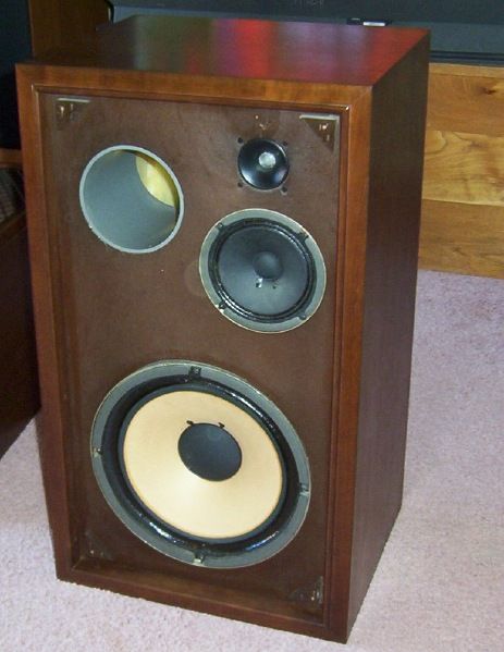

In audio terms, those are ancient history, good luck with finding replacements. If the Voice coils & suspensions are OK, you may be able to get them re-coned, but I don't know at what cost... technology has moved on a lot since the 60s....you may get better bang for buck elsewhere. Sometimes you just gotta know when to fold 'em... If it was me & the drivers were knackered, I'd re-use the cabs though, they look damn good with that fancy grill
Now you've got me thinking about it,.. that cab is ~ 65L internal volume???,
perhaps this is a possibility: keep the piezos, replace the 5" with Peerless 830656, & the 10" with Peerless 830688. Then all that would be required would be to come up with a suitable crossover....

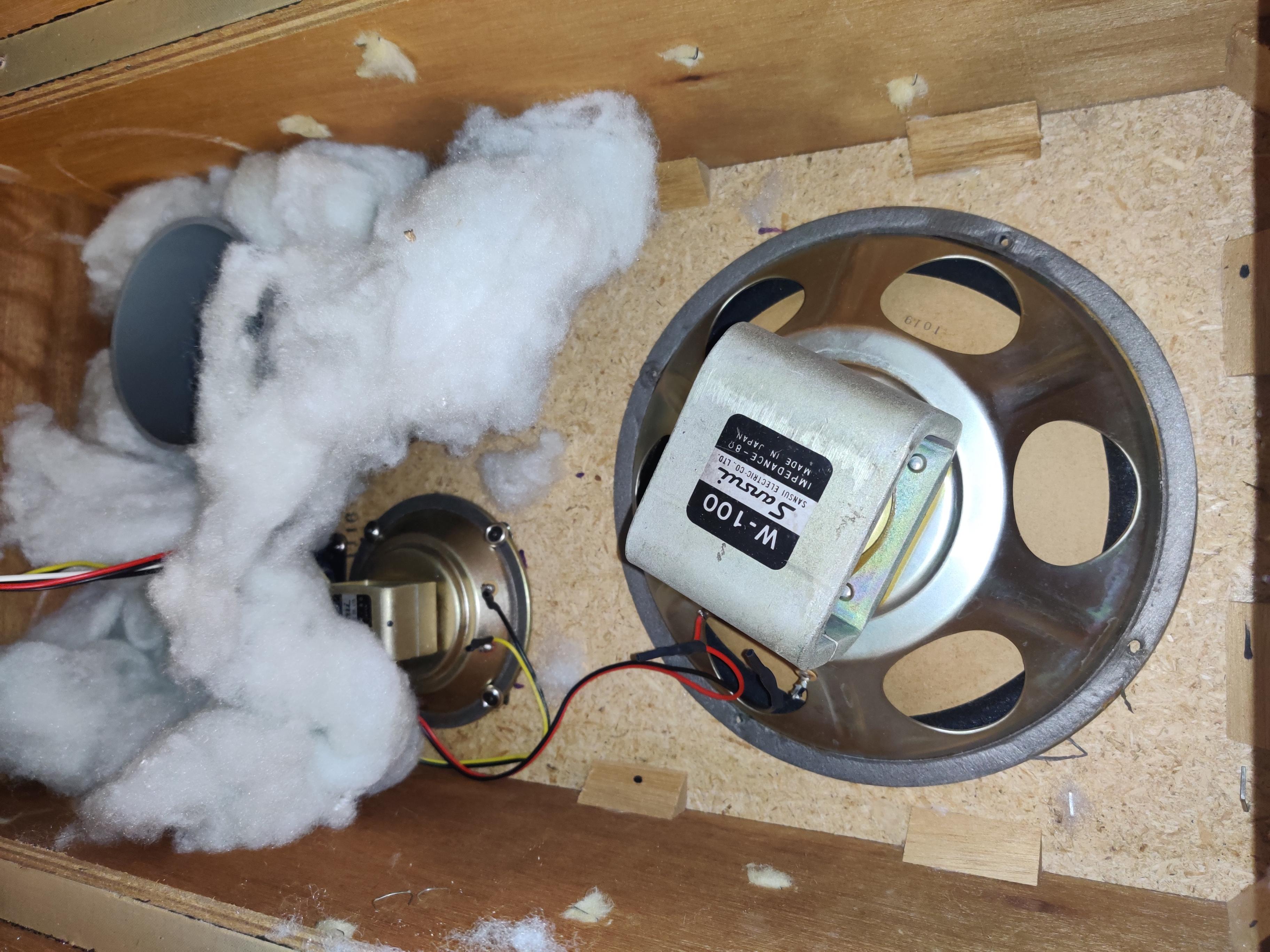

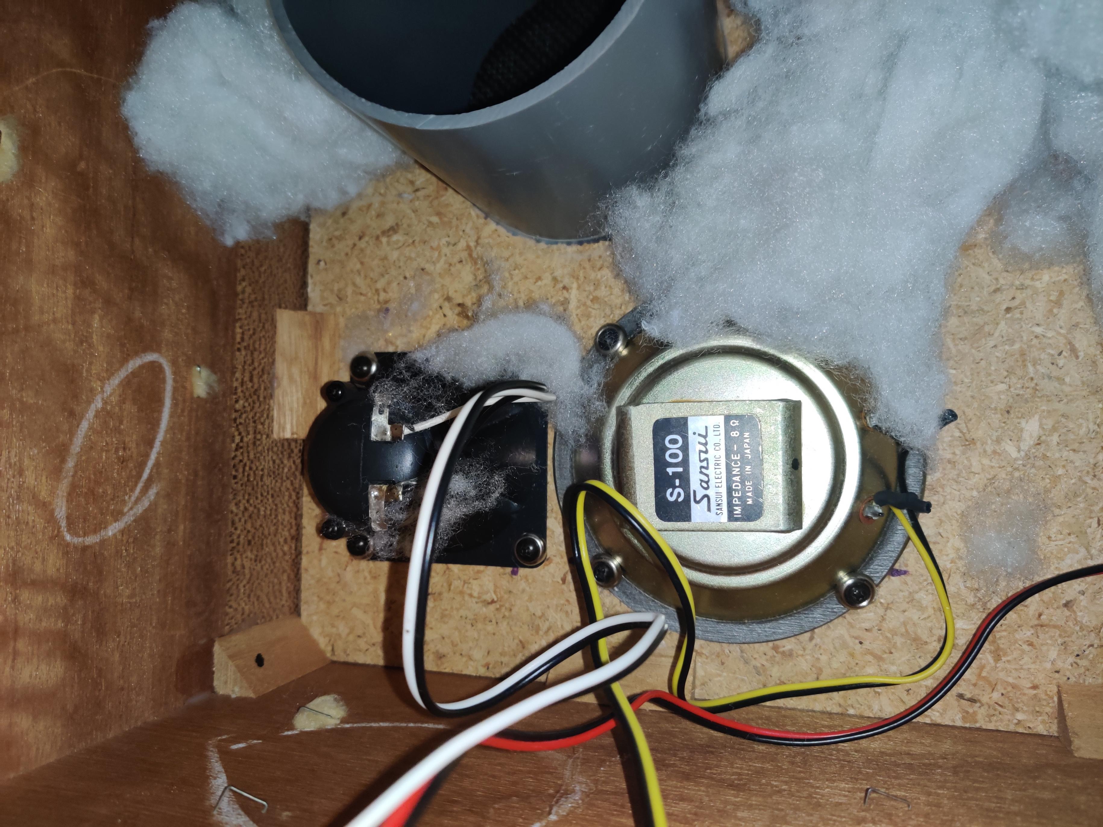

Have Dave. The numbers on the midrange and woofers are SP-100 and W-100. The midrange is 5 inch sealed and the 10 inch woofers are open basket. I uploaded the two pictures I have. They are both
8 ohms. I just found out sansui used a Coral tweeters I'm thier ps series. I can't found anything but the frequency crossed over on the tweeter and the ohms and wattage. I am looking for the DB so if I can't find a pair I can match it up closest to the original tweeters. Sorry for the side line post about the tweeters Dave. I hope the pictures help? Cheers. Jeff

woofers are W-100.

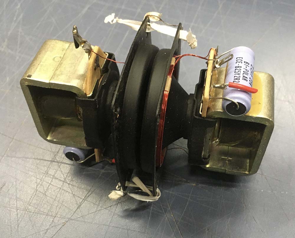

I finally got a chance to look. The woofers i have are 4 x W50.
Here is a pic of the tweeter:
attachment.php

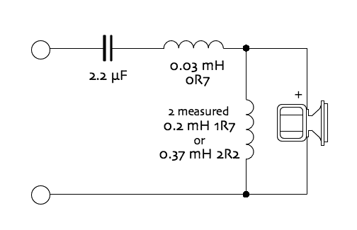

I realized when i looked at them that the entire XO is mounted on the tweeter, so it could well be that your piezo is XO-less. They can be used like that, but they get really rough and ugly sounding.
I’d be happy to send this pair your way for cost of shipping.
Small packet post is cheap but, surface particularily (but slow at teh best times).
If you are interested i can weigh the tweeters & figure out what that would be.
