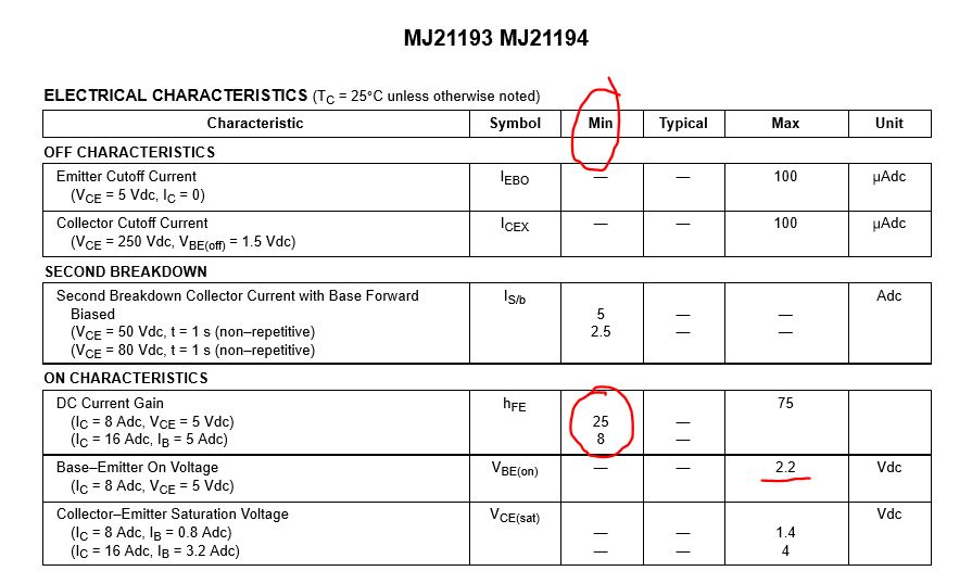

All evidence seems to point to the MJ21193/94 parts being incapable of either sufficient gain or current delivery. I'd say the latter, because with a 250 ohm load, it has no trouble swinging 42 or more volts.

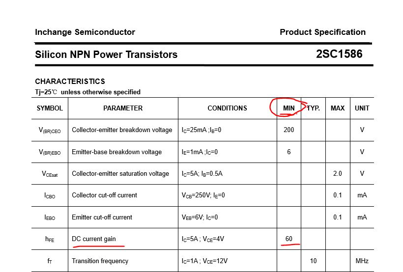

I've just pulled a data sheet on the original output devices and they do seem to be unusually high gain devices... and yet its hard to believe they could be the culprit. The maximum base turn on volts is also rather high although that is specified at very high collector current. Odd !
It might be worth comparing a similar test on the other channel.
I would seem that perhaps I should have selected the output devices for maximum hfe. I only had 8 pieces left in stock, three matched of each type though.
Without actually testing the amp its hard to say. I'm struggling to believe that low hfe would cause this, at least not when you have a driver and pre-driver in front.
