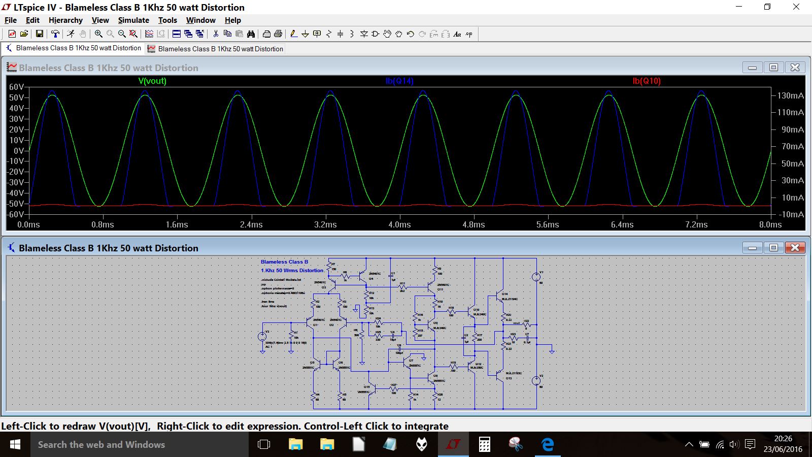

Although simulation doesn't always reflect real life I put the supply voltage and 34 vrms output into a standard class ab design using the MJL21194 devices and it easily works, even with just a single MJE340 driver and output. Base current of the outputs was around 150ma peak.
Have to leave it for today but this gives an idea of currents involved. Output is 37vrms into 8 ohms. You can see the base current of the output and driver (driver is around 2ma)
So your output triple should walk this. Something seems amiss in the devices, or their connection or connectivity.

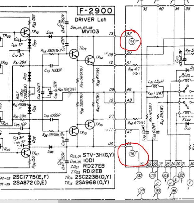

Next step: check the rails at the collector junctions of the output.
Good point about the relays. I'll check voltage at the Zobel network and compare with the output terminals.

Results from testing rail voltages at the collector flanges of output transistors.. only sags to 68 volts at clipping.
Only measured a half a volt difference between Zobel network and output terminals.
Then I had a thought: I hadn't checked the base resistors on the output stage--only the emitter resistors. I was expected to find one or more open base resistors. Alas, all of them are right at their marked values. So were the 100 ohm resistors connected elsewhere on this stage. So it's back to square one.

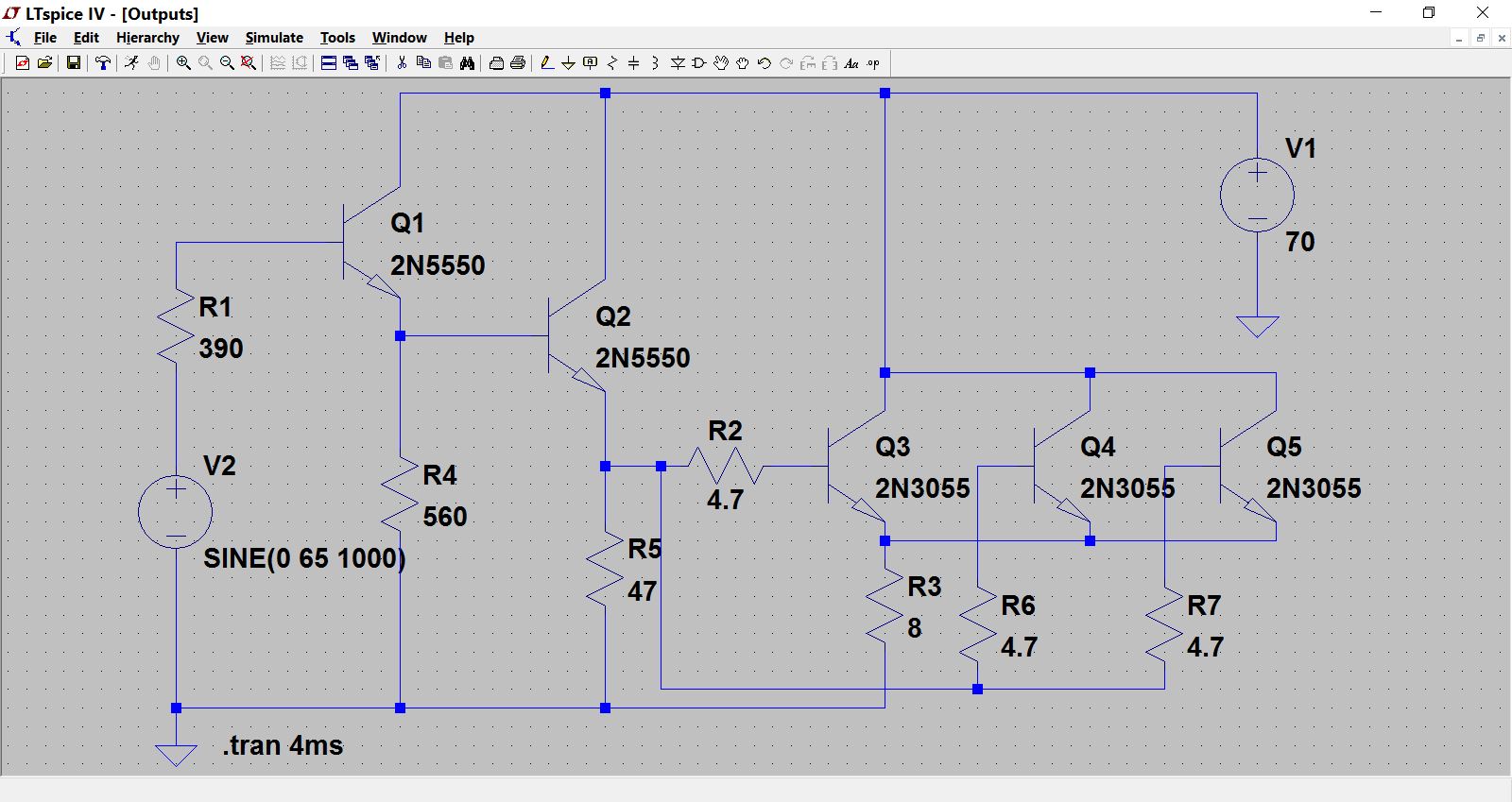

Punch line first... I think its the MJE340/350 you are using as pre-drivers...
R39 and R40 are to aid fast turn off of the outputs. Altering the value of these isn't the answer.
The 4.7 ohms are a safeguard, they aid stability, they aid current sharing and they isolate each junction from the next. And they actually function as 'fuses' in the event of a catastrophic failure.
That must mean the current drive is enormous.

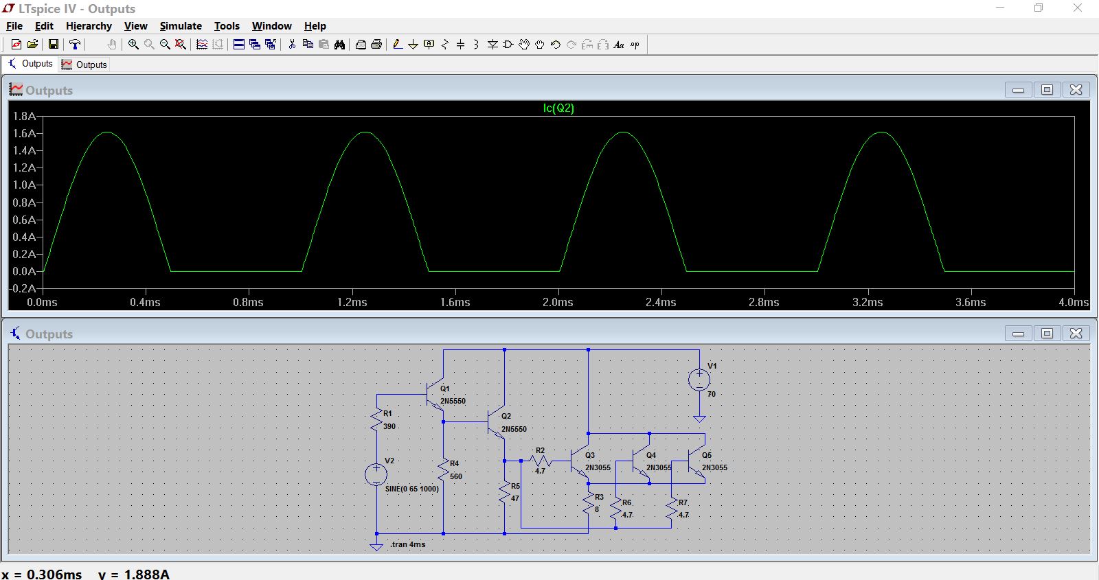

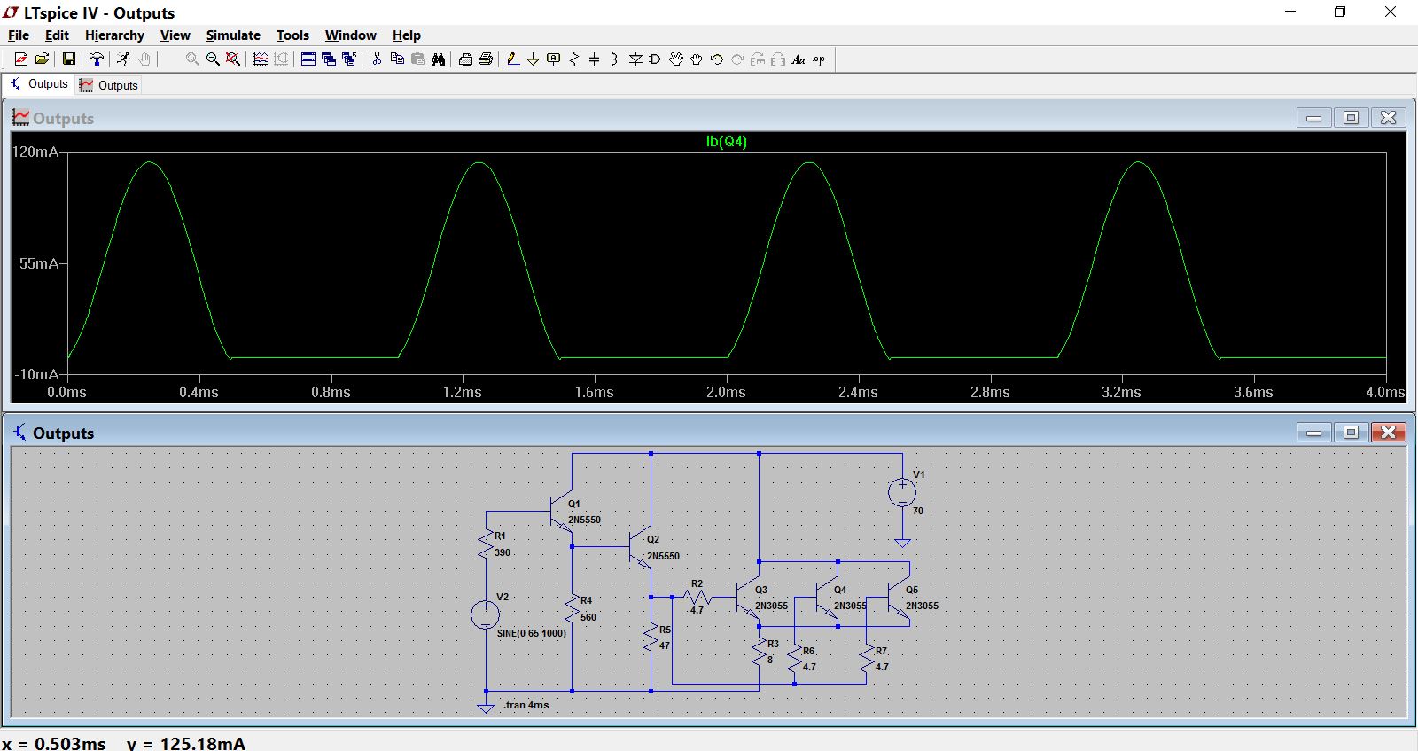

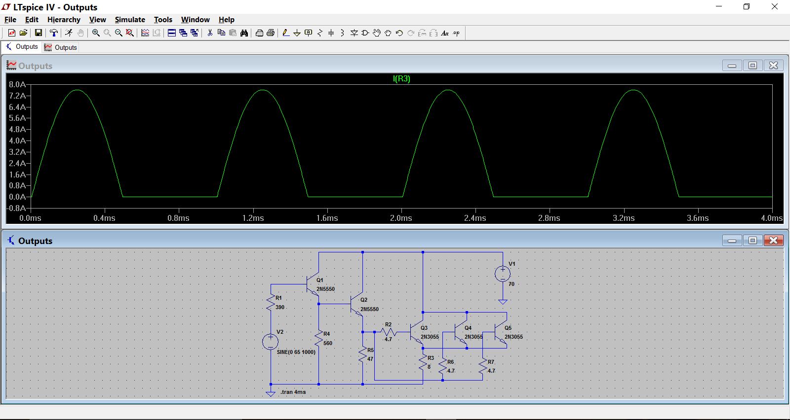

You need to deliver around 8 amps peak into the 8 ohm load for your aimed for output level. If it used a single output pair of gain of 40 then you would need to deliver around 200ma peak into the base. Multiple output pairs reduce that in proportion, so three pairs would see around 70ma in each base.
The MJ21194/3 are guaranteed to have a forward gain of 25 @ 8 amps collector current. Assuming one pair, that's 320ma drive needed. You have three pairs so lets say 100ma per pair.
wg_ski's suggestion of looking at the bases of TR12 and 13 is a good idea. Compare the voltage here with that at the other end of the two 390 ohm base feeds. There should be very little difference because the current in the 390 ohms should be minimal.

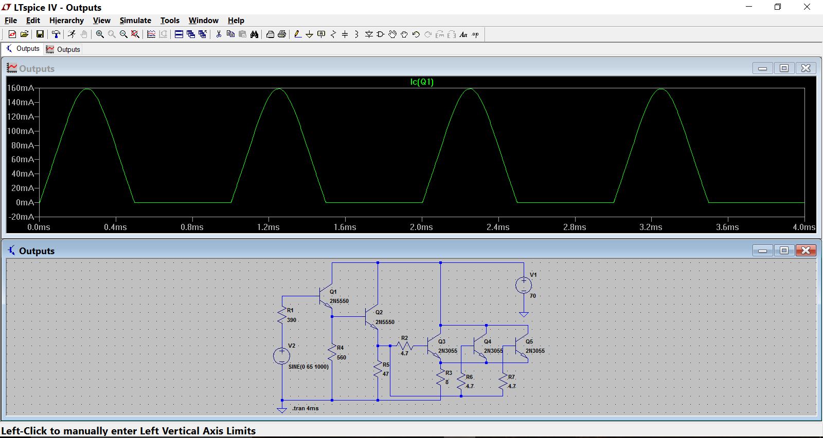

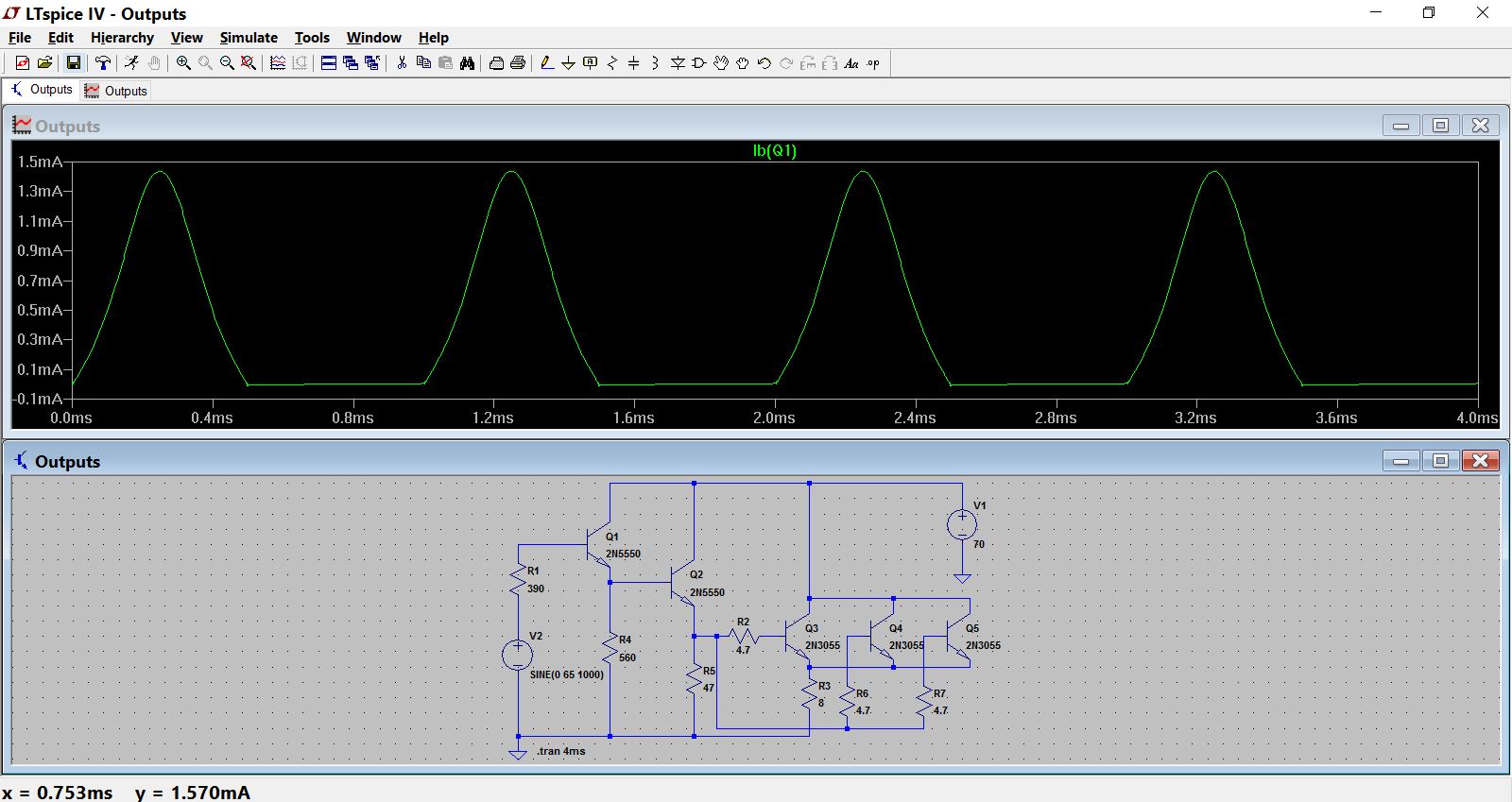

I've thrown this together to give you an idea of the currents involved. It shows one half of the output stage. Then we have the output current in the 8 ohm load. Next is the base current for the outputs (and these are lower gain than yours). Now we have the driver collector current and this has to supply the outputs and the 47 ohm. That's pretty substantial (and they should be getting hot). Next to the last and we have the collector current of the pre-driver. Again this has to supply the 560 ohm. Finally we have the base current of the pre-driver.
The 2N5550's are high gain devices. So when I said it was a walk in the park for the triple arrangement here... well I might have been over simplifying things. The currents in the pre-driver are higher than I thought. The MJE340/350 are very variable in 'quality' in my experience. Some of the best I have seen are from manufacturer CDIL.
