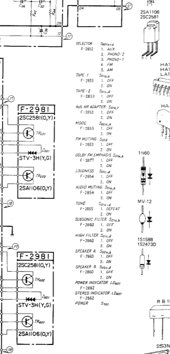

I wonder if he has the 2SA1106 and 2SC2581. Those are the OEM for my Sansui G7500 and the ones I'm running now took almost six months to find, used, from a guy "who knew a guy" who was parting one of those receivers.
It'd be nice to have a spare set just in case.
@GESMAN The widely available TO3 "replacements" for my G7500 are much slower and sound different. The sound of my G7500 is indeed more midrange forward. It has a "lighter" sound with a good extended treble and somewhat lighter bass, but still quite deep. It feels "fast on its feet".
That's the best way I can describe, it's the house sound for all of those High Slew Rate amps. I assume your amp is similar in that respect? My receiver was built around '79..
There is no sense in rebuilding one of these Sansui amps unless you have to OEM transistors, that was the whole thing about the sound of the amp. Otherwise, go get a Kenwood or Pioneer.
This is a snapshot of the schematic showing the driver board and notations for the G7500. .
