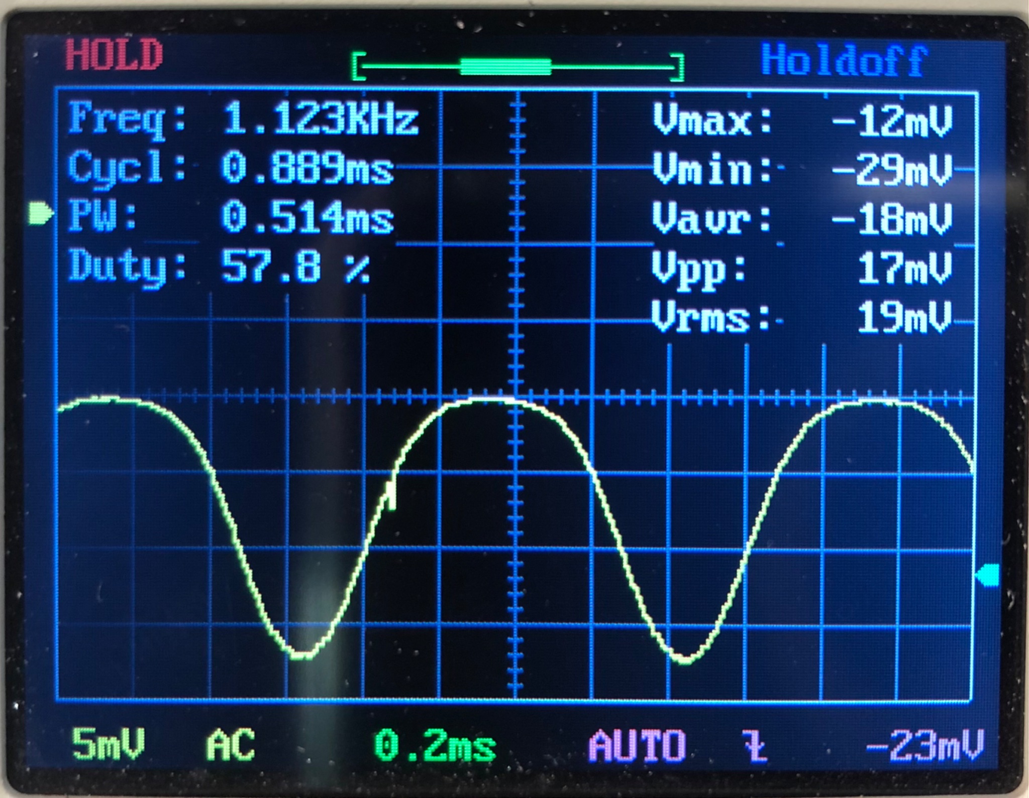

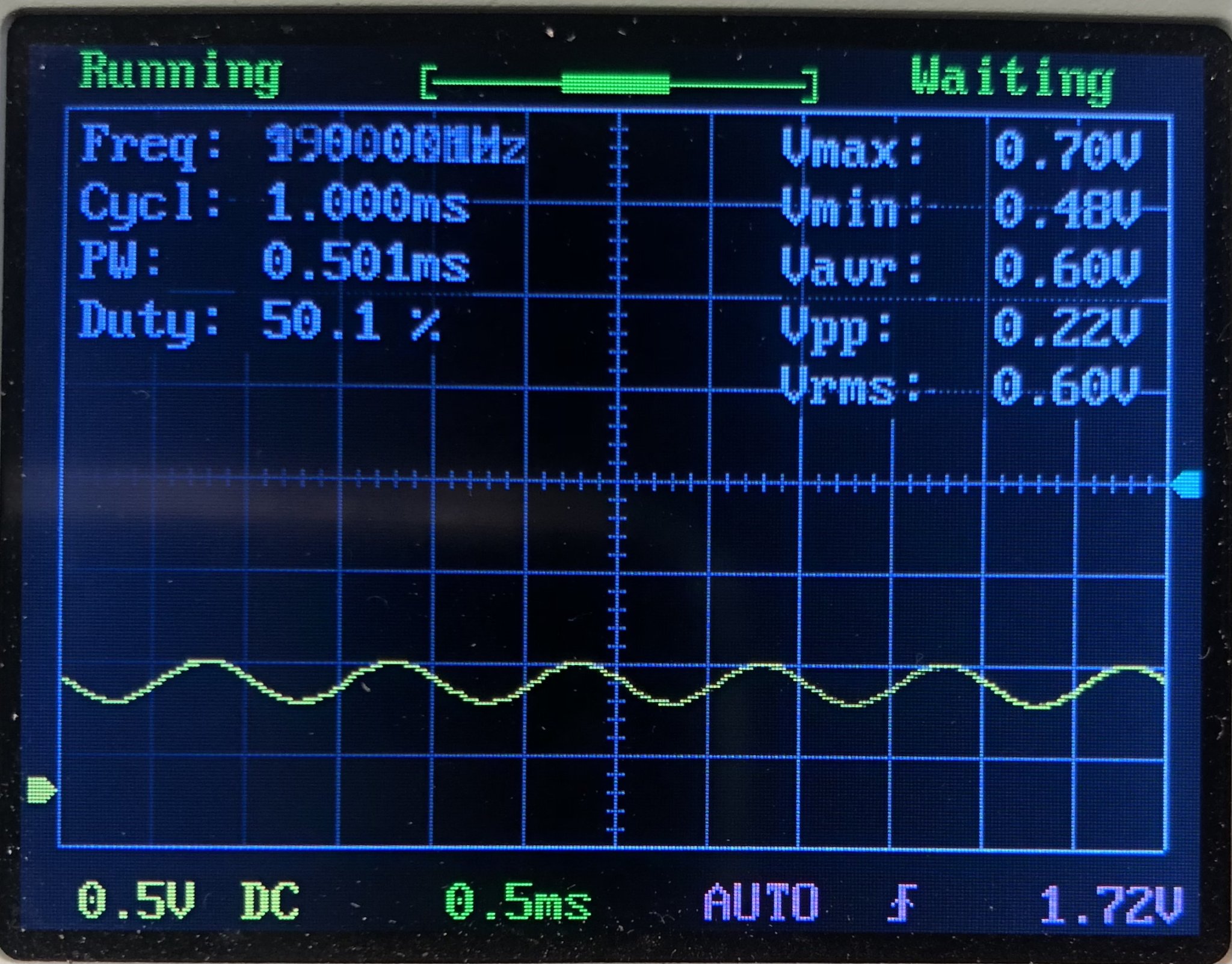

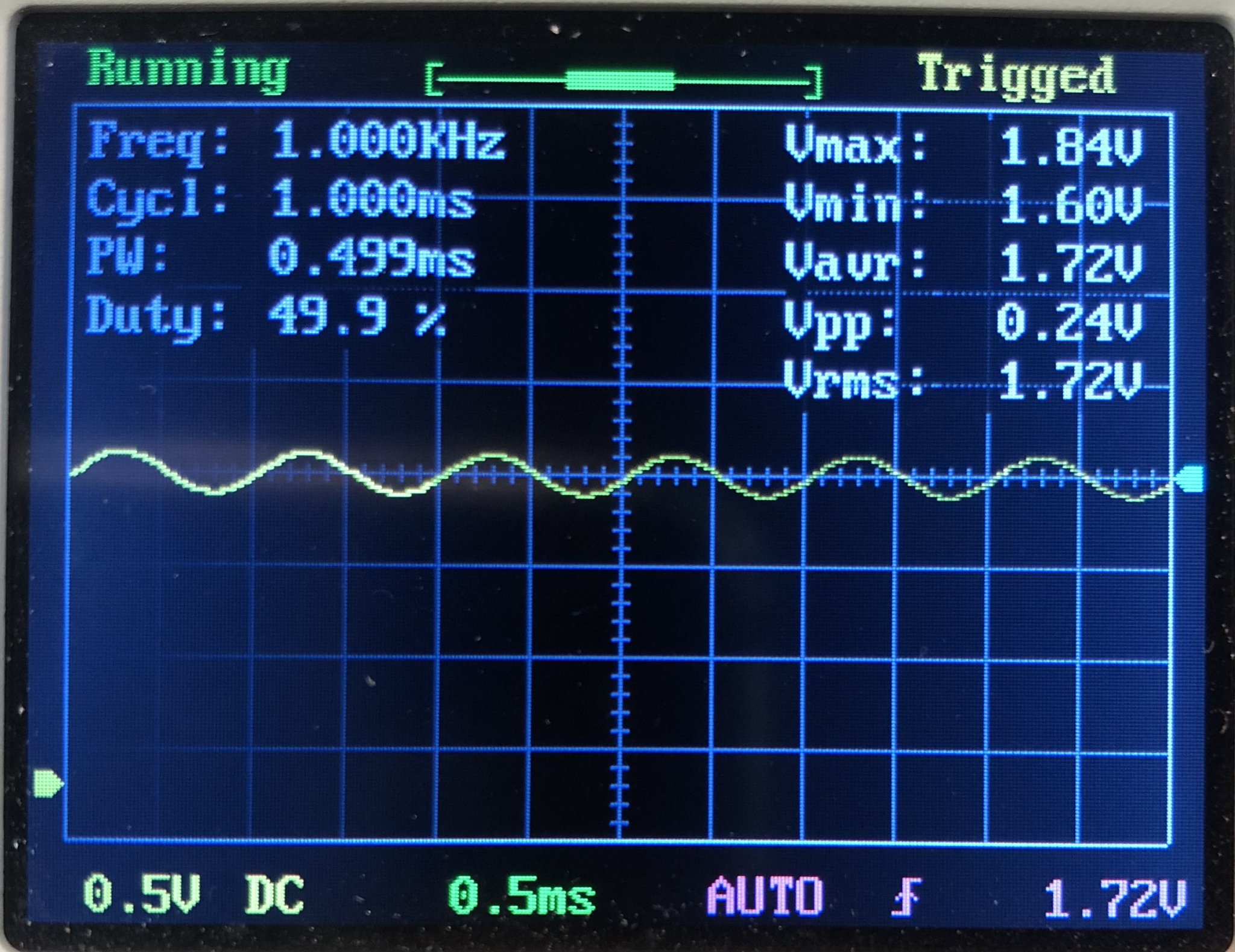

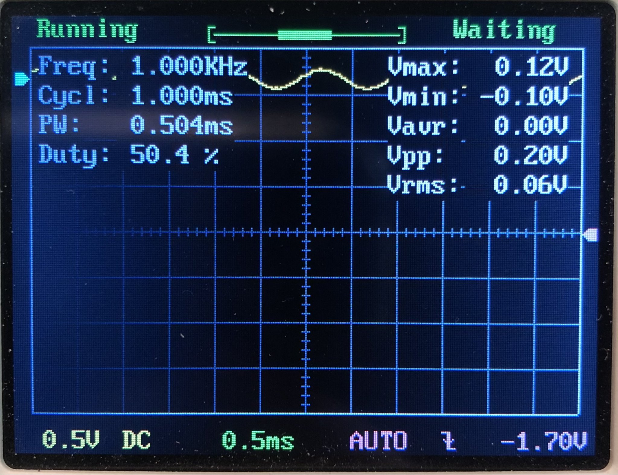

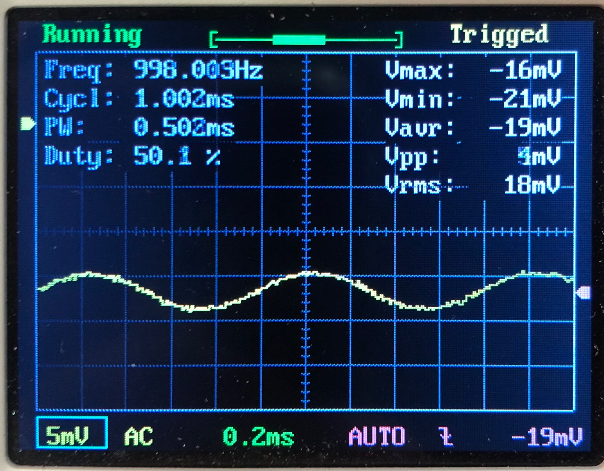

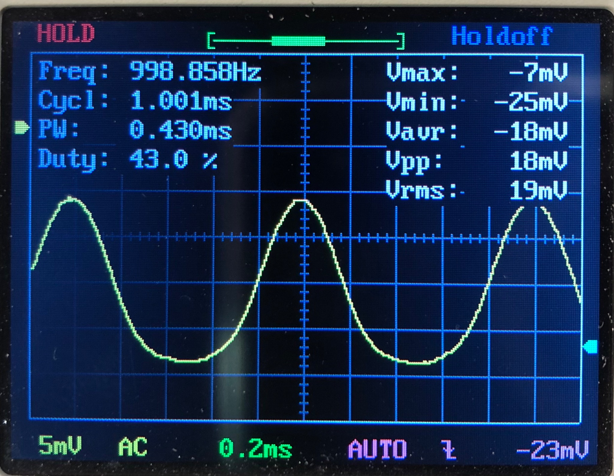

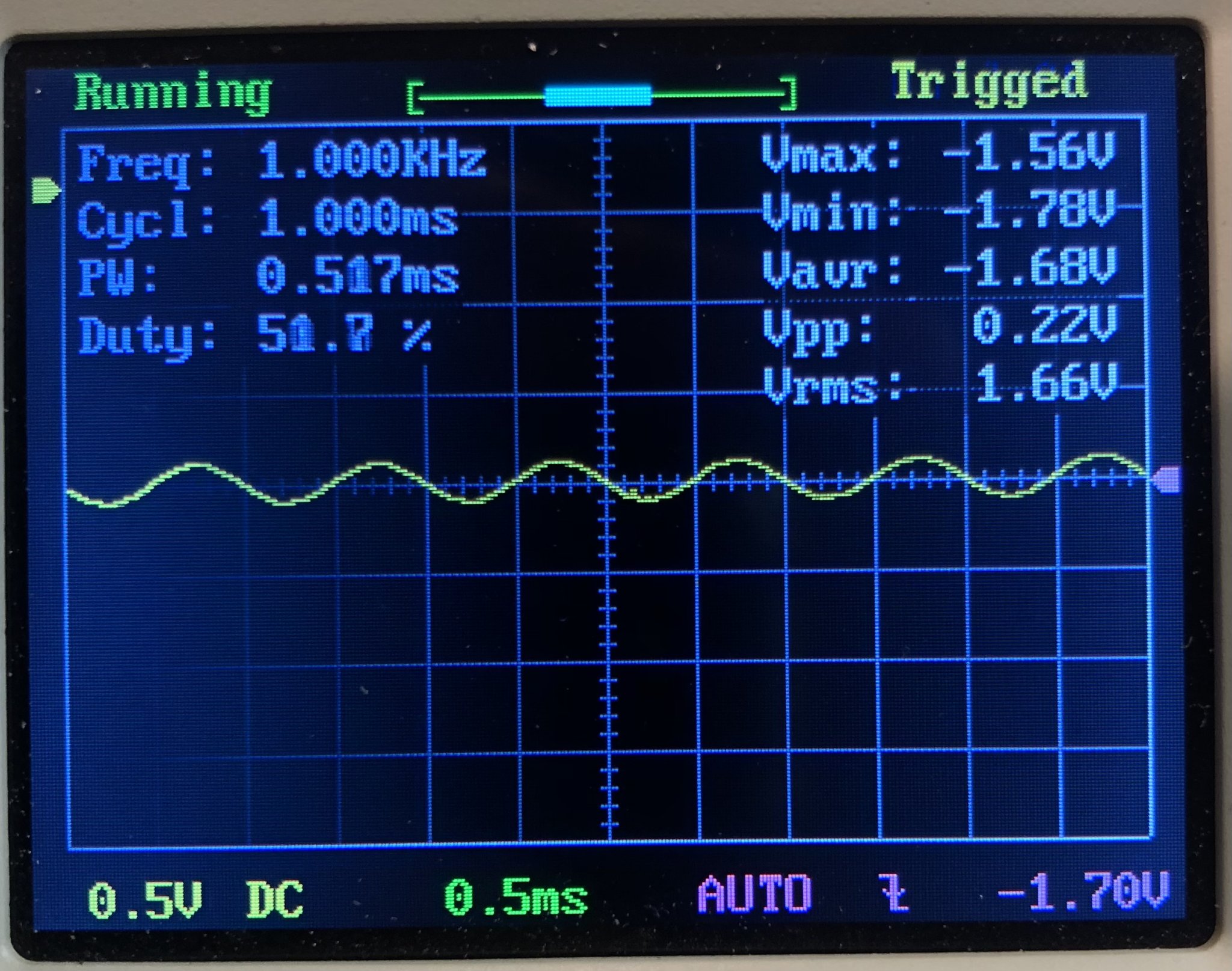

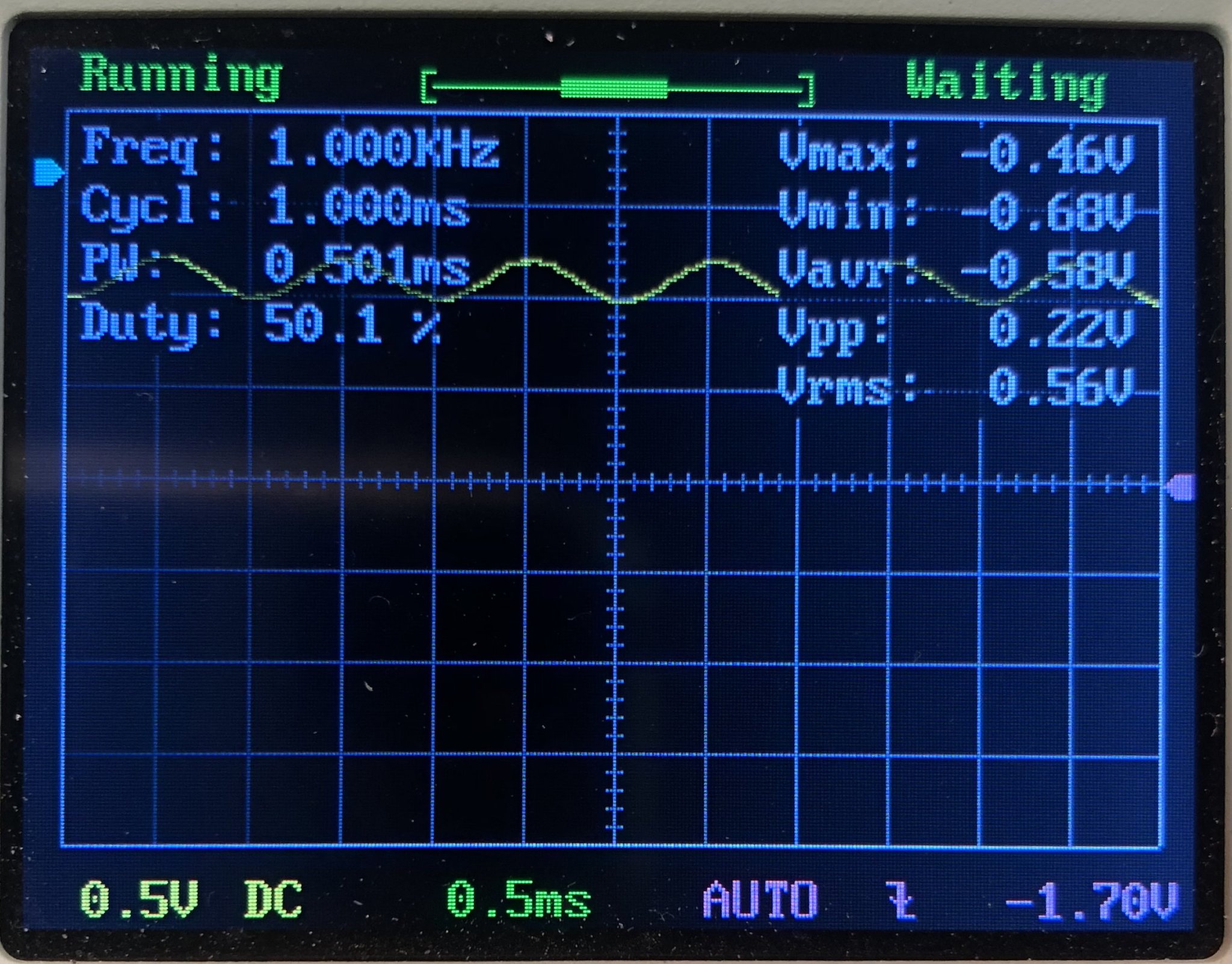

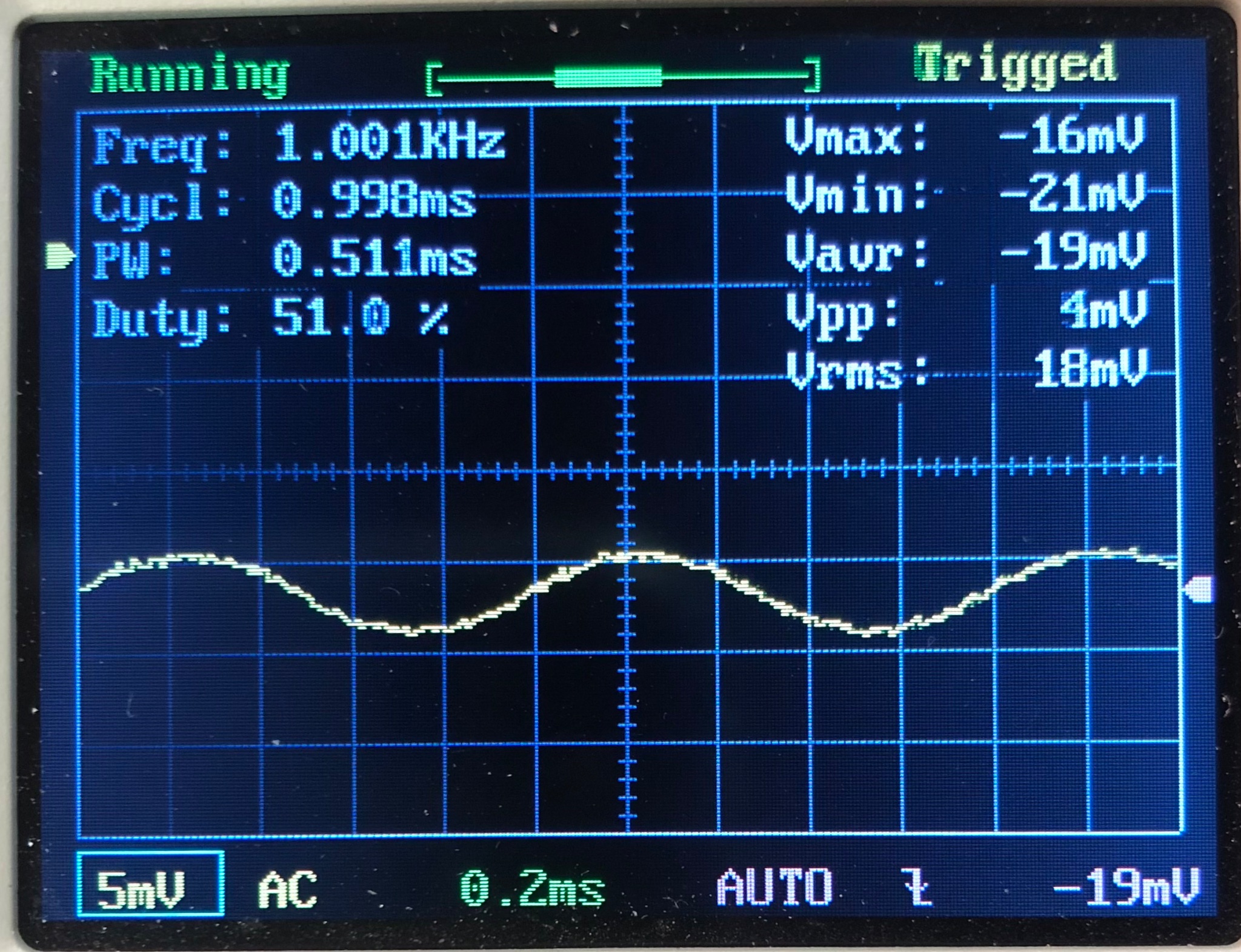

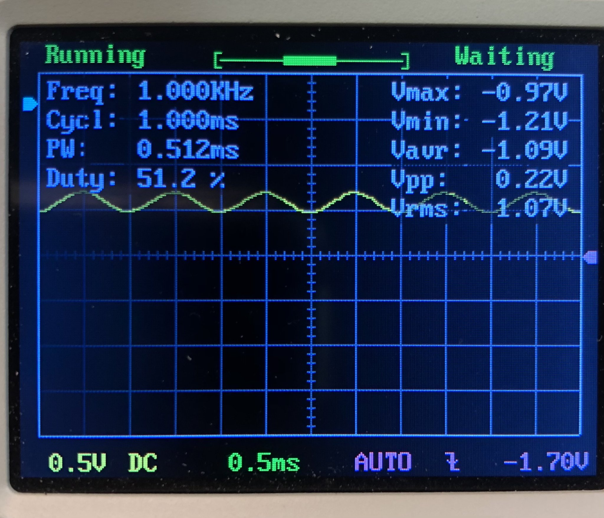

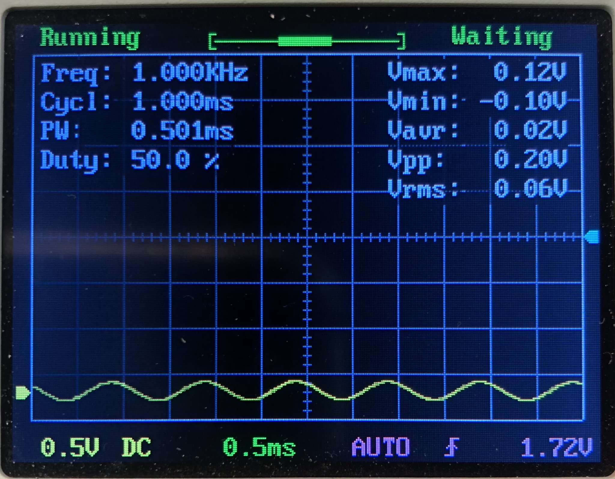

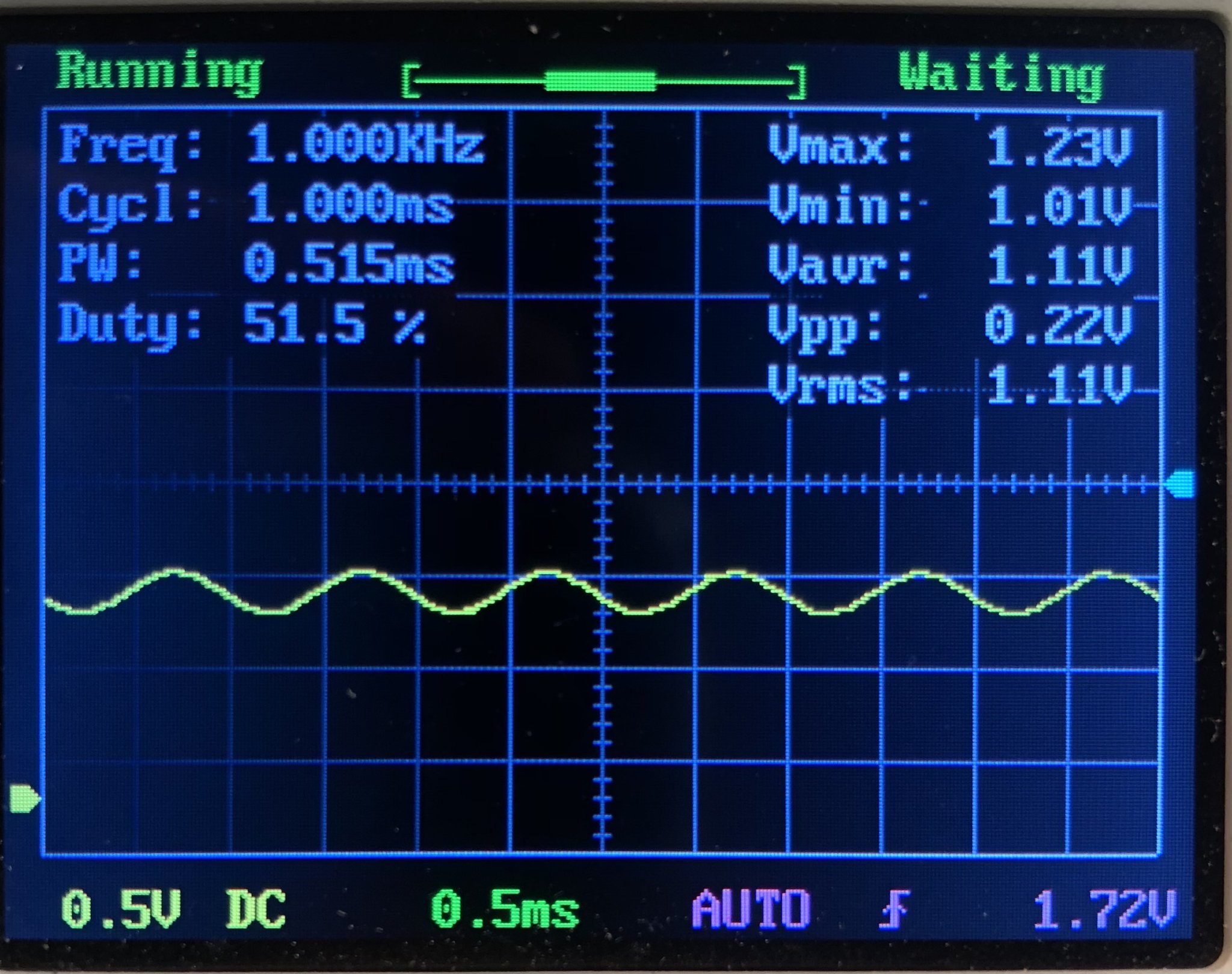

but the signal manages to reach the base of Q17-Q18, as you can see in post #21, if I measure the voltage drop across R43 and R44 I get a voltage, as well as across the resistors R45 and R46;I can't fathom how DC voltages can drop in reasonable fashion through the cascade of transistors (eg. Q13,Q15,Q17), and fail to simultaneously transfer the sine wave drive through each b-e junction.
This is what I measured at the bases of Q13, Q15, Q17 and at the emitter of Q17, similarly for Q14, Q16 and Q18I suggest using your scope to step through each stage, with scope set for DC coupling. Drive amp input with sine wave to deliver about 0.2V pk-pk at base of Q13. Your scope should show dropping DC voltage at each junction (base, then emitter) as you step in order from Q13, Q15, Q17 followed by emitter, then base of Q18, Q16, Q14. The sine wave should follow supper-imposed on the DC bias, with only minor drops in AC amplitu
Q14 Vb
Q16 Vb
Q18 Vb
Q18 Ve

yes, I measured 0.5 OhmRiffing on this theme, measuring from the emitter of Q17 at the package body to board edge terminal 13 should show a few tenths ohm, i.e. R43 + winding resistance of transformer L1; similar for emitter of Q18.
These waveforms all look good to me, and are reasonably consistent with the data you posted in #13. I assume if you scoped emitters of Q19 and Q20, you'd find similar waveforms.
I see you've confirmed reasonable resistance, on both Q17 and Q18? Have you traced the sine wave from the main output toward the speaker binding posts? Where does the signal fail on the path toward the dummy load? Does output change amplitude if you remove the load and test open circuit? The resistance seems reasonable, but be suspicious of the transformer. Let us know what you observe.

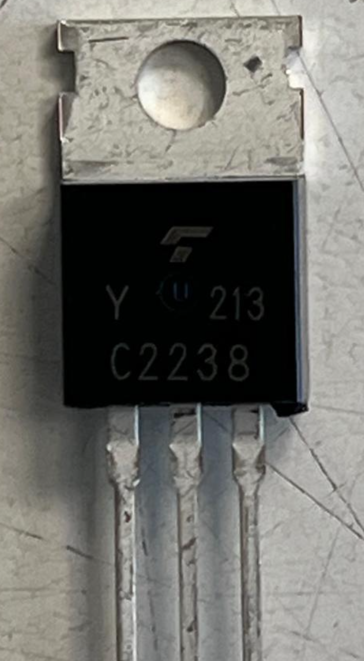

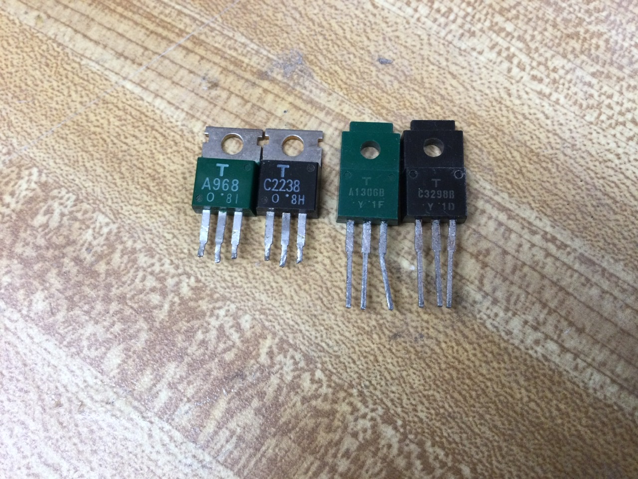

Toshiba is no longer making those, so be careful what you get and where. They were the among the best drivers ever made. Fakes are everywhere, and ISC in general isn’t as good as original types. There are documented examples of outright failures in Sanken clones. KEC may be making them now and I’d give them a shot before trying anything of new manufacture. If you find NOS, make sure they look like THESE, including the green cased PNPs. The ones to the right are the type that replaced them. Same thing in a full molded package. Also out of production, but there is more NOS stock out there in these types.
DO NOT buy Toshiba labeled product in the lead-free finish! They stopped making these before they made the switch.
And no, the C4793/A1837 pair is not as rugged.

That’s the new logo, but that is the lead-free finish I was telling you about. FAKE. Toshiba was still using the lead/tin dipped solder plated legs when they quit making those types. In the early 2000’s. That package was made recently, so it can’t be a real Toshiba.
If those “Toshiba C2238’s” don’t blow up, they may be MJE15032 clones. Which would hold up fine - they are a much BIGGER part. Overall amplifier performance may or may not be as good. Those MJEs (from ON) are a solution for replacing C2238 if you’re not worried about ultimate performance and just need something rugged. Like when rebuilding a QSC USA1310.
