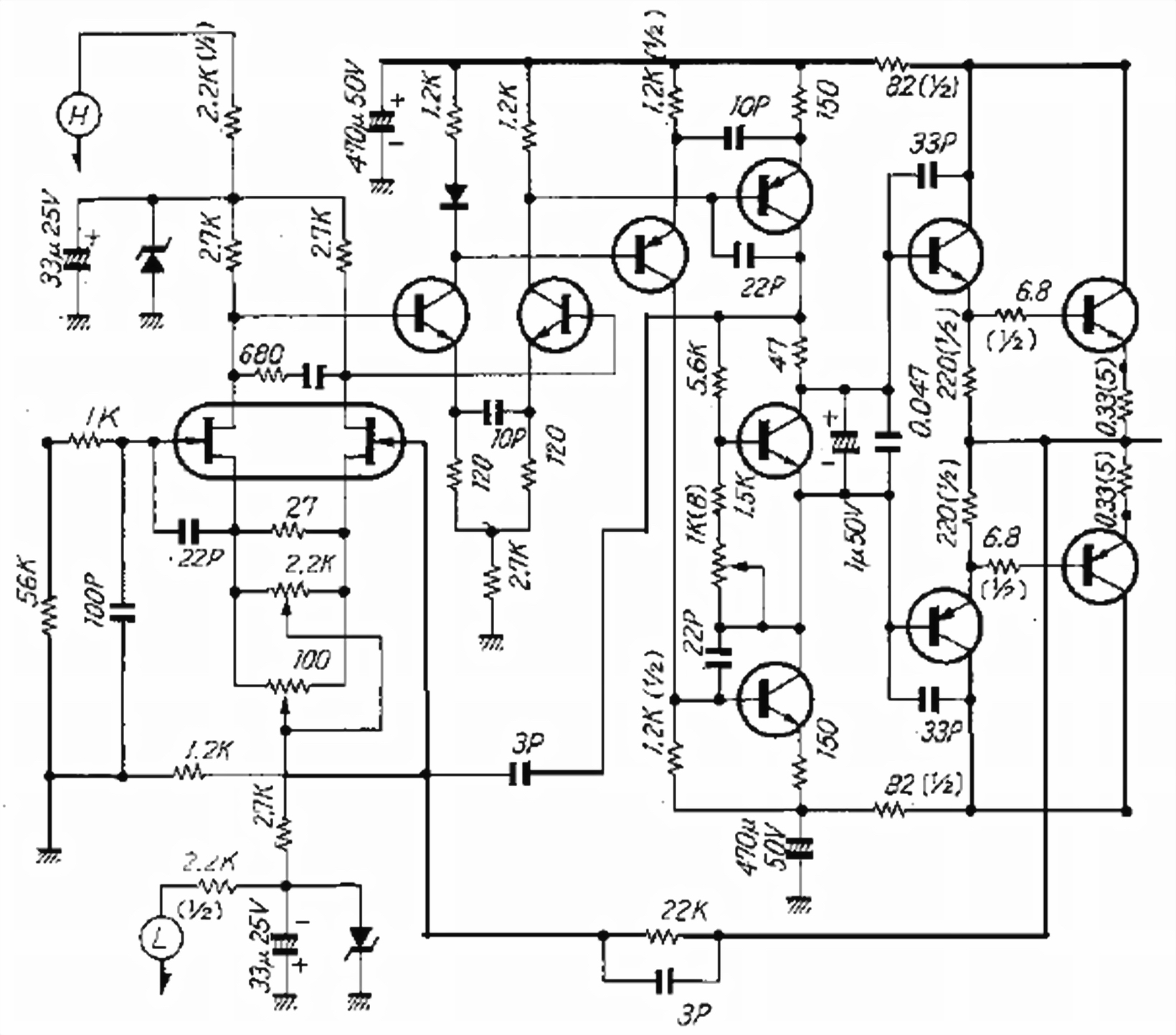

Great news this amp has legs in it with possible upgrades in time too. Is there a recommended set of upgrades anyone can point me towards? I won't be doing it myself (total no-no!) but will get someone to do the work at a later date. Too busy just enjoying this great piece of hi-fi history at the moment.
the schematic is very good... i think it is a great performer.

I have seen the 117 schematic and it seems very similar to that of the 317 I have in house
I hope to find some free time to update my 317
My idea is to make a super 317
New caps, new volume pot, bypassing balance and tone controls directly, new power TO3 bjts at the output (some 150W things)
If i could get some more drive with this mod it could stay in my rig for long long time ,,, I hope

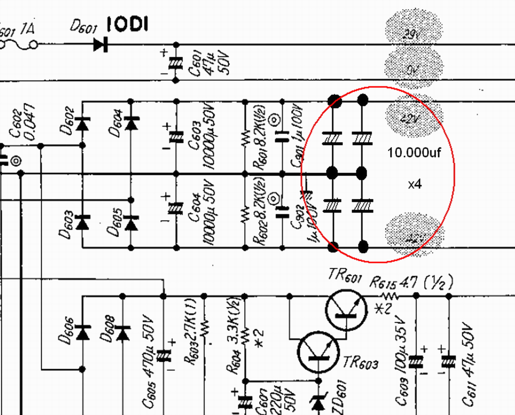

There's almost nothing to do with this amplifier...it is good enougth
To beat several modern units.
If was mine.... i would only increase the supply condensers...just that.
regards,
Carlos

I could be wrong but from the schematics it seems to me that with the right value of the volume pot (some like 10K) the input fet of the power amp stage could be fed directly with the signal out from the pot (of course with some bypass)
I wonder if the line stage is really needed.🙄
I think that "usually" less stages are better if they are not necessary of course :cloud9:
I understand that a lot of high quality integrated come with the power stage directly linked to the volume attenuator
It's just an idea anyway. I think I will not mess with the unit
Because is working, for now 🙂
A power caps replacement is usually very beneficial .... maybe increasing a little the total uF
