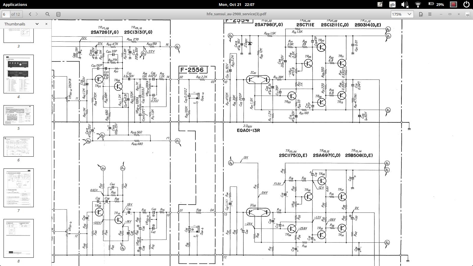

Just a general question when your debugging amplifiers with shorted output transistors, I have removed all 4 of them, What do people do when checking all voltages are ok before putting in the new transistors and potentially frying the new ones? Do you need to short the Emitter to Collector on all 4 transistors to get zero Bias?

So you have removed the outputs on both sides, i.e. TR11+13 and TR12-14?
You can simulate the B-E junction of each by installing a silicon diode (e.g. 1N400x) in its place, orientation following the arrow in the respective transistor symbol (i.e. anode towards base for npn and anode towards emitter for pnp).
Have you already checked the usual collateral damage? R37/39, R33/35, TR07/09, C05, the feedback side of IC01 (2SA798s are known to fail quite commonly even without any traumatic events)?

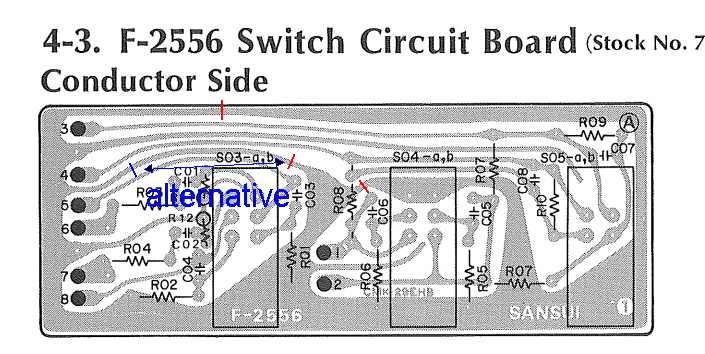

EDIT: I did notice one issue, the Switch Circuit Board (F-2556) is a maze of ground loops. I would suggest a number of strategically placed cuts, roughly like this:

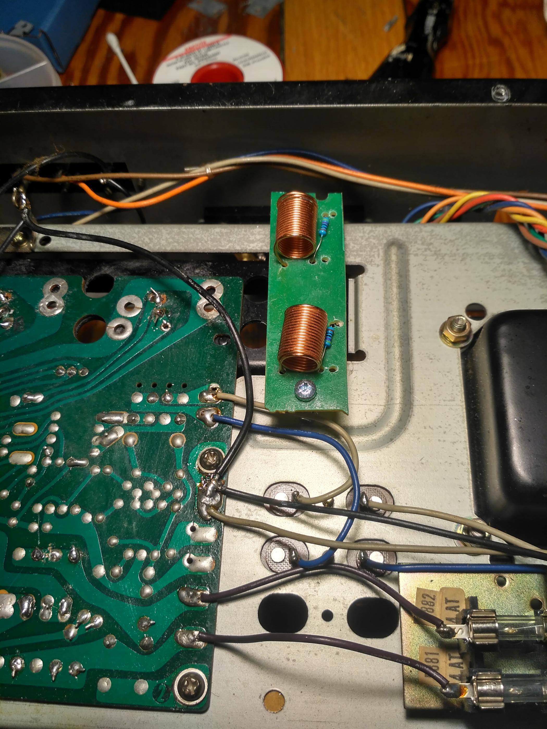

Ok I have the ground mod done, and nearly finished installing the coils, I just have to connect the wires, does it matter if I install the coil before or after the fuses, I presume it does not matter. I only had 470ohm resistors at hand to put in parallel , but they are close enough I presume.
Probably not a real big difference, although usually it is kept before the relay if you're still going for that mod long-term.
Not nearly. I've never seen more than 22 ohms there, and even that really is considered too high for effective LC resonance damping these days.

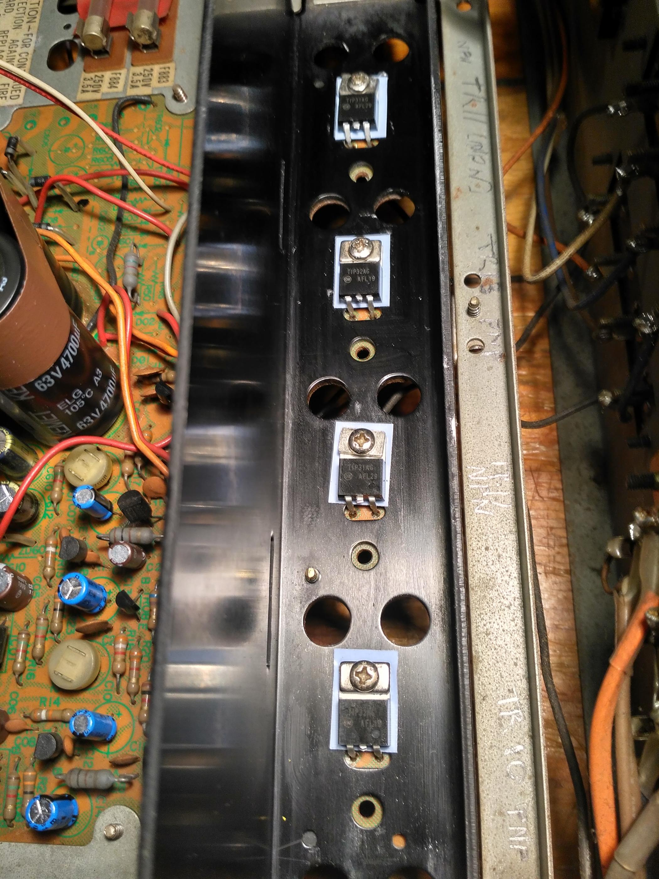

Finally got the transistors installed yesterday evening, and love the sound out of it, Its a keeper for sure, I could not stop listing to it last night. Set up the bias, I already had the 4700uf filter caps installed, as I though you should not go too much higher than the original's but might replace them for UVZ1H682MRD 6800uf nichicon's kind of limited on selection as they are quite close together, 25mm is about max diameter that will fit without having to drill new holes.
Was running some vintage Philips 22RH427 on it. Will check out the phono stage tonight, and finish off the coil installation with the smaller resistor in parallel. Just picked up some infinity QB's with EMIT tweeters during the week, not sure if this little beast will drive them. But it seems to have plenty power for the low wattage, and the transformer is staying cool.
