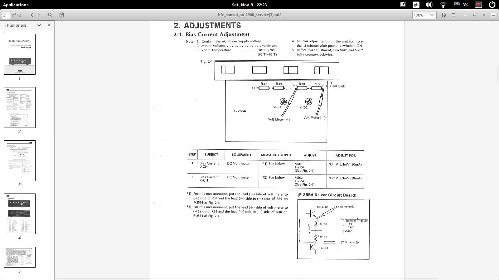

And it does not react to the bias adjustment at all? Are you sure it's not oscillation that you're seeing? Maybe check the RC Zobel resistor, R41. Do all the resistors in the output stage check out OK? What replacements have you used for blown transistors, and where from?
Checked bias, both sides the same @ 9ma ish used tip41/42 and bd139/ 140 but one side is higher dc than the other...

Download the service manual from "HIFI Engine" and go through the adjustment procedure of setting the bias current. This is done by actually measuring the idle "voltage" across the driver emitter resistors. If a resistor goes out of spec then the actuall idle current will be different as there is a different resistance now with the same setpoint (13mV) accross it.
If that is ok, then you will need to follow the schematic and start checking voltages as per the schematic to try and isolate the region/component that is faulty.

Set the bias voltage to 13mV

"TIP41/42 are a bit on the "slow and lumbering" side (fT 3 MHz vs. 8 MHz for the original types). I would definitely not run these at a measly 9 mA, which is even lower than factory spec (20 mA, or adjustment to 13 mV) "
They are the ones I put in from farnell (not fleabay or aliexpress) and set it to 13mV and they run really nicely, no need to re-design the whole power amp 🙂 It sounds nice as is.
