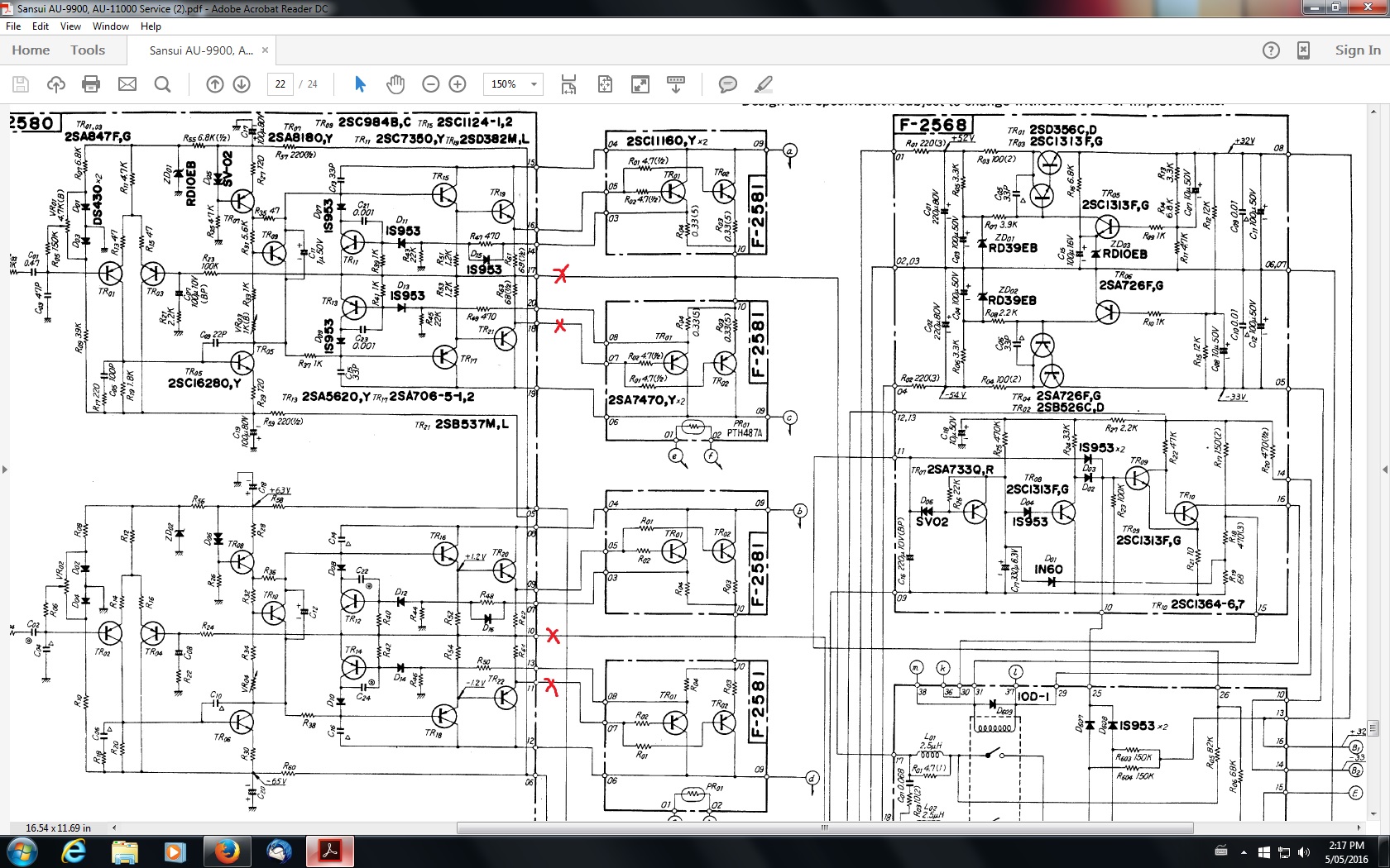

I am in the process of repairing a Sansui AU-11000 Amplifier for a client.
Although initially it was Overheating, the EXACT SAME THING happened to me when adjusting the DC-Offset & Current Bias.
After a whole lot of stressful searching for the cause, my Initial-Theory that I passed-up was Correct: The Power-Transistors on the Heat Sink were bad.
I found that there were a few Power-Transistors on the F-2581's Right-Channel which were shorted-out. After removing the 4 Power-Transistors, I found that 2 of them (PNP & NPN) Across from one-another were Bad.
And after reading RedRoosters post about an Additional Transistor or so bad on the F-2583 Bias-Board, I am about concerned.

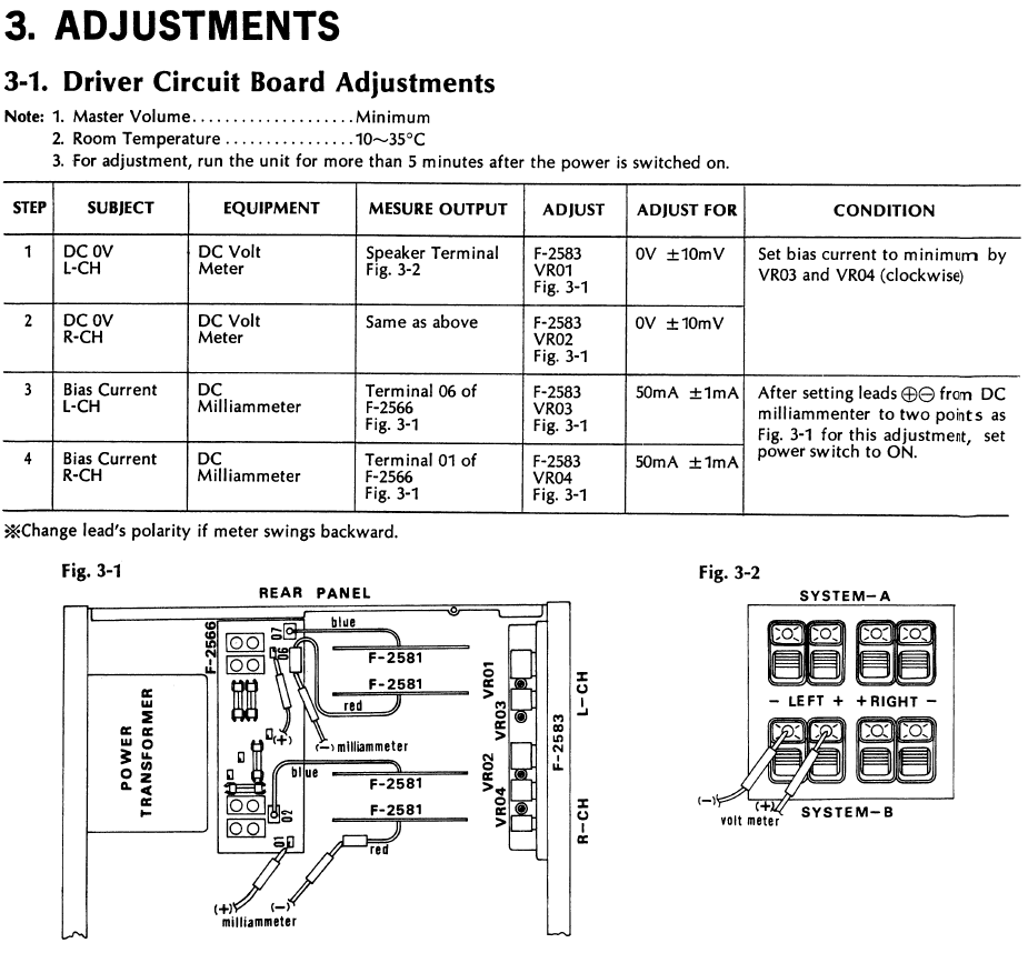

*Also - After going to the trouble of Removing the F-2583 Bias-Board, I found that the VR01, VR02, VR03, & VR04 are NOT in the order as Described in the Service-Manual for the AU-9900 & AU-11000. It seems that the DC-Offset & Current Bias Trims are SWITCHED. The Board has the following Labels Stamped next to the Trim-Pots accordingly: (from Rear to Front)
VR01, VR03, VR02, VR04
Basically, the Diagram in the Service Manual under 'Adjustments' [Fig. 3-1] has the VR's labeled in the WRONG Locations for the F-2583. Fig 3-1 also is shown for the F-2580 instead of the F-2583.
[The F-2583 has the VR01 & VR03 Switched, as well and VR02 & VR04]
I Created a Corrected-Diagram Below...

Please understand that the service manual has the DC offset and bias adjustments reversed! In other words, if you follow the service manual, you will kill your amp!

Redrooster - Yes, I'm talking about the AU-11000's with the F-2583, like the one I'm working on.
The DC-Offset & Current Bias Adjustment mentioned in the Service Manual are clearly just for Units with the F-2580. The Pic I posted is the Correct Bias-Adjustment for models with the F-2583. I had to create it myself. 😛
