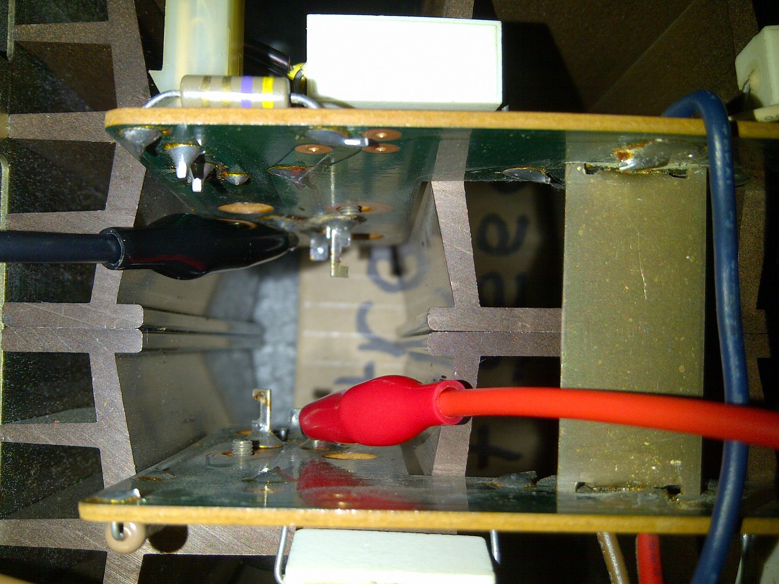

Ready to Adjust the Bias Current - Just to make sure...
Craig - So, even though the Service Manual says to set VR's 3 & 4 [Bias Current Trims] all the way CLOCKWISE, you say it should be the Opposite?!?
Anyways, I think I've about got this AU-11000 back together.
I will be doing the Bias Current Adjustment FIRST on each channel.
Because I only have 1 Multimeter, I will have to do each channel independently. Which means I'll have to turn-off the Amp after I do one channel, connect the Alligator-Clips to the other channel, and turn the Amp back on to adjust the Bias Current for that channel.
*Just to make sure I've got the Alligator-Clips on the Emitter's Correctly, I have posted a Pic of the Clips on what I have calculated to be the Emitters.
So - Is this Right?!? And if measuring in millivolts (mV), does the following Math sound Accurate? : 20mA x 2(.33Ω) = 13.2mV, 0.020A x 0.66Ω = 0.0132v = 13.2mV
Or should the millivoltage be different? Given the Service Manual says to measure in mA, and wants 50mA per Channel (25mA per Par of Transistors).
Just making sure I've got this all Right before I go to adjust the Bias Current.

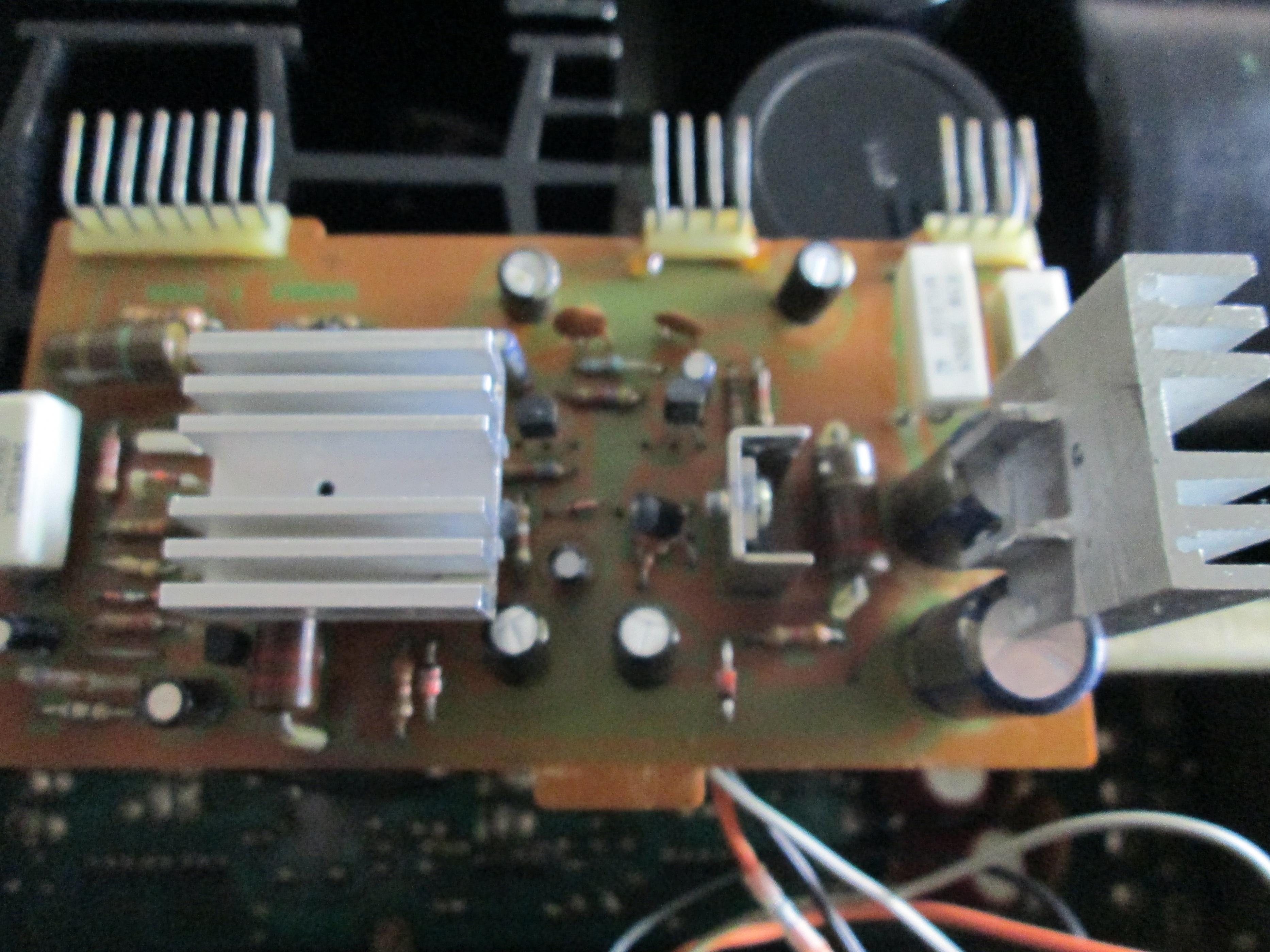

Try these computer heatsinks on your regulator/protection board F-2568. It gets really hot in there with a lot of heat coming from those 5W resistors. You can see in the photo how they clip onto the heatsinks that are already there,Ive taken one off and sat it on the capacitors. I use a bit of thermal grease to slide them into place,its as if they were made for it.
