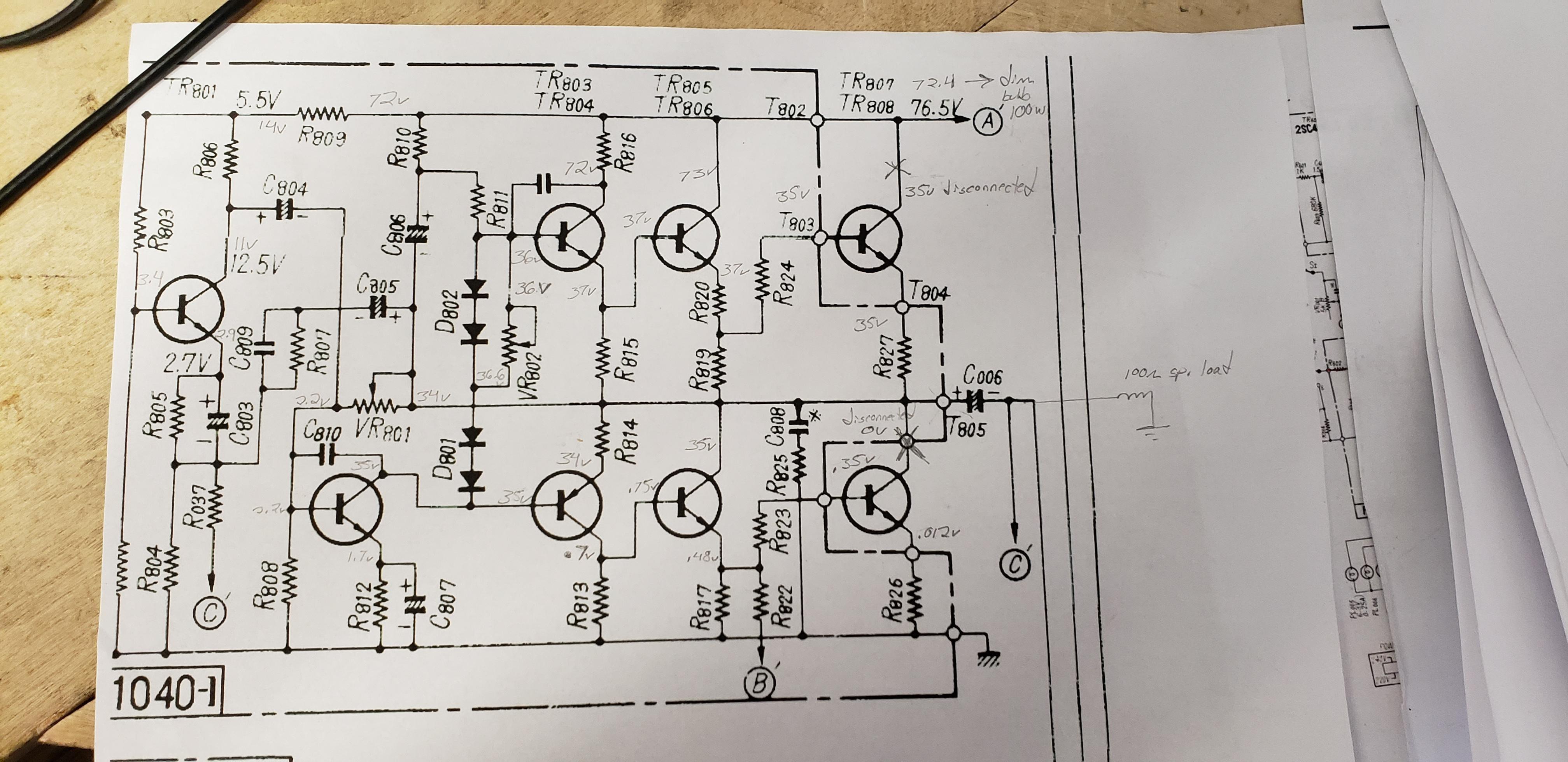

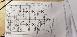

Setup: 200mv signal input into auxiliary input. Speaker load is 120ohms (found another resistor). Output transistor collectors are desoldered, the base and emitters are still connected. Protector and negative feedback loop wires are disconnected. Volume adjusted to just before breakup. Voltages taken on all driver board transistors (see pic).
The signal is fed to the Tr802 base through an additional capacitor as C804.
Voltages are similar to normal.
Tr804, Tr805 is something wrong.
I thought I saw a node and missing base voltage there at R825 on theschematic but it passes through. I have 1 ohm from point C (negative feedback) to the speaker terminal I am testing with. Not sure how I get 35V on a disconnected collector on TR807 and also not sure about 35V on the base there either..
