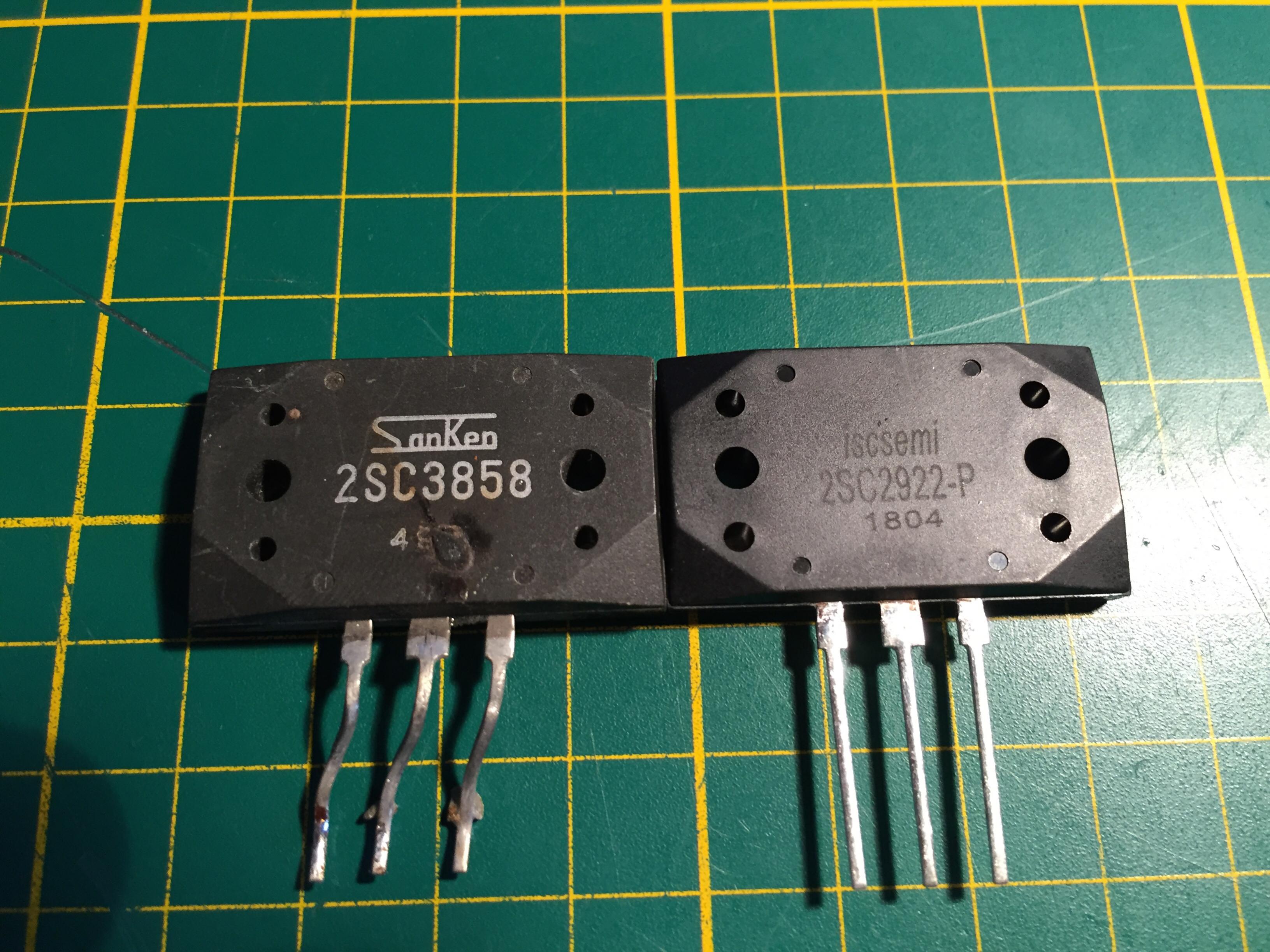

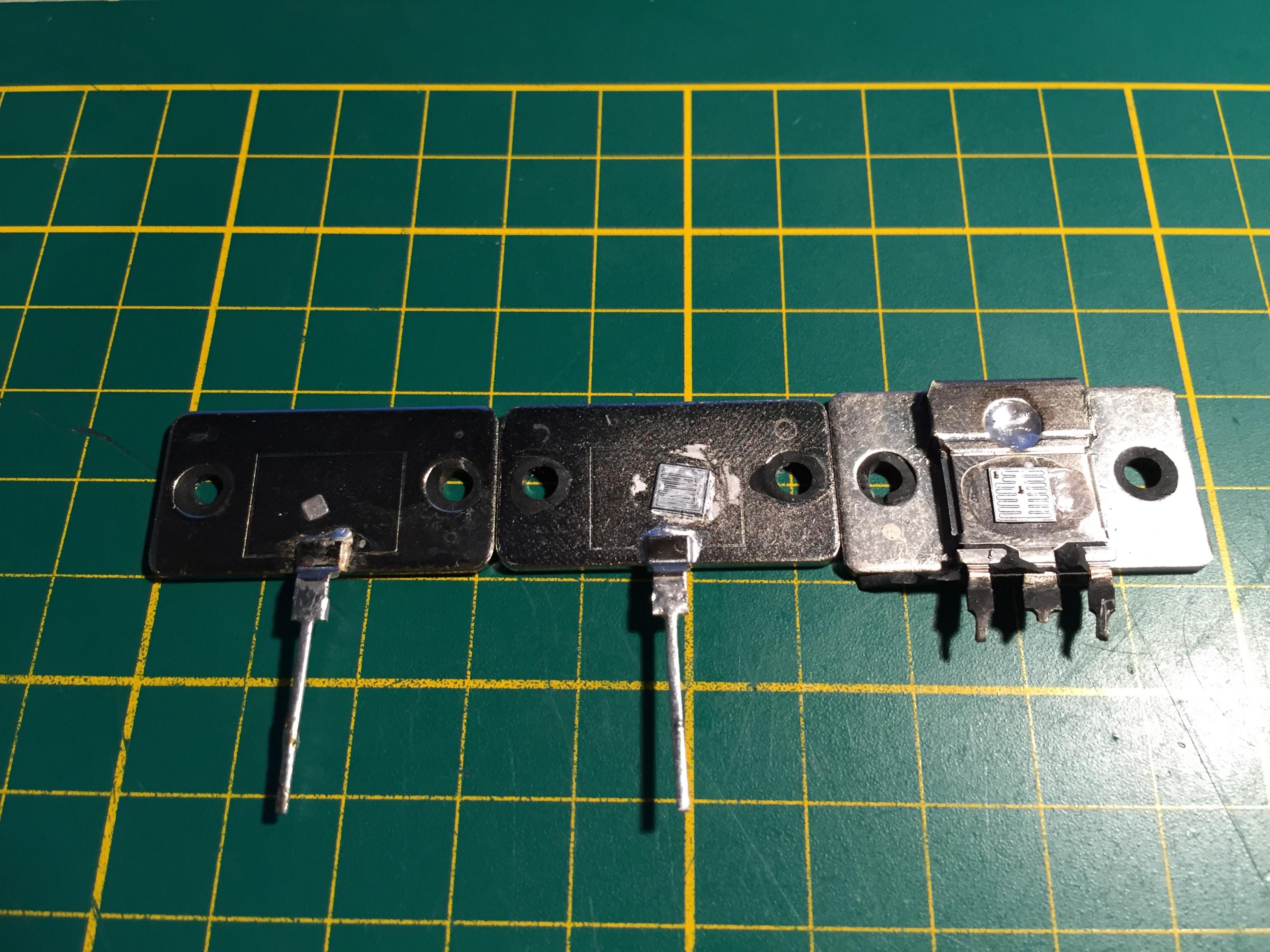

Today I received the Inchange parts,
I only had Older Sanken MT-200 from the 90'S to compare. these are not the same part numbers.
The weight of the ISC is 13 grams instead of the 18.5 of a sanken.
The die Size is about 5x5mm versus 6x6mm for an original Sanken device, this is not too bad considering other devices like the Onsemi 2N3773 also have a 5x5 die.
The ISC lacks the TO3P heat spreader. The point of the extra TO3P heat spreader is to have a buffer against short therm overloads, by increasing the mass of the device. this is lacking in the Chinese device, giving the Sankens a definite edge in durability. also the metal is somewhat thinner, perhaps .25mm.
Funnily enough, the metal is the same thickness and dimensions as some of the fakes sold on eBay, perhaps this indicates a common part supplier. 😕 Furthermore the bonding wire seems to be rather thin.
I wouldn't touch them for amplifier use. Perhaps in regulated power supplies that are crowbar protected... these parts were 40% of the cost, but the cost of the output transistors is dwarfed by everything else in the system.
All in all, seem to be decent ish transistors, the Die size seems to be correct, or in the ballpark (I cannot speak to current generation Sanken devices, im assuming these are unchanged)

That ISC die layout looks like the MJ15024 family. If it is similar (or maybe it is), the SOA may be somewhat reasonable. I doubt it has the pretty beta curves and fT of the original Sanken. So the outputs may not blow, but you could over stress the drivers if your design was counting on having hFE of 80 at 10 amps.... and somewhat higher distortion.
