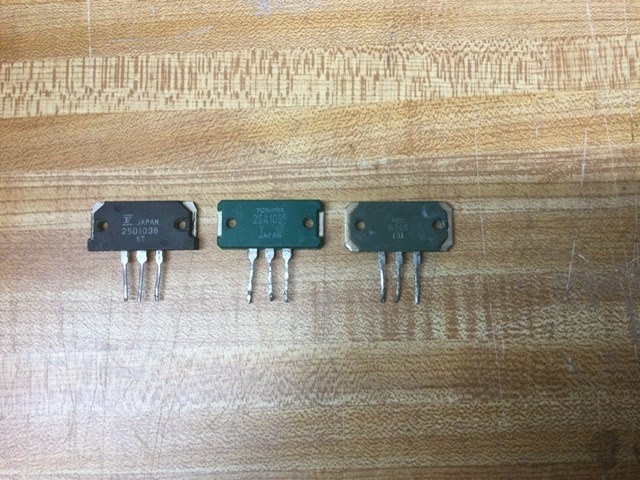

The one on the right is an outright fake. It is marked with the Toshiba logo (not Sanken) and Toshiba never made the MT-200 case. It is Sanken proprietary. Toshiba (and others) made a footprint compatible TB-34 case, but it it more like a regular TO-264 that mounts sideways with two holes. Back in the day when Toshiba made the TB-34, they used the old logo and NOT the one in your pic (which is what they use today).
