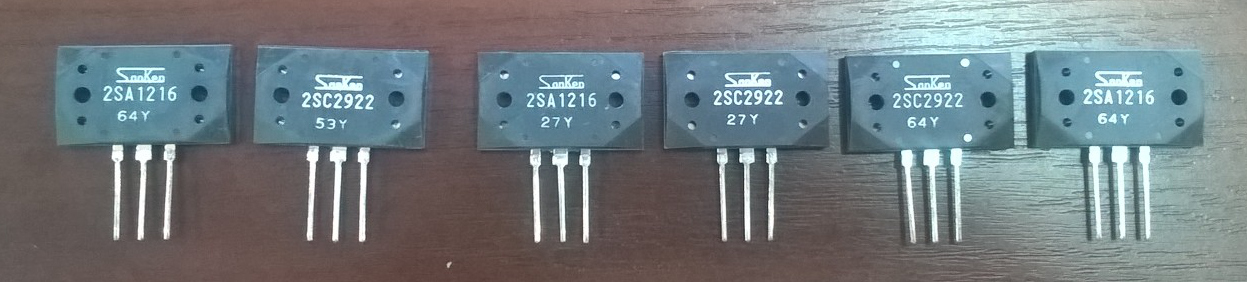

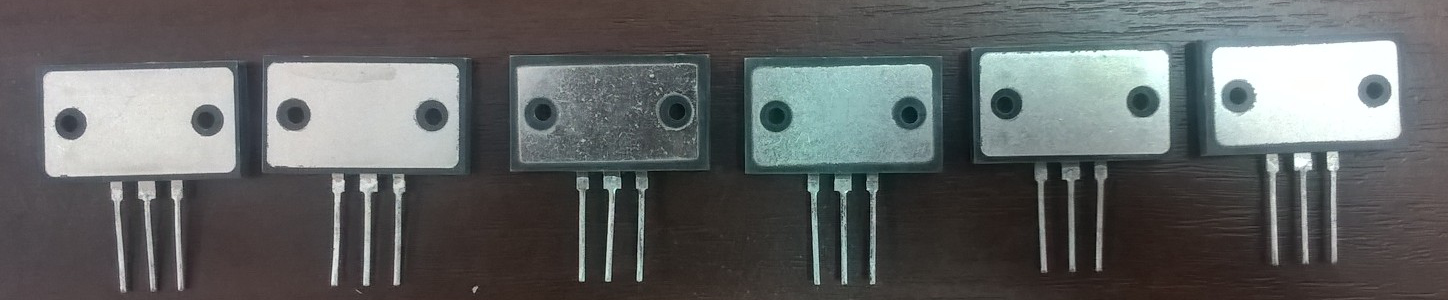

I also found some more expensive transistors and the seller also sent me a picture from the front and the back.
Maybe these are genuine? What do you think about that? For me these look better. But photos are not good quality...
Not sure about these but seams fake also.
Sankens
Sorry to say, but they do NOT look as fakes, and probably are not😱
Yes i.'m sorry those are fake for sure also!!
Here's the source http://www.diyaudio.com/forums/parts/82638-my-transistors-original-copy-25.html
Ok, I just skimmed the pictures of the backsides. Nr. 4 from left looks pretty frosted to me indicating "genuine", but right.... they seem too different, but may not all be fakes
