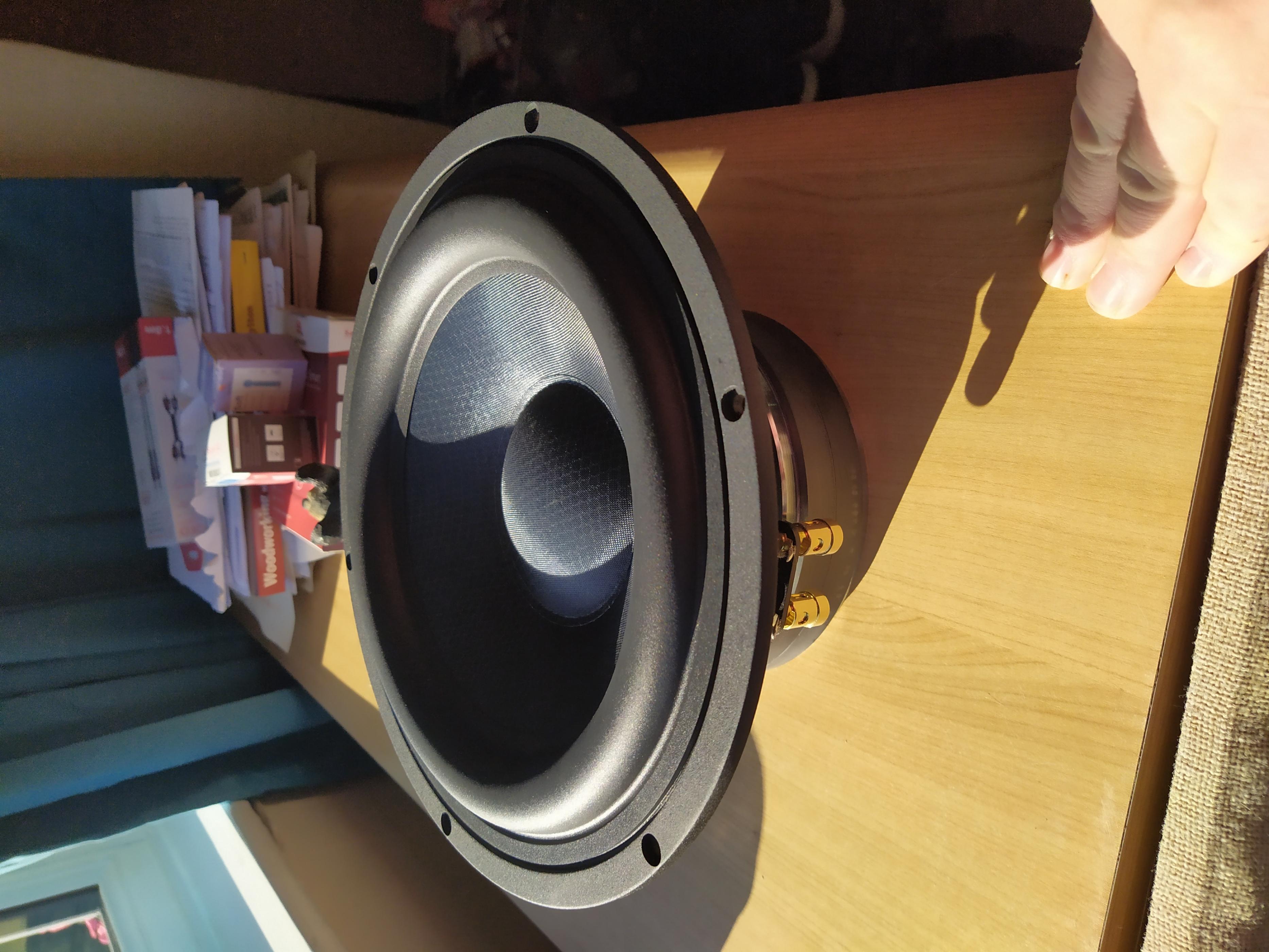

Just checked the tracking info and they are due today.
I'll make a test enclosure and if they're no good for me i will have to sell them on.

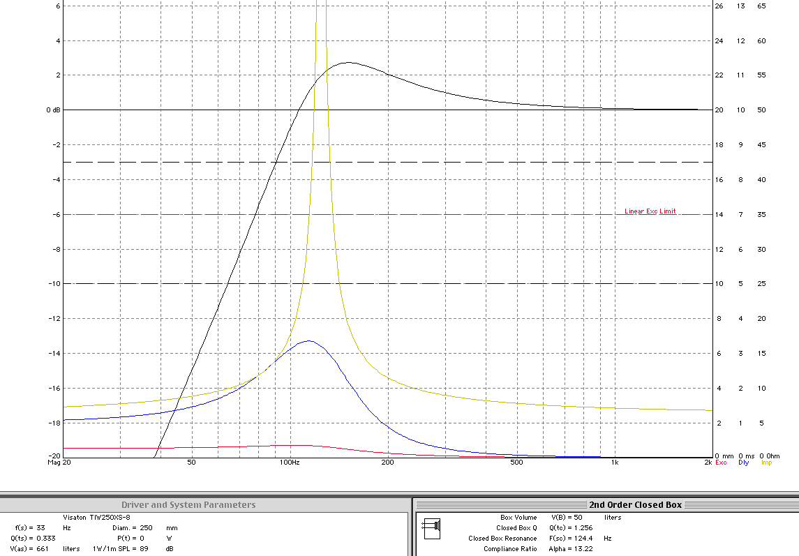

I am not sure where the (wrong?) figures (Qtc=1.3) of post #60 came from, still 45-50 litres sealed or vented for TIW250XS appears well. I would remeasure TSP od the woofer unit to compare with factory ones, then proceed with cutting timber. Satori MR13P-4 can live happily in a 2 litres sealed box, Qtc being about 0.63 and Fc =130 Hz.
From here (my sim based on factory specs (AFAIC the best ons to start with):
50 litres to account for some damping.
Few of have T/S measuring kit that pulls numbers off the T/S curves that are as useful as the factory ones.

Dave there is something way out with your simulation. A quick check for a 50 litre box gave a 50 Hz resonance with a Q of 0.5 which agrees with the published result on the Visaton web page.
Indeed there is. If you look at the parametres it says 661 litres. That is what the 66l on the spec sheet looks like when you are going too quickly. Corrected to 66 litres 50 litres does get near 0.5 Q.
With the correction, you could use even less volume (but this is a nice Q if you have stiff walls). On 1st look the largest miniOnken alignment i would put them in would be about 32 litre.
