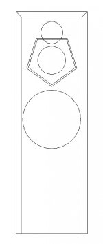

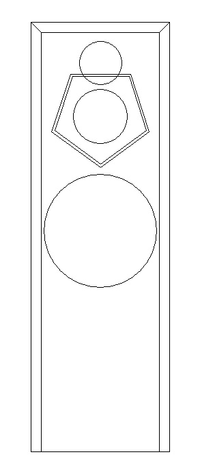

Yes I can see that one. Curious about why have you opted for a 5 sided midrange enclosure?Working pic ?
xrk's dagger?
Inspired by but as the speakers not very deep i might not taper it off as it might restrict the air space for the mid ?
TBH, i've not worked out how many litres i need for the mid or how many litres the enclosure will work out to be.
I'm thinking i'm going to make a test box and see how it sounds/measures.
I've not seen any builds/designs using this mid to get an idea what works for this driver.
...5 sided midrange enclosure...
The more sides the closer the box approaches to a circle. 4 sides has the issue of parallel sides, 3 is best i’d think (i typically use a heavily tapered midTL out the back).

That might be useful. Did the people you are being inspired by do this? Are you intending to add stuffing to absorb the sound from the rear of the midrange?I'm thinking i'm going to make a test box and see how it sounds/measures.

I was thinking 3 or 5 sided to avoid parallel sides, i thought a 5 would keep more space between the mid and the enclosure wall rather than 3 ?
I will probably line the inside walls with fleece and get some natural wool to lightly stuff the rest of the enclosure. The outside of the enclosure will have some bitumen sheet applied to it.
That works against the plywood and the bracing, it is counterproductive.
Now on the outside of the mid enclosure to lower its resonance below (say at least an octave) below the XO point, allthou any radiated box energy will radiate into the bass enclosure to one has to ask the question, how much will a midEnclosure wall resonance affect the midrange.
I’d go for a low pressure aperiodic midTL out the back ideally with only one panel needed to separate it from the bass enclosure. It should be noted that that topology lends itself to “2” boxes with isolation between them (if you want to get anal).

I might end up doing a tapered dagger if it only needs 2.3L for the mid, plus i was only going to use it down to about 400-500hz.
Why do you believe parallel sides are an issue particularly if you are going to stuff the box? If you are not sure and getting conflicting information off the web (who would have expected that) then performing an experiment on a prototype as suggested above is likely to be a pretty good idea.

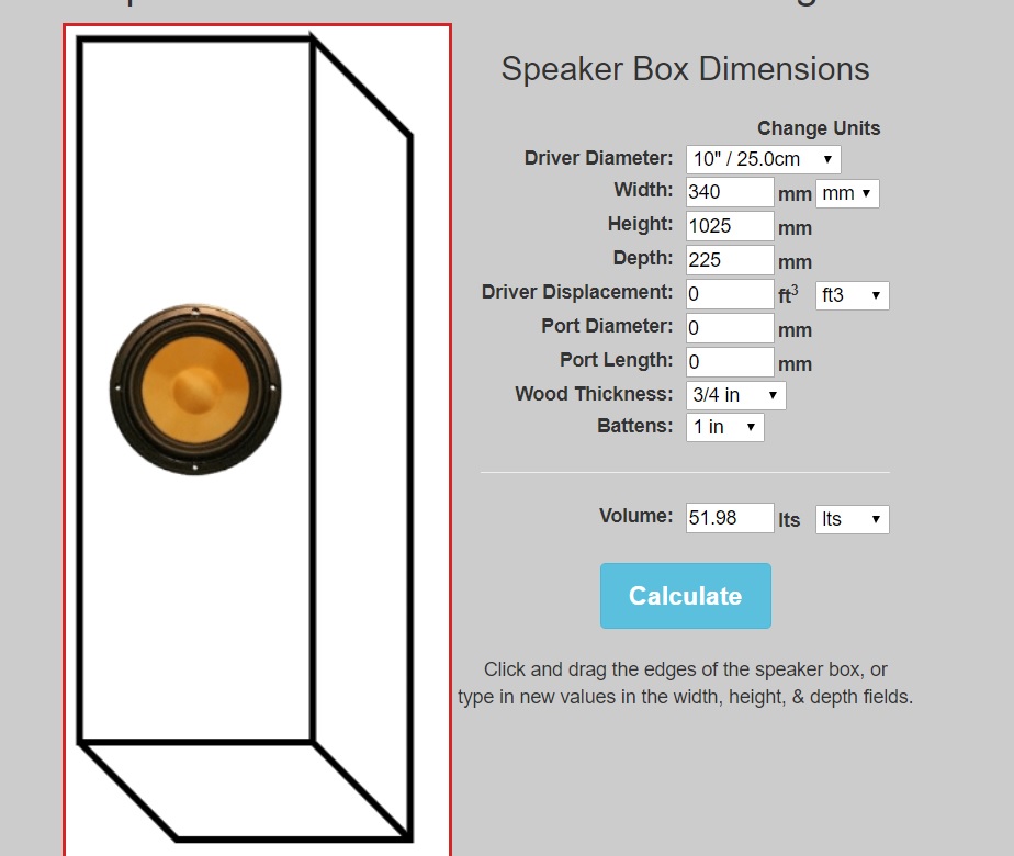

...i'm hoping to still have approximately 45L ?
You might well have to go to an aperiodic enclosure — as opposed to EQing — to help with the big peak.
Way too small for a vented box. Sealed a Q of near 1.3, F3 = 90 Hz, F6=80, F10=62ish. You have to be very concerned with the extra excursion and power required to get this woofer even down to … i’d have to look up the figures, but there is some quadrupling in there.
