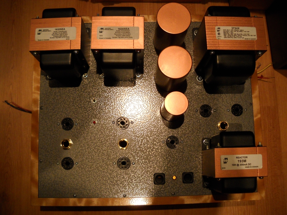

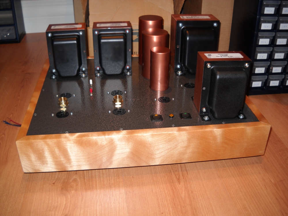

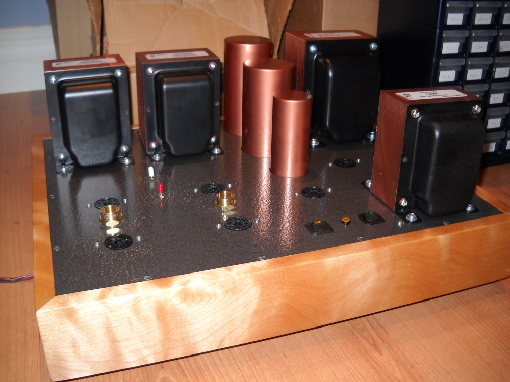

Thanks to all who posted. I decided to go the shortest way and sand down the plate edges since Hammond confirmed it was ok to proceed that way. It went very well, the varnish (or whatever it is dipped in) came off easy. I made sure to remove dust with lacquer thinner afterwards. Take a look at the pictures, I added copper finish paint.
