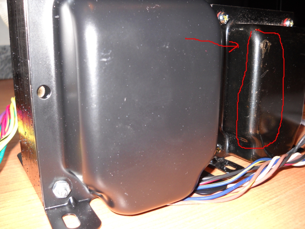

Hammond (the rep) confirmed that he have spoke to engineers and confirmed that it was ok to sand down to bare metal without problem. He will ask if the stacks are welded and come back to me early this week. I told him that I would take care of fixing the lamination finish but I asked so they send me a new 193M choke since the baked varnish peels of too easy. After all they are under warranty and he mentionned that I need to be satisfied with the product I purchased. Good thing to know from hammond.

After you have spent some time with the lacquer thinner try using Acetone, same amount in a metal tray. Use double vinyl or other protective film gloves to avoid poisoning your self. This will melt the polyester resin that is likely the varnish used. Just wipe the core edges with a wet strength paper towel now and again until you get it as smooth as you want. Once the resin has reset, lightly sand the paper residue off and paint.
I am a transformer engineer and this is what we do in our plant to refinish or dismantle the transformer core. I would remove the endbells and bolts. keeping the isolation washers where they are on the bolts. Don't loose those, ever!!!!! Then perhaps rebolt the core with some appropriate size just to keep the pieces of I lam from dropping out.

Thanks for being precise on the whole cleaning process. Can't I use the original bolts and washers while I'm doing the job???

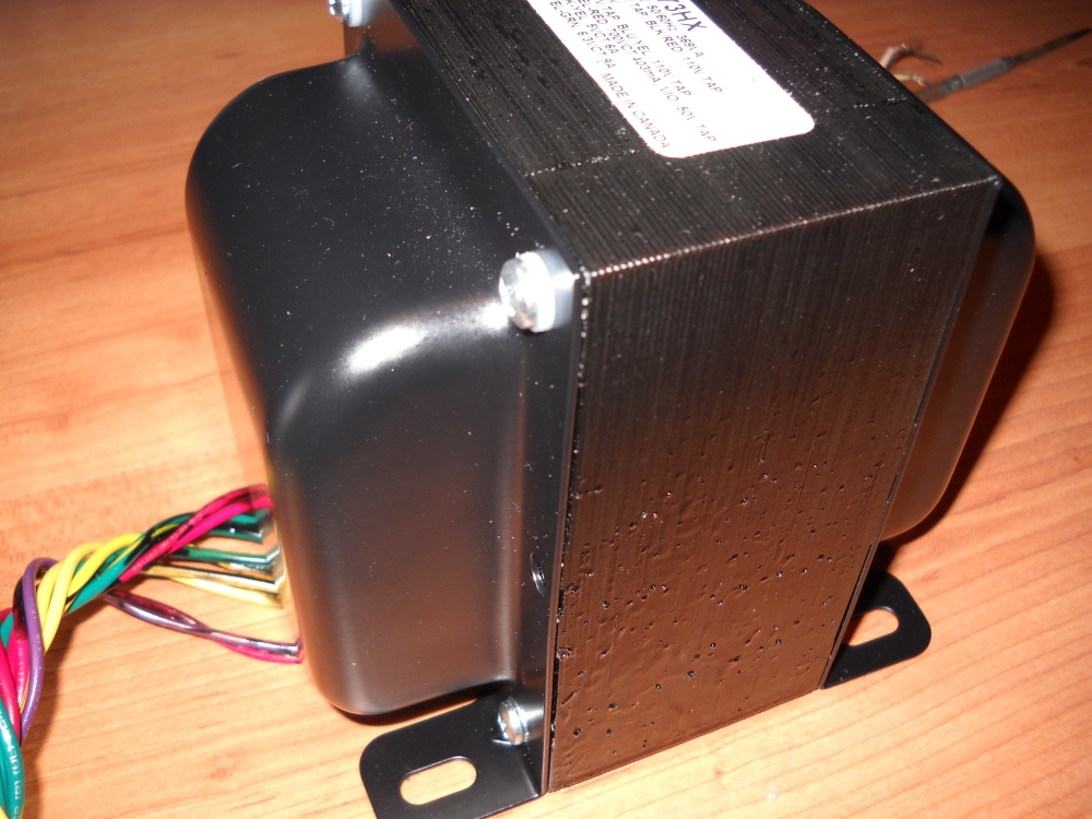

Thanks to all who posted. I decided to go the shortest way and sand down the plate edges since Hammond confirmed it was ok to proceed that way. It went very well, the varnish (or whatever it is dipped in) came off easy. I made sure to remove dust with lacquer thinner afterwards. Take a look at the pictures, I added copper finish paint.
BTW, I noticed also, that Hammond transformers are assembled very quickly. One of my OPT has phenolic washer and the other one had plastic sleeves. The PT had two crushed plastic sleeves. That lets me perplex about their Quality department.
