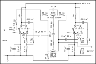

The most cost effective way to deal with control of listening volume and channel to channel balance is to employ separate L/R mono log. (audio) taper potentiometers. Fact, the tone controls in the unit suck. I've uploaded a schematic for 1 channel of tone controls "done right". Please notice the level of complexity needed.

Thanks Eli Duttman. Looks complicated for a newbie like me, but I will keep it incase I dare to try it in the future.

My point is that tone controls should be left out. Very few recordings benefit from their presence. Most of the time, tone controls foul the sound up.
