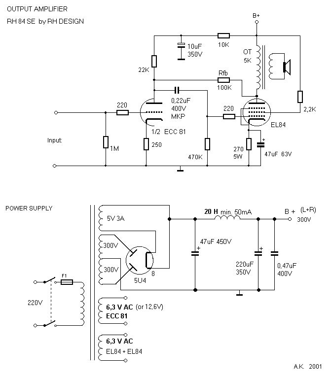

I will not say definitely, until pictures (top and bottom) of the chassis are posted. You have a pair of 9 pin sockets and you need to install a 3rd. Also, get the schematic scans up.
Dave's suggestion of a RH84 variant makes a lot of sense. FWIW, I'd add a small % of GNFB, just to linearize the O/P trafo.

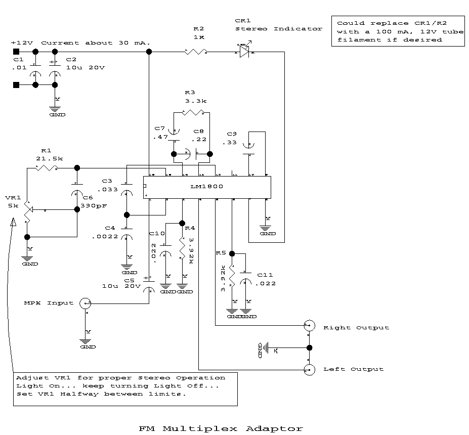

BTW, DIYer extraordinaire Steve Bench has provided a MPX decoder design that can be used to get stereo from the mono tuner. With only a single 6AU6, that tuner is no great shakes. Still, you say it sounded decent.

You previously stated that the 8 tube model in your possession does not have MPX. No MPX = no FM stereo. I uploaded Mr. Bench's circuit for a reason.

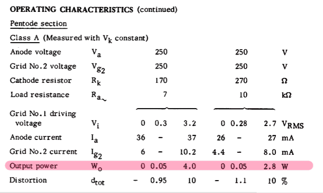

Probably on the order of 3-4 watts.
dave
I am totally confused! The booklet says it is 10 watts of audio,
but it is very loud with the factory speakers. Fine it was designed to work well with it.
