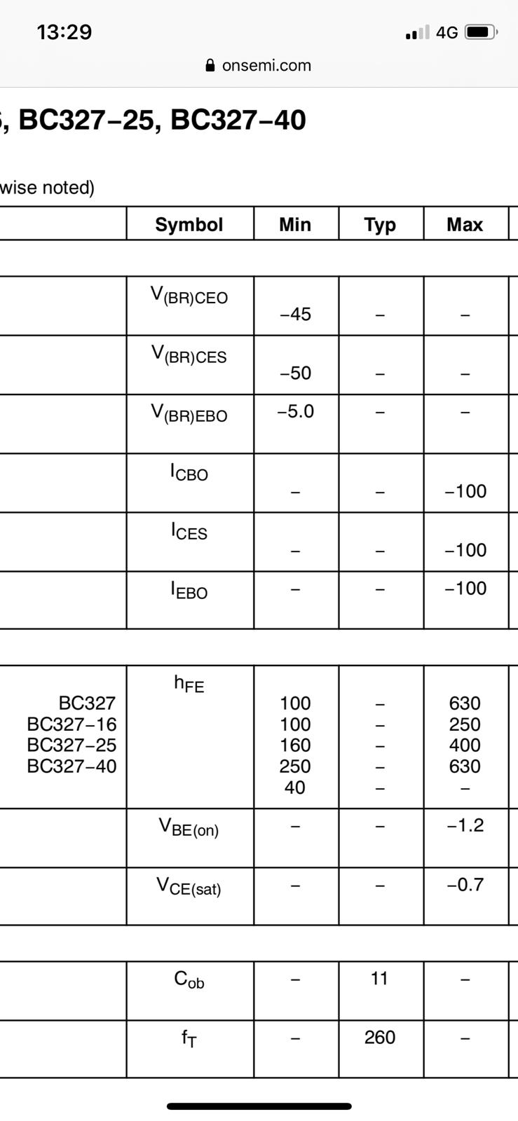

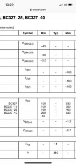

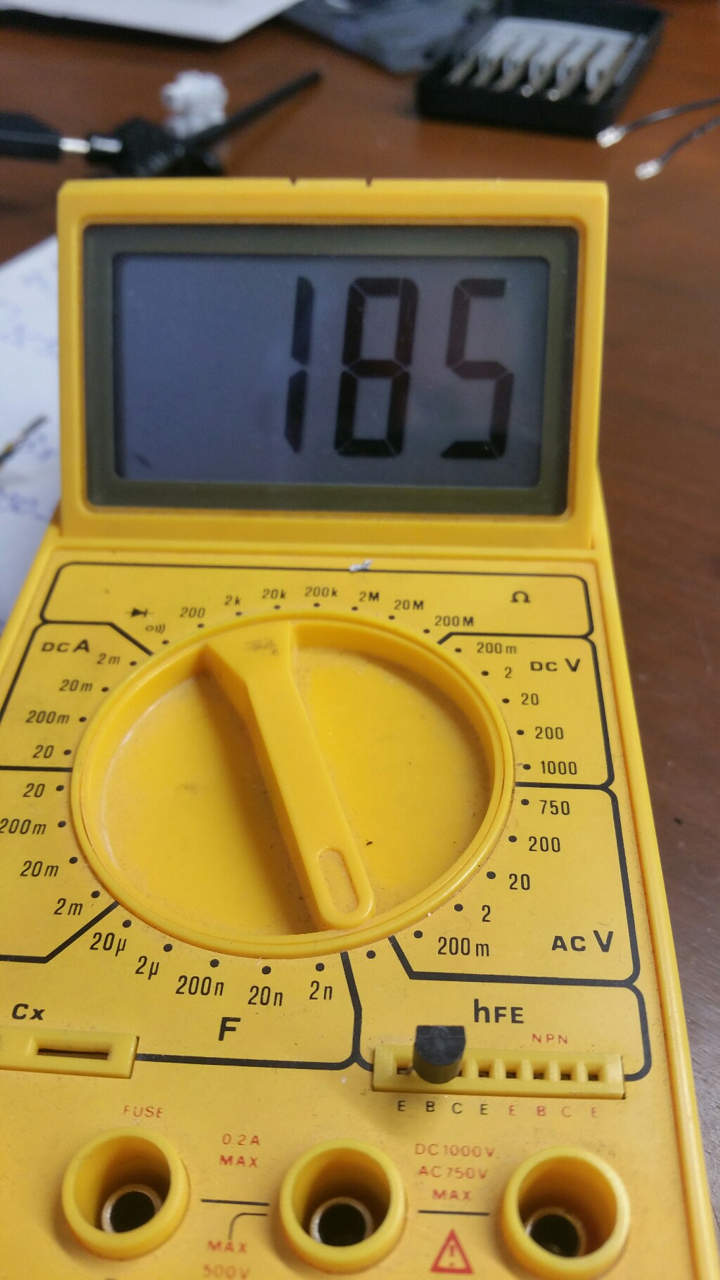

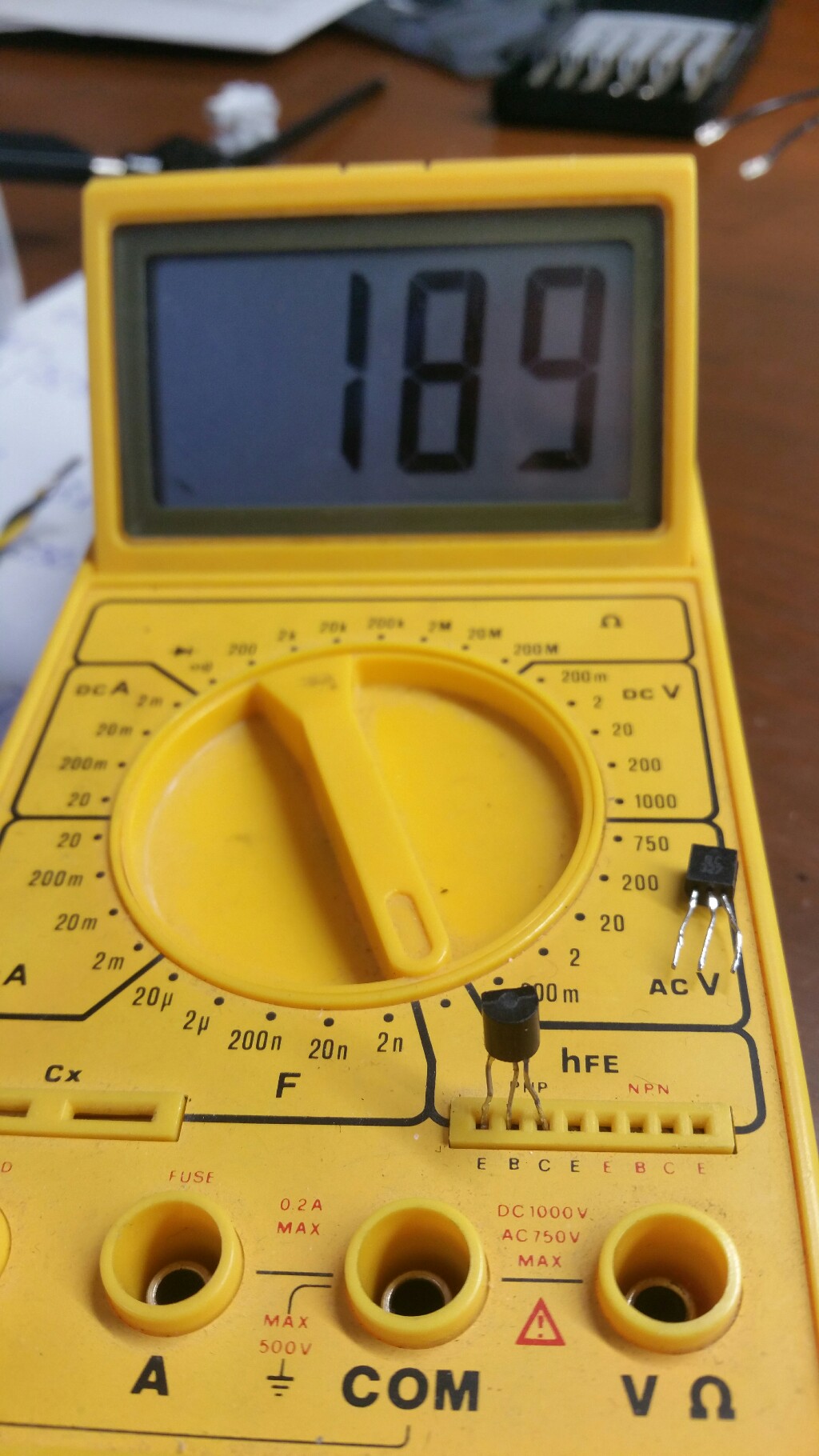

Are those BC327 legit? Their surface is dull and their print looks poor. Not having their -40 higher hfe range suffix even.

I also messure hfe from the 2 bc 327-40 and this are the results.
It looks these are bc327-16 or bc327-25 types or fake ones, I ordered this ones in The Netherlands.
