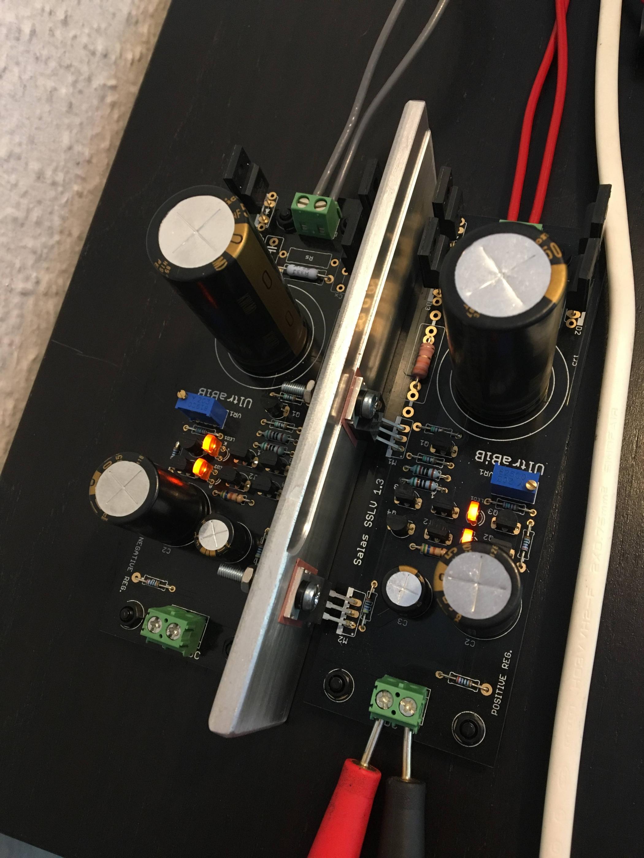

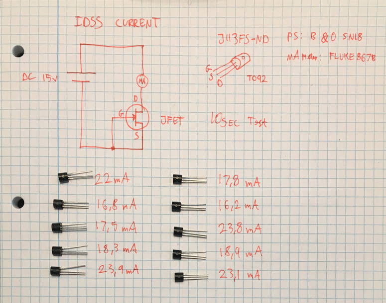

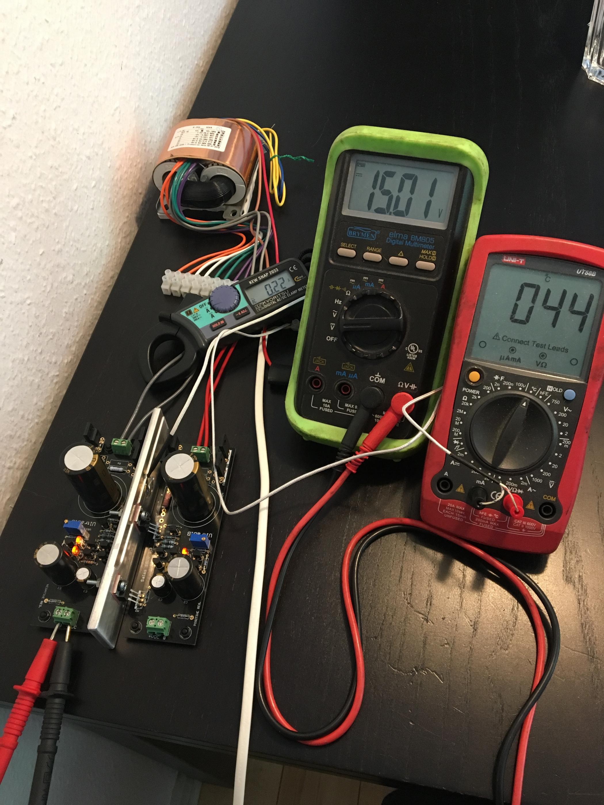

Ultrbib running with J113 JFET
UltraBib is running fine with the J113 JFET instead of the PR5102.
I measured the IDSS current as Salas recommended in post #1559 and changed the corresponding resistors. I only had two 560 Ohm, so they went in for the highest mA rated J113. I used 510 Ohm for the rest. I hope it is fine... 🙂
I have attached a picture of my measuring results. They can properly not be used as "scientific" results with only 10 pcs, but maybe used for any further development to others.
The Heat sink is definitely to small for two Ultrabibs in this setup. The area/size must be larged. I have set the ccmA at 180 mA (3.3 Ohm)...
Next is to build this into my DAC. Thanks for your help Salas 🙂

You are welcome. Those J113 samples are behaving as expected. In other words their modern production is hot for IDSS average.
To confirm what bias current they run in circuit for each position you can measure the voltage drop across each one's source resistor and divide by its Ohmic value.

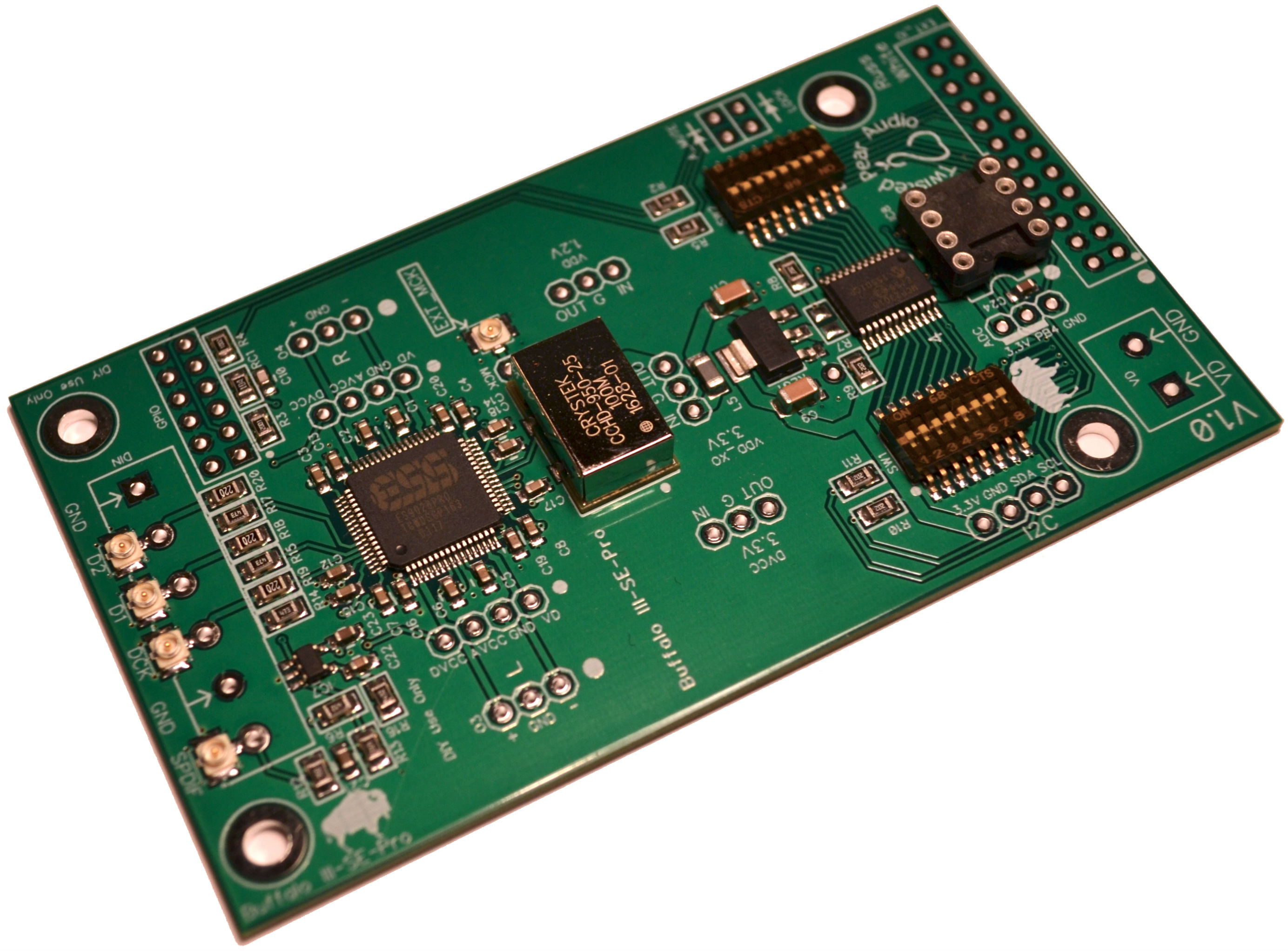

I once mistakenly inserted the 3.3V Regulators into the 1.2V position on the Buffalo and plugged the 1.3V Regulators into the 3.3V position on the Buffalo. As a result, the 5V power supply drops to 1V.
