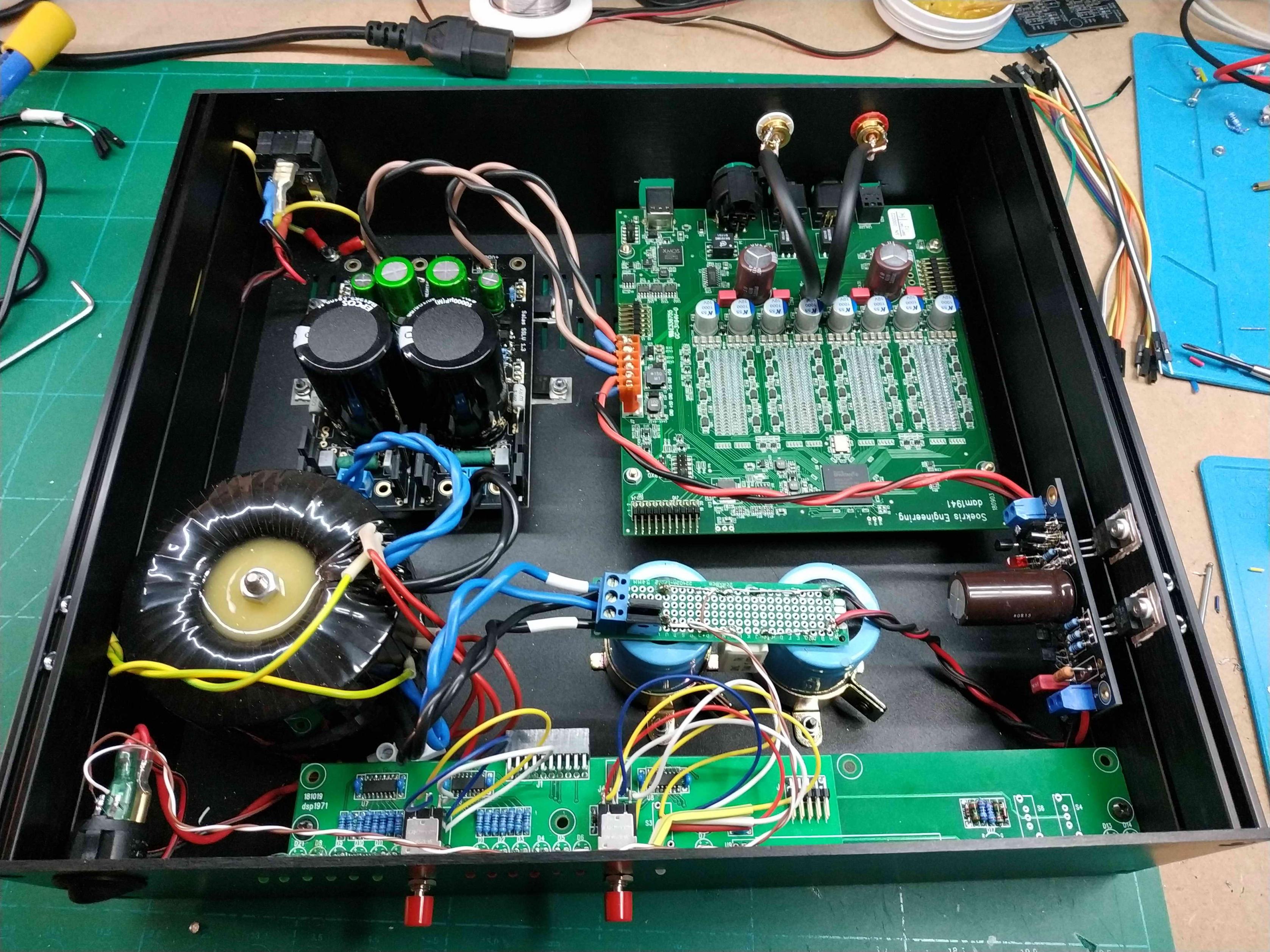

Finished my Soekris Dam1941 with UtraBIB for the analog supplies and reflektor for the digital part.
Really happy with the outcome.
First time I can listen to digital for extended periods.
Looking like it means business. Its also good that he used thick enough cabling between the PSUs and the Soekris input power connector. Something that not all remember to do all the time.
Salas what do you suggest is thick enough AWG?
