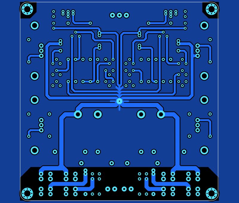

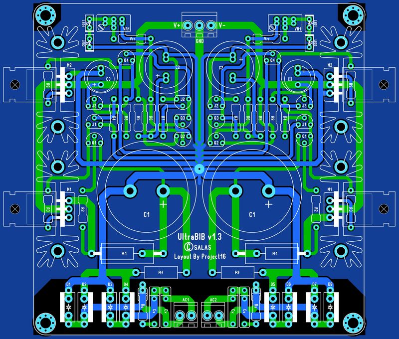

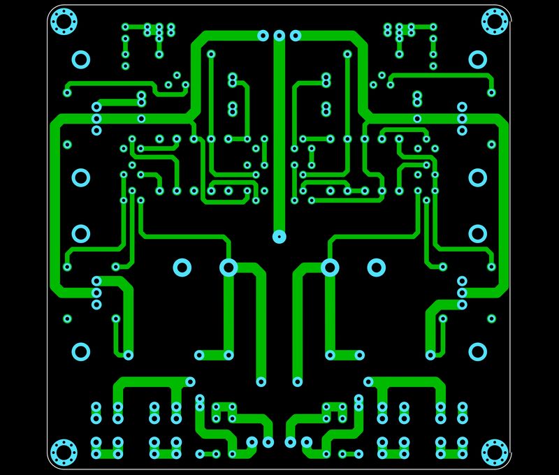

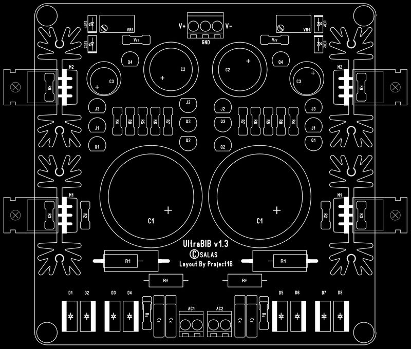

Hello everyone
Salas I reviewed a little the placement of components on my layout that gives complete satisfaction. Now C3 is farther from M2 mosfet.

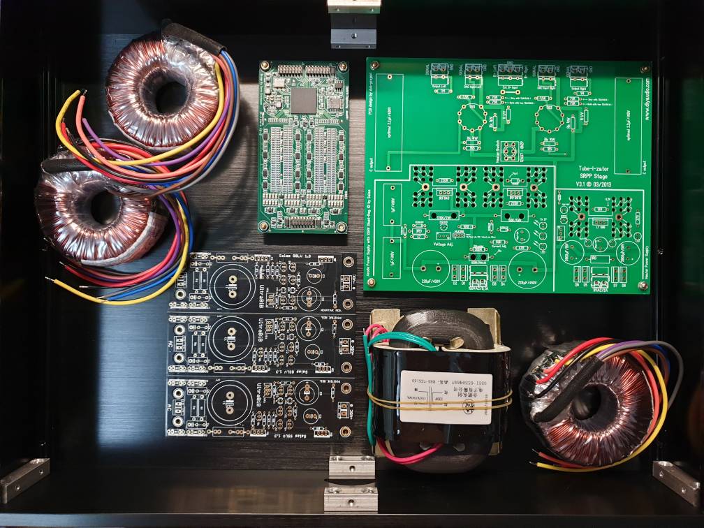

My project to build the Soekris DAM 1121 + Raspberry Pi + Tube-I-zator buffer stage starts today. Based on the chassis which I got, it is going to be very tight placement for all the boards. Bummer.
Option #1
House everything within the chassis. Still missing is the linear supply for the Pi. Will have to stack the Raspberry Pi on top of the Soekris DAM board. The MOSFET of the middle +ve UBiB will have to be air cooled instead of chassis sink.
Option #2
Have another chassis just for the PSU. Which means I will have to stack the 2 chassis on each other.
Have you consider to stack the toroids to save space?
If your case height permits of course.

Can also position Ubibs along their sides with M1 M2 holding them down as they sink to the chassis floor. There is provision for a screwdriver not to be blocked by parts when reaching to the Mosfets. Choosing low profile electrolytics also, so the regs can bunch closer together. Like Epcos C1 and Panasonic FM C2 C3.
