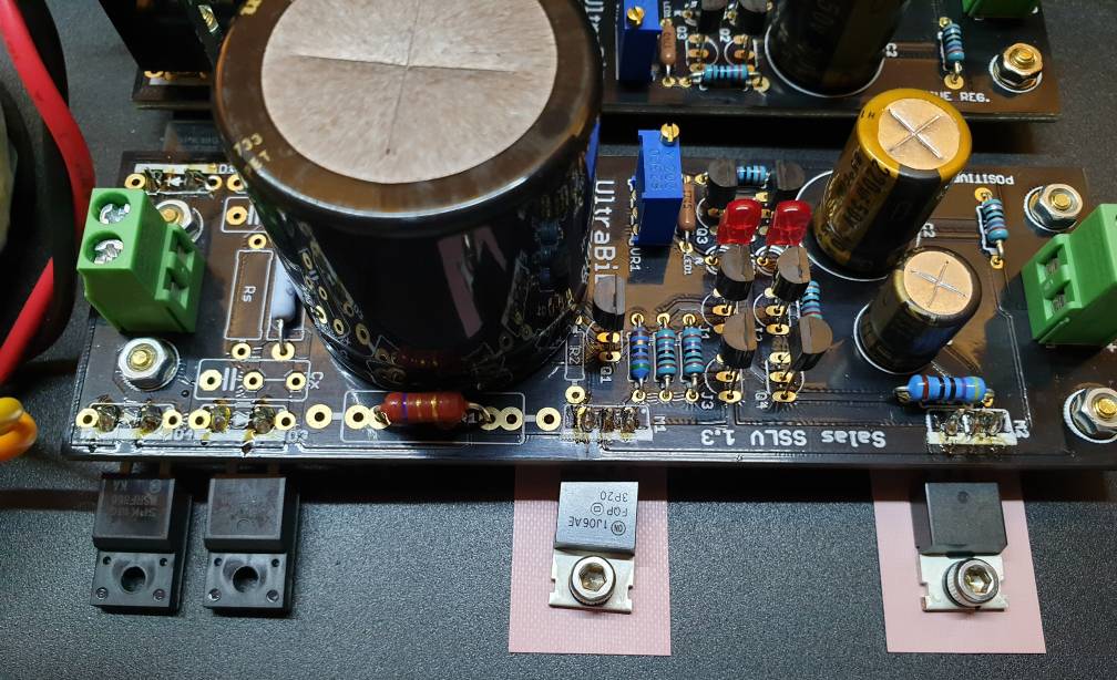

Initially i was planning to mount the MSRF860Gs to use the amp chassis as a heatsink, but given that I was using these regulators for DCG3, I decided to forego drilling holes and bolting them down.
The 860G material looks plastic but I could be wrong, do I need to insulate them as they touch the metal chassis? TIA.

They are insulated, no need for isolation, etc.

The G type comes in TO-220FP package. Fully isolated because encapsulated in special plastic. Can still transfer heat to sinks if needed without having to use any SilPad or Mica insulators. There is simply worse thermal transfer (more thermal resistance) than with the exposed metal tab regular type. In the majority of applications that you don't want to max out its power handling potential on sinks, the encapsulated type is most practical. No insulation bits and mistakes.

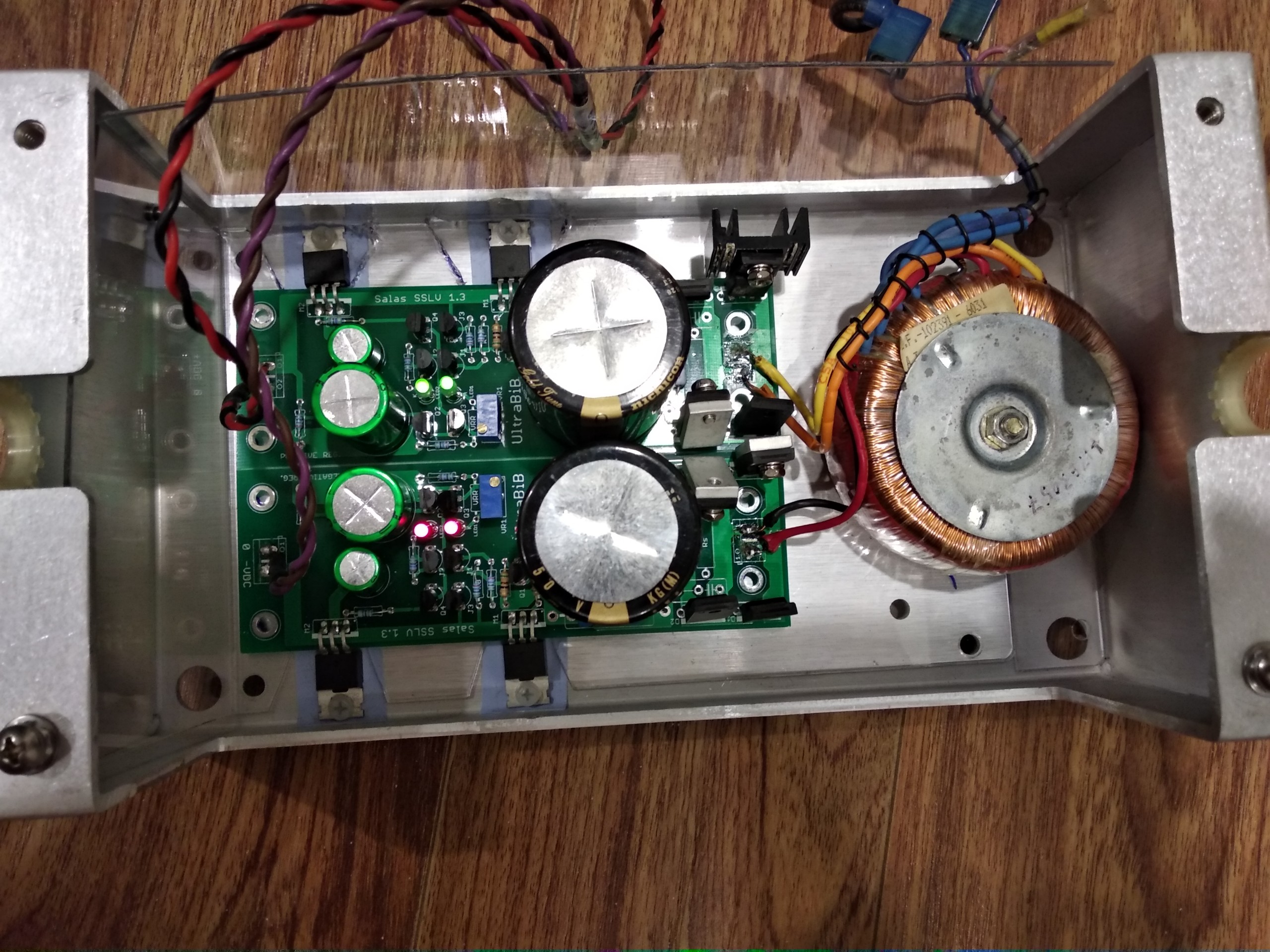

Finally,I complete the Ultrabib shunt regulator +-15V 350mA for my Opamp Katana DAC. The output Vcc driff about 0.5V from startup to stable state, and I will need put more heat shink. The sound quality improve, analog and clear that I can feel.

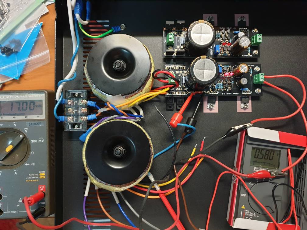

Ran into some issues with the positive UBiB for DCG3. The voltage is stuck at circa 28V and I can't seem to adjust it using VR1.
Tried to reflow some of the solder points in case of dry joints. The other symptom is the 2 LED only light up momentarily whenever I tap on the board.
My 51ohm R2 is soldered on the back because the C1 obstructs.
Checked the JFET:
Q1,4 327-40
Q2,3 BC560C
Checked the JFET:
Q1,4 327-40
Q2,3 BC560C
First see if you really got constant current feed. Is there a near 0.6V voltage drop across the legs of R1? Also make sure you did not stuff a JFET in place of a BJT or vice versa. BJT names start with Q and JFET names with J on the board. Double check the MOSFET tabs insulation to the chassis with the DMM in Ohmmeter mode as well.
Alright, so its something mechanical with the LEDS. Did you cook them much too long while soldering? See their joints to be good. If they will continue to be erratic change them.
