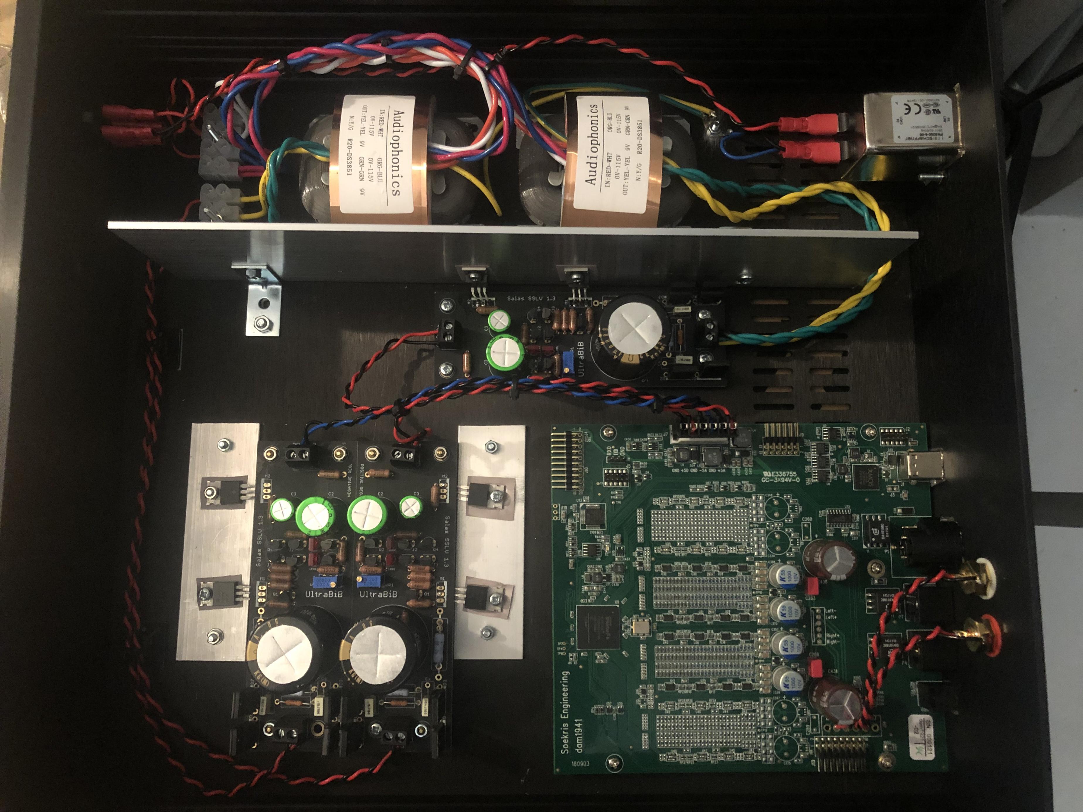

So you definitely don't believe that a poor construction of the transformers could be the cause of this low level noise. I was wondering about their substitution with a Toroidy with three secondaries and see if it works well. By the way I remember that during the assembling, while I tested the device on the wooden plate and outside the aluminium box (with ground not connected in any way), the hum was present the same.

It could be the cause but its not something to be concluded before eliminating other scenarios. Changing the transformers involves cost. Its a risk you may take but I can't recommend it as the solution without hard data. Can be a ground loop between a DAC supply and the Korg B1's external supply for instance. On the other the hand buzzing weak transformers can be changed just because annoying and not inspiring trust in a best quality result.
