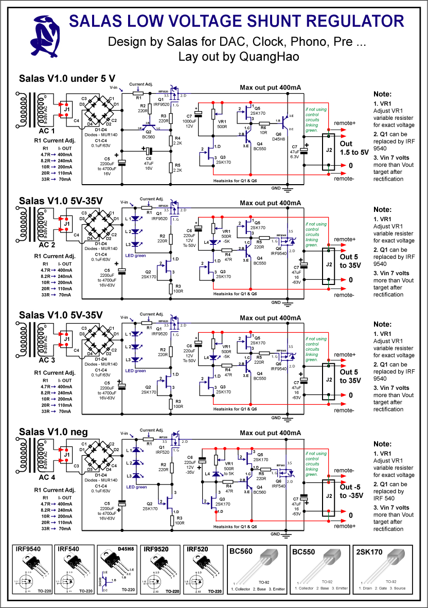

After being Salas showed me his standard designs, I draw the circuit diagram for you to see!
Thanks Salas!
Thanks all!
Bravo Quanghao, fantastic & hard work, you have tied Source Q1 to R1 as Salas advice super also you added the current set in each regulator Vin needed, wow excellent!!!!
Only I see that you left in version 5-35V & neg the R3 100R & Salas posted is not necessary with remote sense possible you left if people don't connect the regulator with remote sense?

Yes IRFP9240 for positive regulators, IRFP240 for negative regulators.🙂

IN THE LAYOUT, I PUT FOR LEG IRFP 9240 and 240!
This time I see QH watched better my advice posts here.
On first reg from top he did not see that RadJ for current is Vbe/R1 though. So the Radj for current setting short guide he shows can not be the same as for the LED Regs below. R1=10 Ohm for the first reg would give 65mA for instance. So calculate with 0.65V/R1 for that circuit.
Remote sensing is good for all if practical. Its good if you can choose on layout by closing the circuit locally or not on board.
Those TO-247s are very good especially for heavier current, the TO-220s are economic but don't burn more than 15W on them on any sink.
Nothing more to add, check a prototype and wishing good luck guys!
I don't see reason to use to-220 fets - 240/9240 are proven
also Led In series with VR1 Is a good option In Under 5V regulator
you always can jumper If not need It

QH wrote above he would layout for both small and bigger Mosfets.
No, having an LED in the first one will not let it go as low enough as it can for Vout. You can always substitute a strong 2.4Vf LED instead of the trimmer for fixed 3V on the other hand as it is. Its an ''on'' indicator too. It would take 1K VR1 to surely can go 5V also sans LED, given the average 2SK170BL IDSS.
