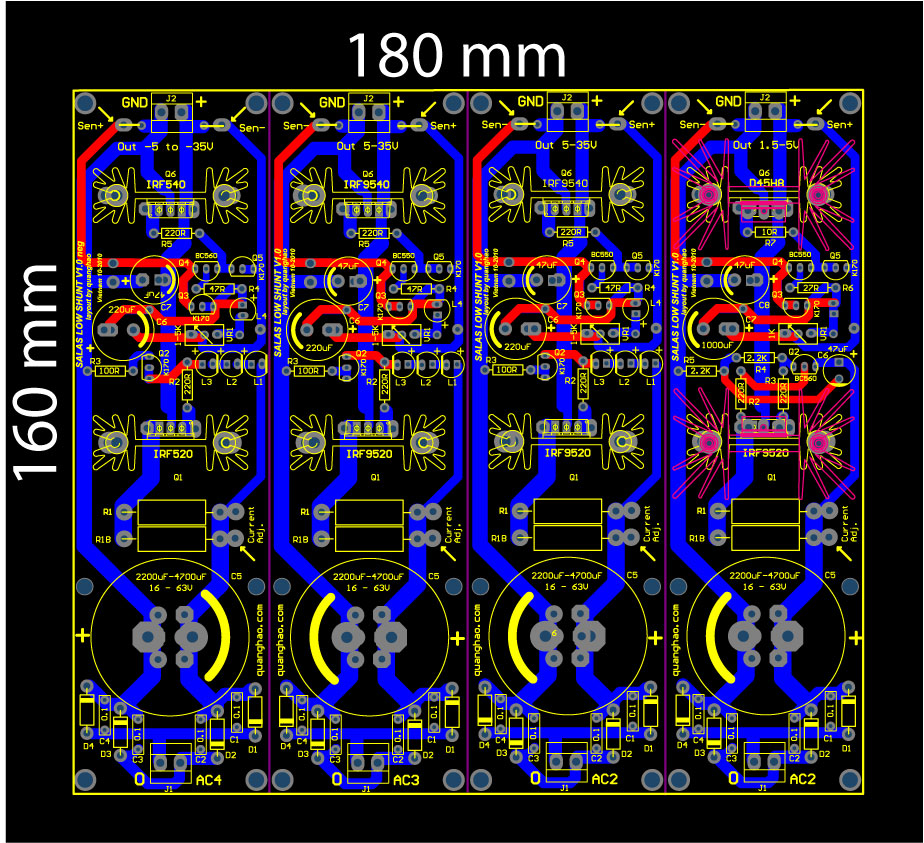

I would like to propose a small change in the PCB layout to allow some or all of the positive shunt PCBs to be easily converted to negative shunts?
Any comments?
The small change, to allow this universal +ve/-ve use, is to the Q2, Q3, Q5 solder pads.
Comments?
The existing pads for these three jFETs are 3pads in line with two of them shorted.
I propose a 4pads inline, with the outer shorted to the inner and and again for the other outer and inner.
i.e. pads 1 & 2 shorted, pads 3 & 4 shorted. This uses just 0.05inch of extra PCB space across each of the jFETs.
The disadvantage of this is that builders will need guidance to which of the 4holes must be used to fit the 3leg transistor.
Comments?

I test wit this layout
Hi all!
I test wit this layout, you can use big Heatsinks on board!
Please it with line pink color!
