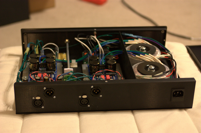

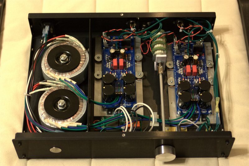

Finally, finished my first DIY project -- a balanced DCB1
This basically copied the design of johnwmclean with a quad gang pot for volume control and an extra rectifier in the ground loop breaker -- Thanks John for your help regarding my silly questions. Also thanks to tea-bag for his help. Still have 2 boards to come and can't wait for another build.
I am currently running at 400ma (i.e. with 5R resistors). DC output is around 1mv for both channels -- dead silence. Sounds really good too. Thanks Salas for making this possible and all the help from everyone.
Congrats Jay, it looks excellent, well done!
