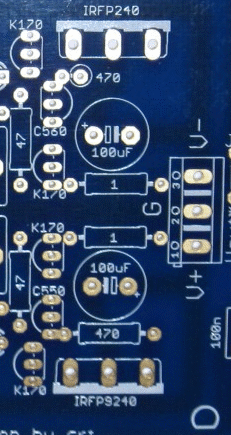

Noob Help for Hyponotize DCB1 Black
Hi everyone
Sorry for noobie question here….
I just finish up the build Hypnotize Black version
But first three LEDS light up fine(both Channels) but second Five LEDS(both channels) not lit up and regulated voltage is +18.3V and 18.3V…(Im using Hammond 12-0-12 2AFor testing) seems like regulator does not work properly… using 10ohm resistors for current limiting…
I checked LEDs polarity several times… and others like TR and resistors too… Relay works fine
I checked each five LEDS banks and it lit up fine individually, but not lit up all five LEDS altogether.
I really appreciate any help

In the 5 leds strings the cathodes (shorter legs, aligned with flat rim cut D on led bodies) must go to the round pads. Is it so?

Thank you for quick reply. Yes I checked several times already, for 5 banks of LEDS directional is OK. If I connect battery each LEDs, it works fine though.
Should I change the TRs and FETs ???

Problems solved I recheck it and each one contains one Bad Leds Change to new one works great !!!

Hi Salas, built my 1st DCB1(hotrod) and on one side the 5 led don't glow(and they are right position,no error)nothing hot or smoke and relay work. Start it with variac and stop at about 85AC on 120AC. What transistor is wrong ? Thank's
