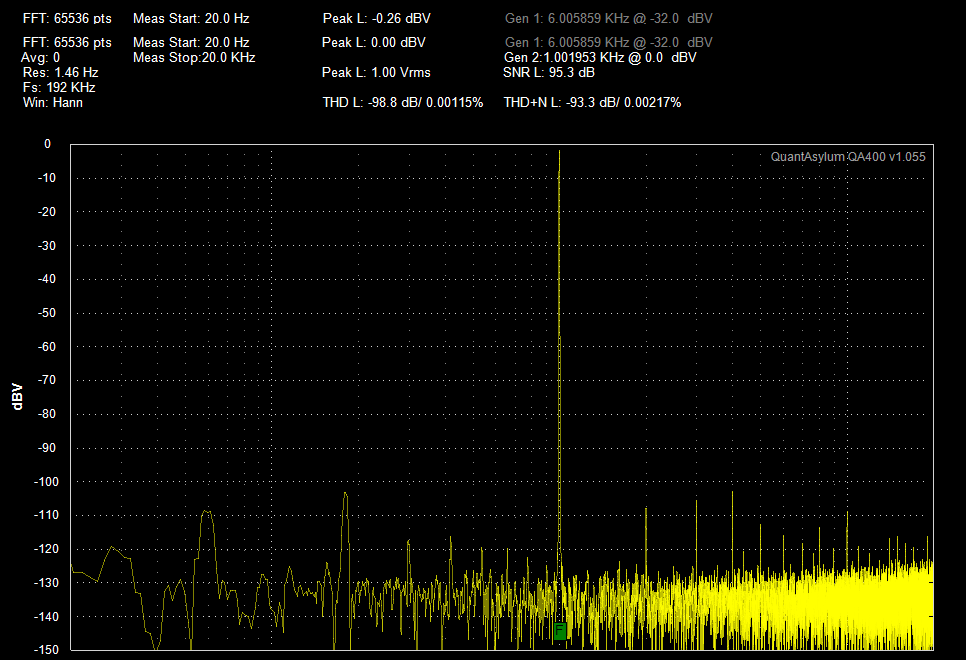

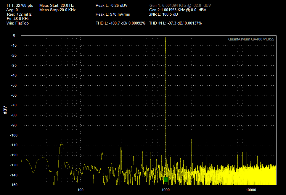

Measures really well now. Twisted the transformer wiring tighter.
THD at below -100dB. SNR at 100 db@ 0 dB input, about -100 dB THD+noise. Crazy quiet. 60 Hz shows at -110dB all other harmonics of 60Hz are below that.

Did you save a screenshot of your DCB1's cleaner QuantAsylum graph after you arranged transformer wiring better? If yes can you post it?

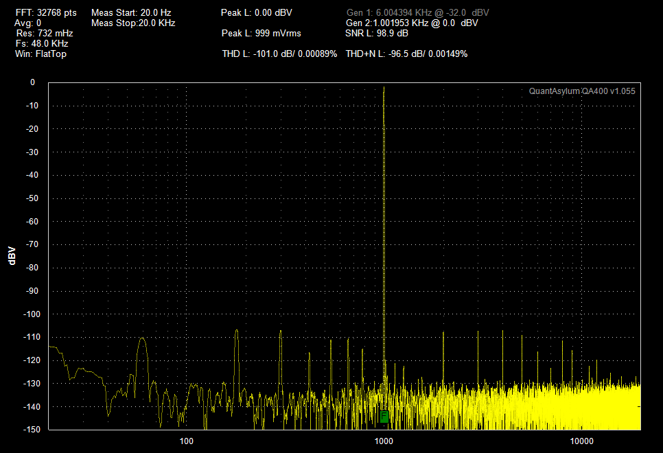

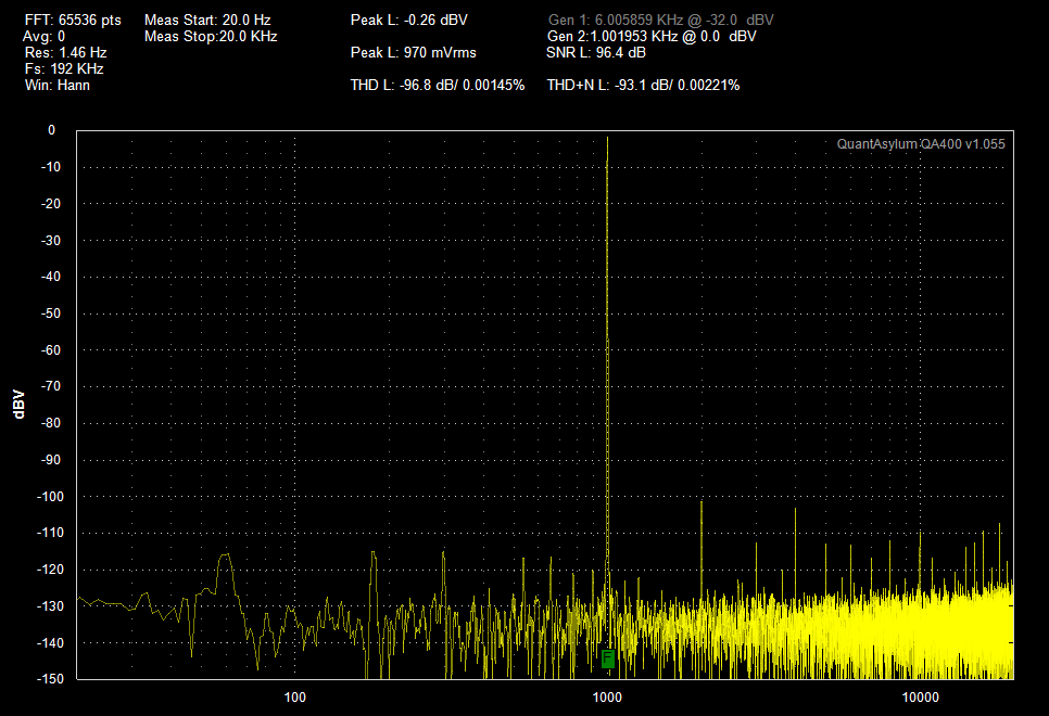

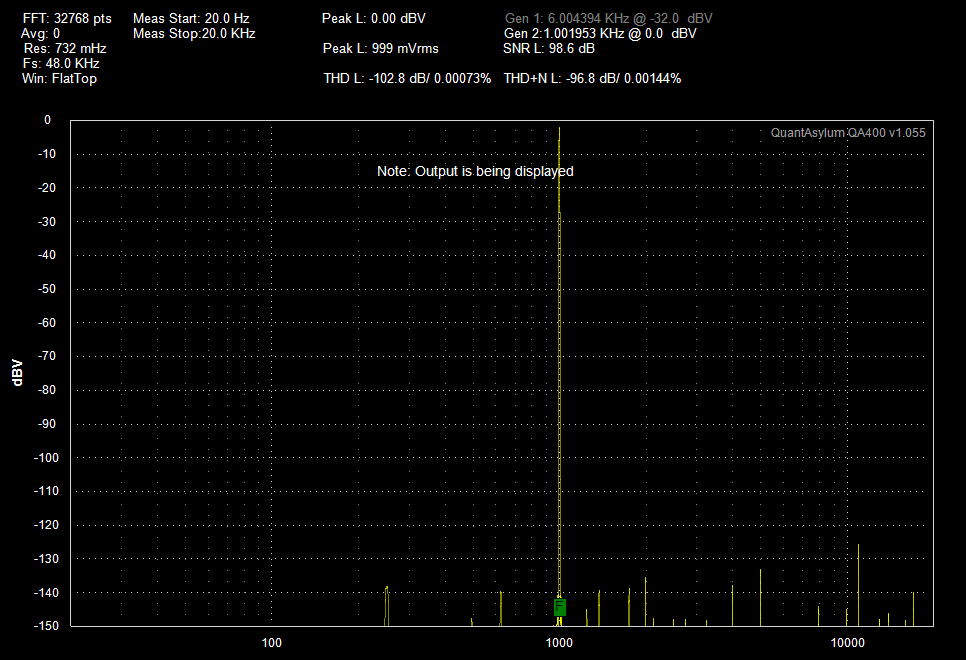

Three screen shots.
First output of DCB1.Second, loopback. Third output of analyzer.. Interesting....
Ha, very comparable to your analyzer's own loopback. Looks like you did a good build job. Doesn't seem to add anything significant of its own.
For even better results and a more trustworthy baseline try to improve your analyzer's loopback. Maybe with shorter better shielded cables. Their ground side especially must be gripping well.
If no success, also see what happens if moving the analyzer away from potential interference sources while its running own loopback. First unplug one by one usual offenders like a home network router, SMPS wall warts, computers, Led lighting etc.

It's very difficult in this room. There are pot lights everywhere, there is a water meter with transmitter a few feet away..... At this level, putting it into a metal pot might be advisable.
You can tell there is something going on with the DCB1, as the volume is slightly lower, and the third is showing lower. I assume that is of different polarity than the third on the analyzer. As you change the volume, the chart changes a lot, so I know it's hooked up right. Those shots are at full output.

Yes, real voltage buffer circuits aren't 100% times one. They are approximately unity. Infinite input impedance and zero output impedance are ideals. In this case able to pass 97% of input voltage level. Maybe joints and contacts in a build contribute some little part of that -3% loss too.
About your QA400 analyzer's harmonic noise baseline and possible susceptibility to low level interference, how long are your test cables? Also why you prefer Flat Top window setting and not the more usual Hanning? Why not choosing more analysis points than 32k?
Why not? Because I don't know so much about test equipment.
The test cables are very long.... probably 10 feet. They are twisted tightly together though I think I have some shorter ones. Will have a look.
More points, ok, I'll do that.
I read in the QA manual that Flat top was better for amplitude measurement.
Aren't they shielded coax? If not they should. A must in testing.
Hanning is good for general purpose analyis. Good frequency separation and reasonable amplitude estimation. Flattop is best for amplitude if that mostly matters but loses in resolution.

Lower main hum spikes for the DCB1 chart to the left. Still QA400 loopback picks interference from somewhere around the bench but the harmonic noise levels are low enough to know your DCB1 ain't adding some extra. Not a squeaky clean analyzer baseline to reliably characterize quiet DUTs but good enough to know if they are a practical pass for your purposes.
THANKS.
I was just looking for something that might tell me where there may be potential problems. This exercise showed that the big 60hz bubble is the analyzer.
I wonder what REW might show, but then the cables would not be so well shielded. I might have cheap RCA to TRS. Maybe making my own would be better?
