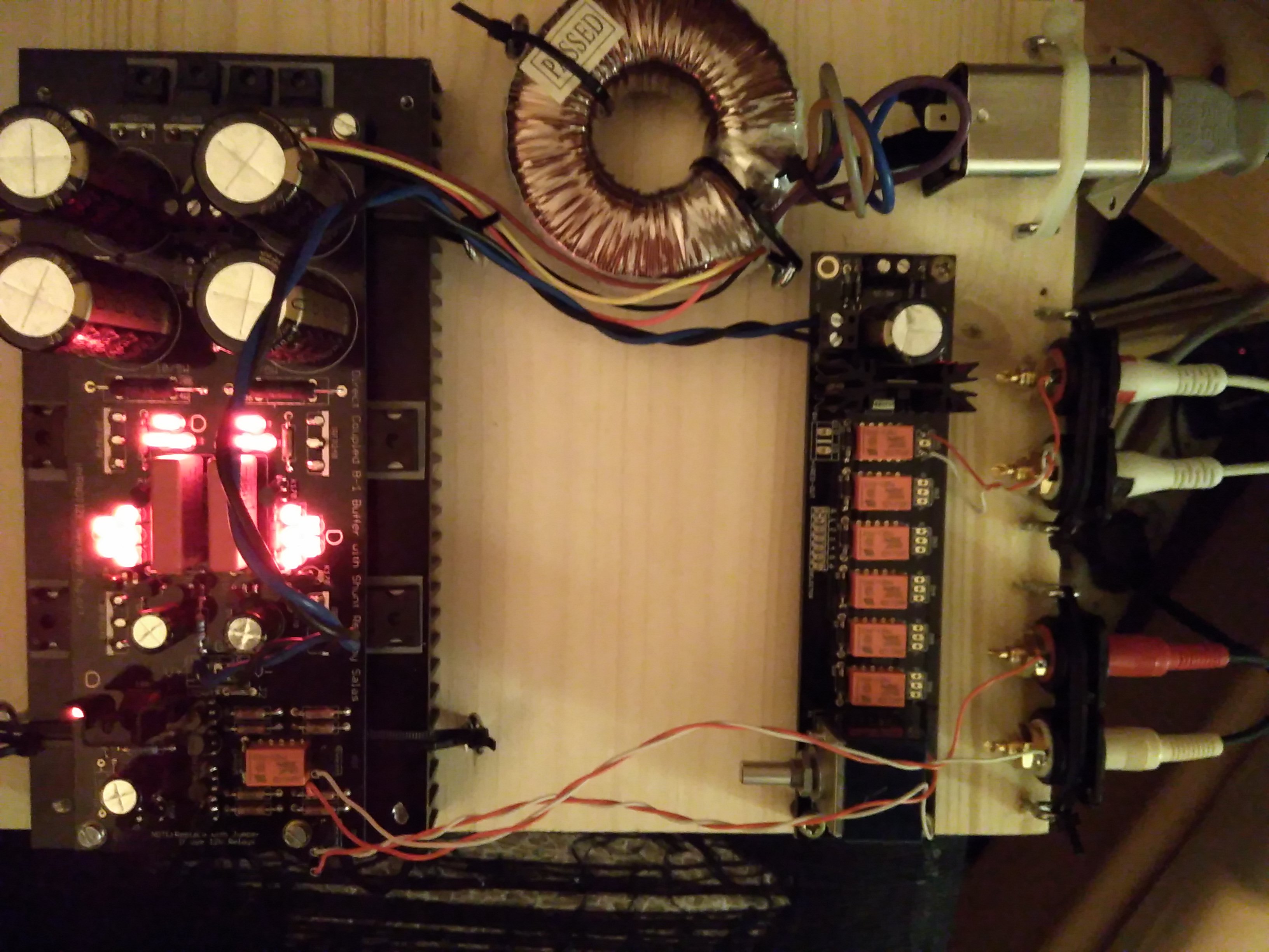

Finally, I got my B1 up and runnig. AndrewT I followed you advise and nothing blew up ;-).
However, I wired it up with my power amps and a audio source and there is no sound. I followed Salas advice in "HOW TO KNOW IF THE CIRCUIT IS WORKING PROPERLY" to check whether it is working.
So, here are my results:
1. See that you have 2V+/-0.3V across R1 combinations. That says the shunts CCS currents are normal.
At my 10 Ohm resistors (hot-rodded version) I measure 1.62 and 1.60 volts.
2. Check that you hear the output relay clicking one time 3-4 seconds after power on.
It is definitely clicking, yes.
3. See that you have less than +/-5mV DC offset on the audio outputs.
Strangely my multimeter shows 0.000V.
4. See that you have +Vout a bit more than - Vout.
+Vout is 9.65 and -Vout is 9.86.
LEDs all seem to work.
I connected a mesmerize I-Select for input selection. I enabled the first input by shortwiring the according contacts. When it is powered on the input is going through to the inputs of the B1. So, this should not cause the problem.
Any advice?

1. Still a high enough CCS result to go by without issues. Very good match though.
2. Good sign
3. Weird. Make sure you measure each channel's output pad at DCmV DMM scale VS the middle output (ground) pad.
4. +V>-V is expected in the Mezmerize. You have a Hypno so any mismatch could go either way due to IDSS & VF tolerances
If (3) is still 0mV try at the 220R resistors next to the relay VS ground. That's the signal path to the relay. So to know if offset or test signal exists. If yes, the relay blocks. If no life signs before the relay, check there is ~10V D-S voltage on each signal FET in the quartet and their correct orientation.
Play a strong 300HZ sinewave from a lab gen or a digital source with no power amp connected to the pre and trace it from RCA input through the modules until it vanishes so to find the bottleneck point. Use the DMM in ACV if you haven't got a scope. There could be some wrong wiring arrangement or a bad part. There are many website signal generators or free software gen applications for PC audio and mobile phones.
You were right of course, I measured 1-1.3 mV.
Very good advise as well. I did as you said and found a wrong wiring of the audio signal. Last project I worked on was a mono amp and that seemed to have confused me.
I have the DCB1 working now and I must say I am impressed. It sounds superb. I never expected a pre-amp to have such an effect. Everything sounds clearer and I can hear more details. Next step will be the case of the amp. Thanks for your help again!
