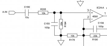

Are your double mono volume pots logarithmic type for sure in the DCB1? Linear pots can open up the volume fast. As a circuit it has no voltage gain as it is a buffer.
I contacted the seller that I sourced the mono Noble pots from as I could not remember...he custom ordered them from Noble in the 90s and had NOS surplus.
He tried to track down specs using numbers he had, but was unable to definitively confirm the fact that to his recollection they were actually linear taper pots.
Not sure where to go from here as they seem to be OK in the system with the Tang Band drivers. I have some Alps pots I'm not exactly excited about using, and also some cheap Chinese stepped attenuators. Swapping the pots out to try and reduce the noise issues I experienced during testing with the Lowther drivers seems an unlikely prospect though.
As far as gain issues, I have run into the subject in several threads. I read the article Andrew linked to. I can regulate the output of my digital source prior to the preamp, and there is no other gain stage besides the chip amp. The Boozehound step up may be pumping out more gain than it should with a 24V battery supply. I was using a 19V laptop supply to power it, but I discovered it was contributing a lot of noise to the system and in actuality only producing about 16V. As I mentioned, it is a temporary solution as I already have everything in place to build the Simplistic Phono. I was using a Clearaudio Virtuoso wood on my turntable. It is said to have a 3.6mV output. The turntable is currently undergoing an overhaul/refurbishment...so I can't do any further testing with it right now.
Measure them division across enough positions and plot a graph so to establish if they are linear or log. Its a very important thing for apparent SPL. Linear pots pass most of the available volume in the first quarter of their rotation as far as the human ear is concerned. BTW about noises when with very sensitive speakers, is there any wire for referencing the chassis to the PCB zero? Either straight to it or through a 10-100 Ohm resistor? If not, test that, it may help. If helpful indeed, remove the simple test wire, solder together two 5A diodes in parallel but with their stripes at opposite ends, parallel a 10 Ohm 3W and a 0.1uF film cap to those. Bolt one end of that safe ground lifting/zero reference system to chassis and wire its other end to a PCB zero. There is a convenient zero middle pad marked G in the regulators output vicinity between V+ & V- pads.
I tested resistance at several positions of two extra 20k Noble pots I purchased at the same time and compared them to the 20K Alps RK27 I have on hand. They are completely different throughout the range and appear to have a linear taper as I have read descriptions of. At 50% of total rotation they measure 50% of total resistance.
I will have to decide if I want to use the 20K RK27, the 25K eBay stepped attenuators or seek out something else. The real disappointment is thinking I had scored a find in the Noble pots at a good price and now I will have to pull things back apart and refit something else...and it seems impossible to find quality pots at a reasonable price.

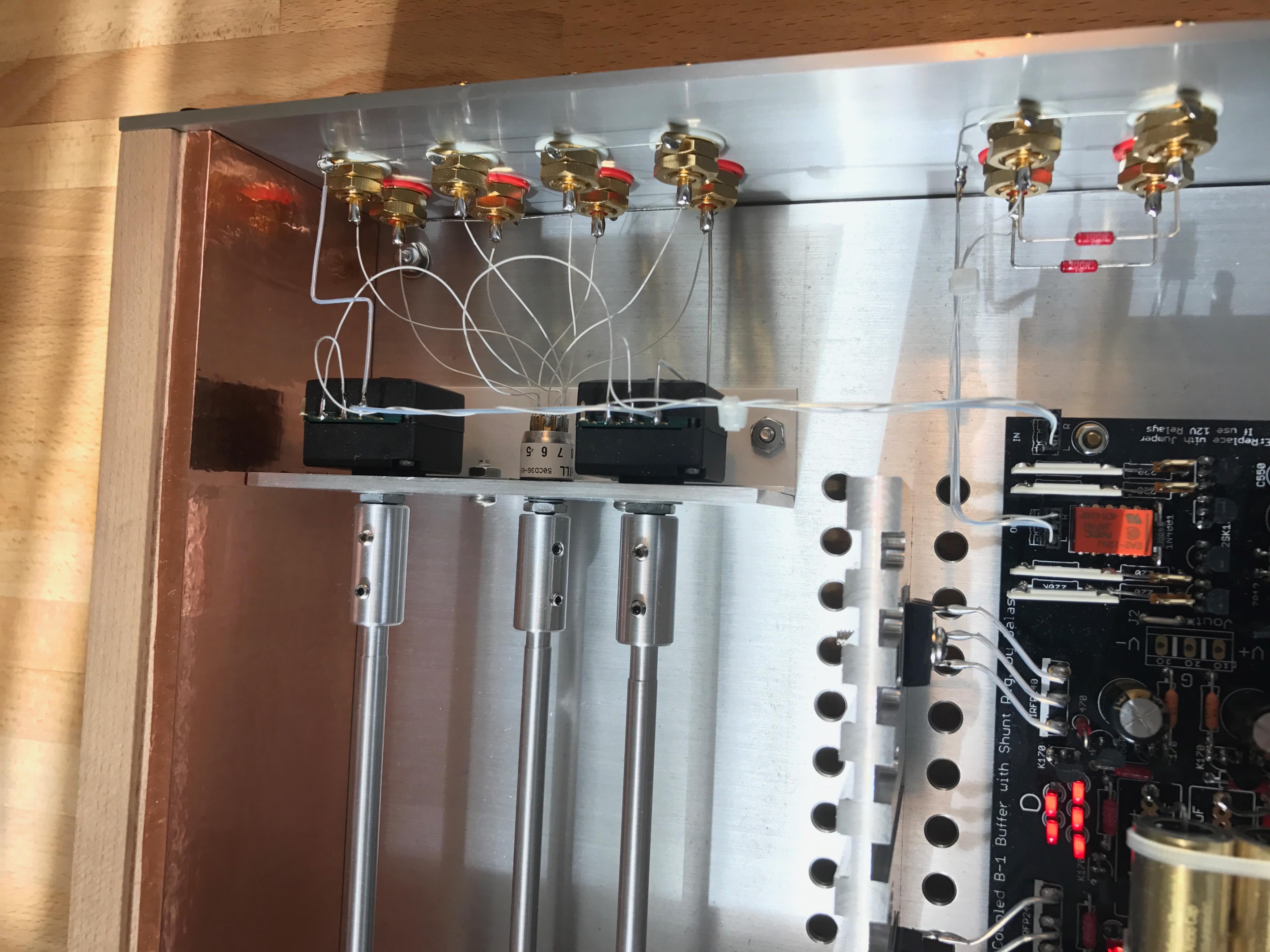

These are the notes I tried to follow when doing the signal and ground wiring:
+RCA IN to pot IN. RING RCA IN TO POT GND. Repeat for channel 2. No link between rings.
POT WIPER pins channel OUTputs to DCB1 INputs. POT GND pins locally linked. One wire from them to DCB1 middle pin IN (GND).
DCB1 OUT1, GND, OUT2 to RCA OUT1+, 0(linked rings), RCA OUT2+
RCAs insulated.
IEC EARTH PIN to chassis (short link). DCB1 to chassis can ground from ground linked POT's body. Or a sturdy link from Vout middle tap to chassis, and the pot will find ground when attached to chassis without GND PINs to body link.

Here is a slightly better pic of my signal/ground wiring for reference...

In general there is wide loop area in your input wiring since its not done with twisted pairs, maybe better if not done with RCA rings ground bus wires but with individual inputs wire pairs heading to the switch while their zero returns star grounded all together at an eyelet fixed to that screw and nut in the middle of the mounting sub-panel.

The single wires from input sockets to attenuators are not right......................
I recently found these EIZZ Chinese made attenuators on eBay, but I know nothing about them...
Each input circuit loop is acting like an aerial picking up whatever interference is inside the chassis.
The input circuit for each input when selected must be a close couple signal pair. No big loops, not even at the terminations.
The same problem for the outputs. Eliminate the big loops.

I haven't had a chance yet to go back and re-test the system with the Lowther drivers to make sure I have everything straight in my head about my attempts to isolate sources of noise. I'm in the middle of a turntable project and am trying to work on one thing at a time...but I am very much preoccupied with figuring out what to do about the preamp...if anything. I wanted to comment on this wiring issue since both you and Andrew mentioned it, and I had doubted my decision concerning the wiring.
I was aware of the standard practice of "twisting pairs" for the purpose of minimizing noise induction to signal wiring before I started this project. I had implemented the technique in other projects previously. However, none of those projects involved switching sources. I couldn't find any solid guidance on the subject in the thread or elsewhere, except that the Mezmerize was available as an option with switching relays.
I looked at as many builds as I could and came across several that had used bus style wiring for the grounds. I also opened up my AI Modulus preamp and took a look at what they did...which it seemed to me to amount to a similar technique, but in hindsight appears to use a separate PCB as a means to star ground inputs to one point...there is no twisting of signal wiring in it.
My question is this...if the decision to not twist signal pairs is so wrong, why would a HiFi designer not use the technique in their well known and fairly respected product?...and if the non twisted signal wire is a source of noise that I experienced when experimenting with the Lowthers, why did I not hear any similar noise from the Tang Band drivers even when I turned the volume to its maximum? The only noise I heard at max volume with the TBs was a slight hiss when I put my ear up to the exit of the front horns. I've attached a pic of the AI preamp internals below for reference.
About the chassis zero reference you already have, try adding 10 Ohm series resistor ground loop breaker if there are little suspicious noises in the background reminding of loop buzz. Maybe a 0.1uF film cap in parallel also. It may also prove better to undo the now input side chassis reference wire(s) and replace with one from that central V zero point pad on the PCB.
Just to clarify...I did not add ANY additional input related chassis reference. My interpretation of the grounding recommendation wording you posted earlier in the thread was incorrect I think.
I thought that the body of my pots (being made of metal) was functioning as a grounding point. I thought that once I connected my input signal wiring to my source selection switch and then to my pots along with the ground bus wires directly connected to the pots that I had a ground reference from the bus wiring of the input RCA rings to the chassis, I was incorrect.
I quickly retested the grounding with all inputs and outputs disconnected as well as the power cord removed. There was continuity throughout the PCB and between the input and output ground bus wiring, but no continuity to the chassis.
When I disconnected the input wiring between the pots and the PCB all grounding was isolated to the input ground bus wiring and pot wiring. When I then reconnected all the input/output wiring to the PCB, plugged the preamp in and connected it to my gain clone I got ground reference to the chassis. I'm assuming this was due to a ground loop through the power cords and interconnects between the preamp/amp. This may have been happening through connections with other equipment as well regardless of using a battery as the power source.
I suppose my first/next step should be to install a proper chassis ground reference at the Vout center pad. Should I automatically include a safe ground/loop breaker of your recommendation? I'm wondering if I should be trying to connect all ground references to the same point if possible? Including the input wiring if I were to revise it with twisted pairs? It would require some kind of compromise regarding the ground wiring I think.
Currently there is only a ground reference for the IEC power inlet and also one for the transformer shield. I read the shield should not be connected to that same chassis ground point, but rather somewhere close in proximity to the transformer.
