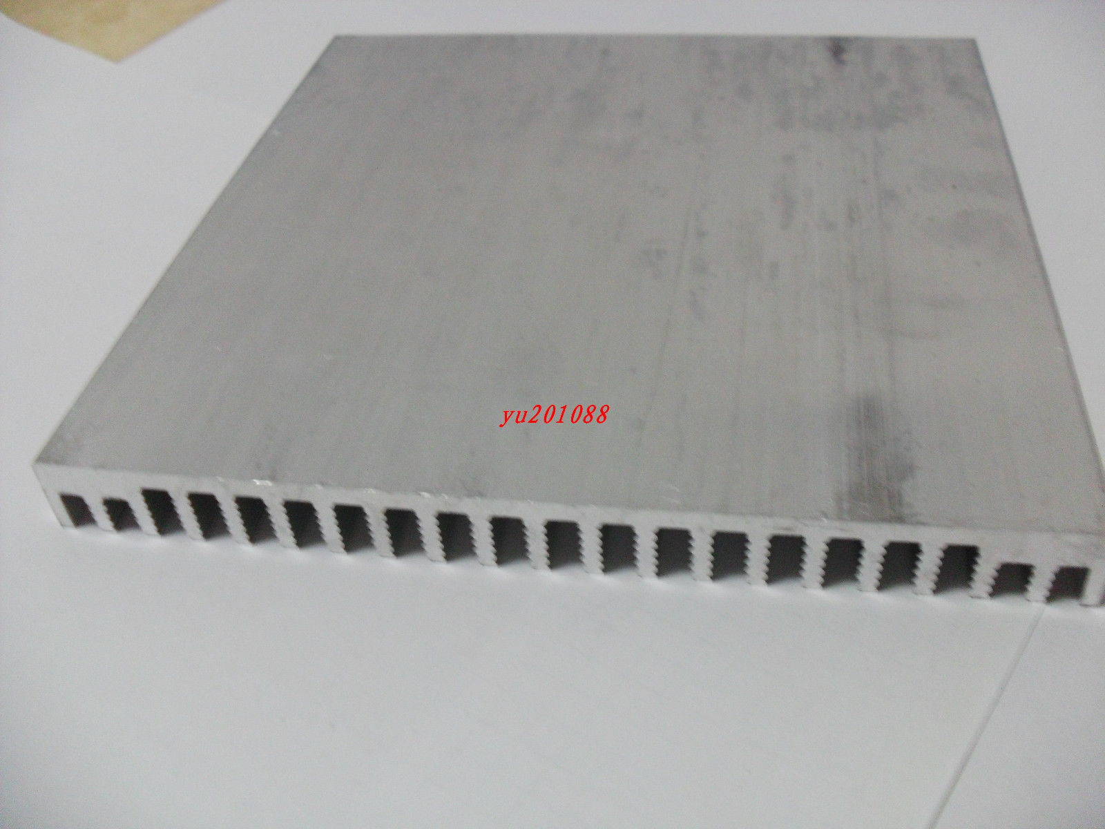

So, i've decided to build a Hypnotize Black DCB1, encased in wood.
While i will try to refrain from hot-rodding it very much, at 200mA CCS current i'm still looking at some heat sinking to keep temps down inside the box to try to extend the life of components inside.
Imagine a plain wooden box, where part of the bottom plate is cut out and replaced with something like this:
This heat sink measures 140 by 140mm, and is 12.7mm tall. The plan is to mount the MOSFETs to this heat sink, secure the heat sink to the chassis so it doesn't hang from and therefore risk stressing the solder joints, and have the heat sink protrude a couple of mm beneath the bottom of the box, but still have some airflow around the heat sink provided by the feet.
If anybody has their Hypnotize DCB1 Black PCB(if there is a difference between the boards) sitting in front of them, and can be bothered, could you please measure the distances in X and Y between the points formed by the four screws fixing their MOSFETs to the chassis below? I only need a ballpark figure to see if i can even find a single heat sink that can do the trick(preferred), or if i need to get two heat sinks instead.
And i would very much value your input on this arrangement, I realize quite a bit of heat is going to be radiated upwards and into the chassis, and some of the heat that is radiated down will get reflected right back to the heat sink by the surface which the box sits on, about 5-7mm away. It's just that i'd like to keep vents in the chassis to a minimum, to minimize dust ingress and for aesthetics.

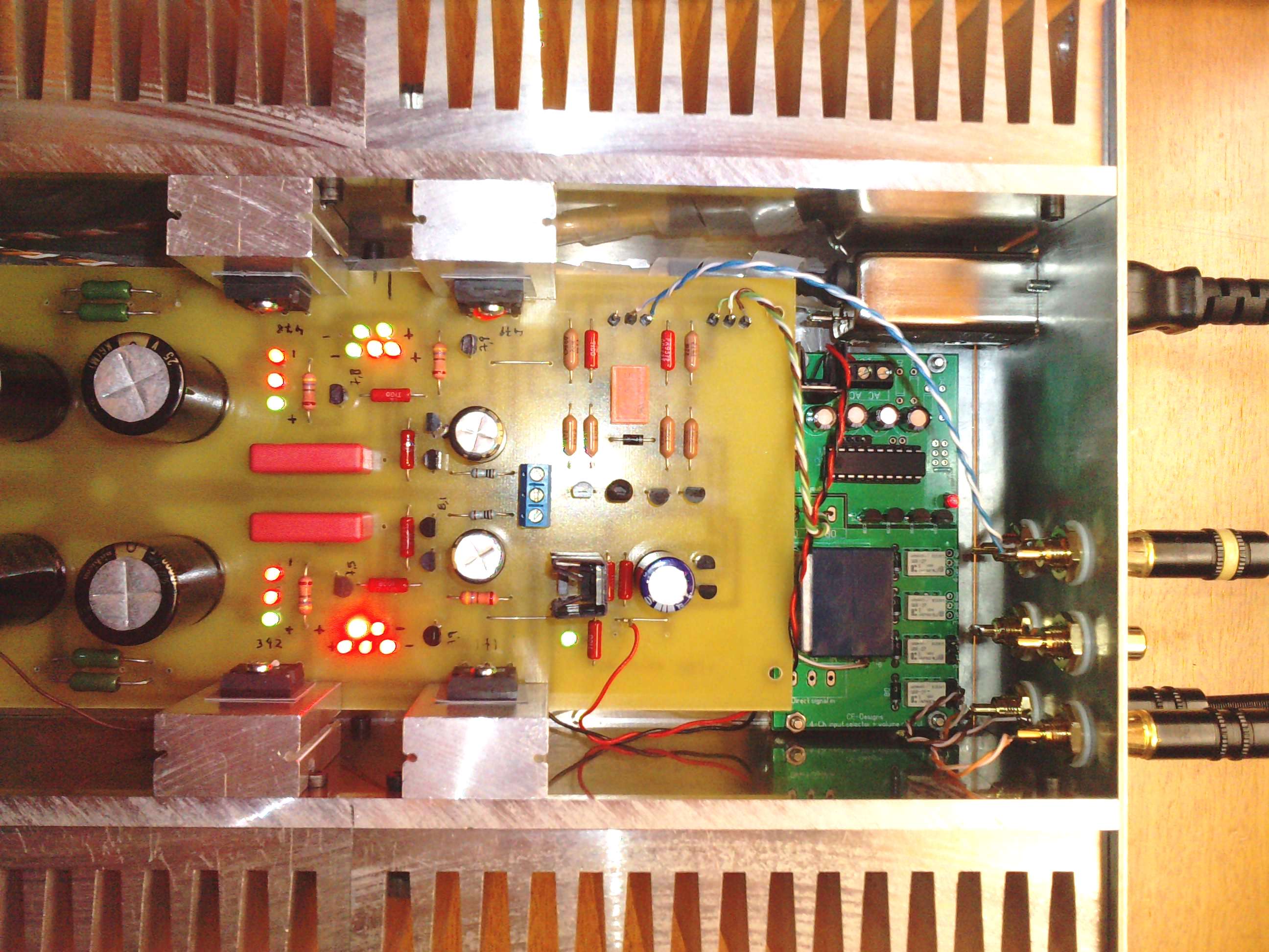

My DCB1 - Hot Rod at 600 mA
If you stand the case "up" so that air can pass up through the fin gaps then the sink will cool the mosFETs.So, i've decided to build a Hypnotize Black DCB1, encased in wood.

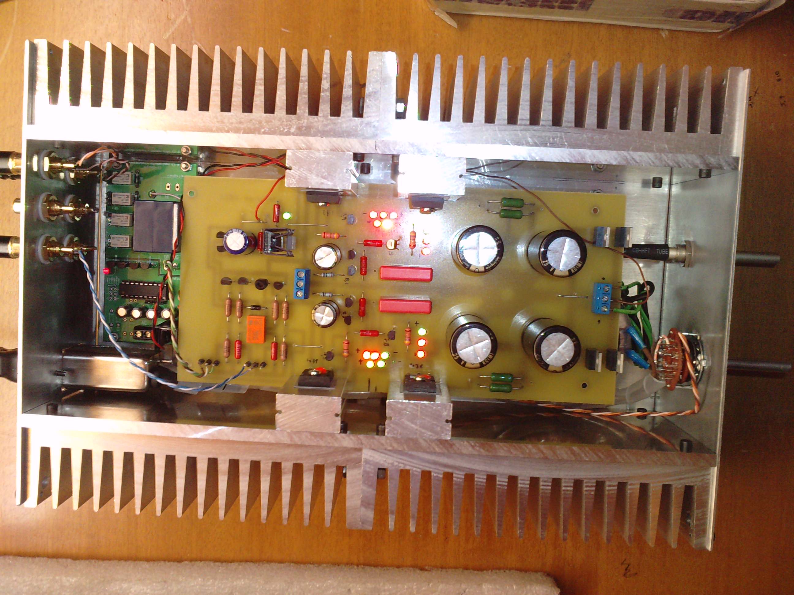

The idea is good but you prob. need some more length to be able to pickup the mounting holes in the pcb.
I made some rough measurements , imagine looking from above with the AC input in the lower end of the drawing.
I used similar approach but made my sink out of 1mm copper.
The area is 180mm x 220mm and has no problem with 10ohmsCCR resistors (about 170ma shunt) i even tried a 5ohm in parallel with the 10ohm increasing the current to at-least the double and the copper worked swell.
Hey that is exactly the information i was looking for, thanks a lot.
