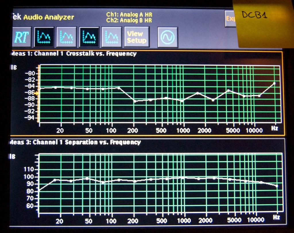

This is what happens with Mezmerize i.e. the most complex one regarding inputs number with common returns (including a stereo pot).
This appears to ignore the interference picked up by the TWO looped Returns feeding one stereo input to the Mez.
What if there are 6 stereo inputs, using 12 returns?
And these are Looped at their remote ends?
Virtually all stereo audio Source equipment uses a commoned Return.
That becomes a LOOP when connected to a DCB1.
Lengths of common return tracks between channels on a PCB which are never absolutely zero Ohm are prone to mixing the signal a bit though. In the plots we saw the separation levels. I.e. Info on inter-channel interference at least.

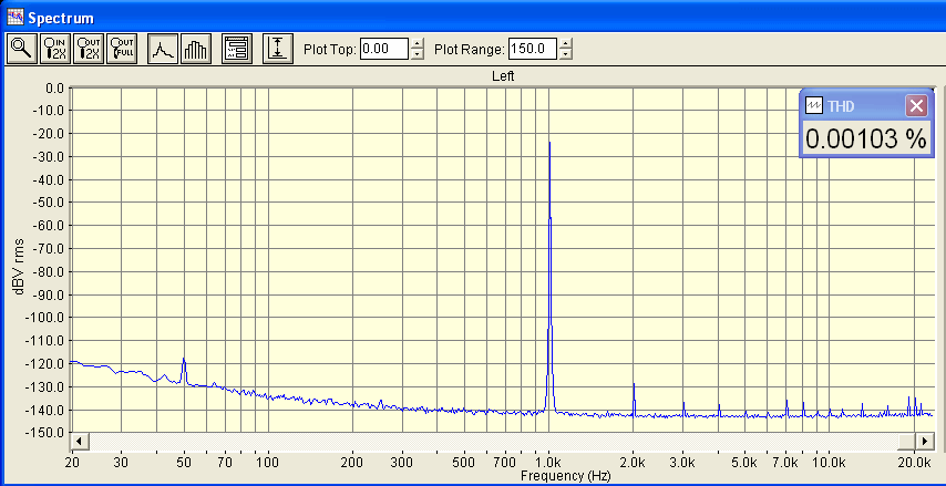

Can use double core and return the shield to one end only if there is some measurable interference problem in a system. I haven't seen hum region or other interference spikes rising above -118dB in conventionally wired DCB1 with coax when looped through a 24 bit audio card.
