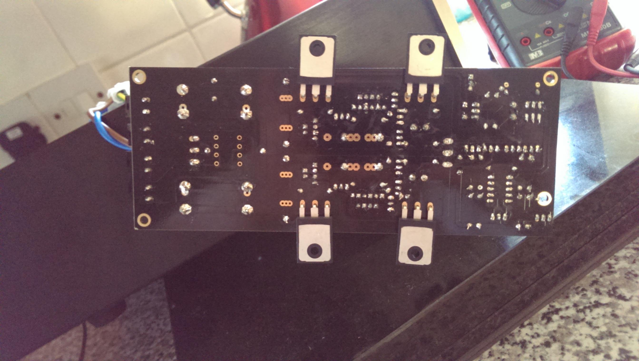

All of the MOSFETS get hot but...
(looking at the second attachment in my last post) The two on the good side get quite hot, one on the bad side gets warm (lower left near the big caps), the other doesn't get warm at all (lower right near the green LED)
I think I may have a duff MOSFET. With out swapping them around is there a sure way of telling?

if you reduce the Vac input voltage, try a 6Vac+6Vac transformer, you can short the outputs to Power Ground/Zero Volts.
This tests the CCS part of the upper and lower circuits.
Once you know that the CCSs are working correctly. you can put back the full Vac and check the voltages around the Shunt stages.
The set of OUT LEDs is very telling.

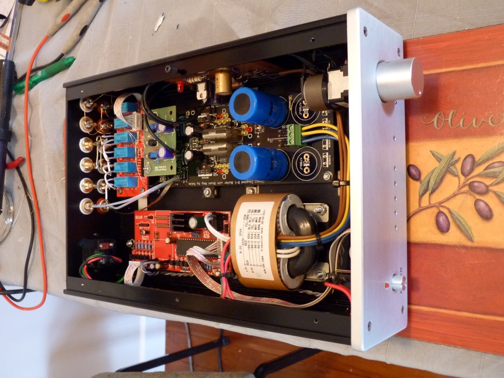

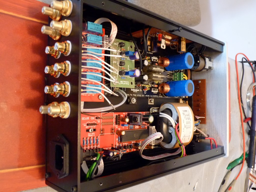

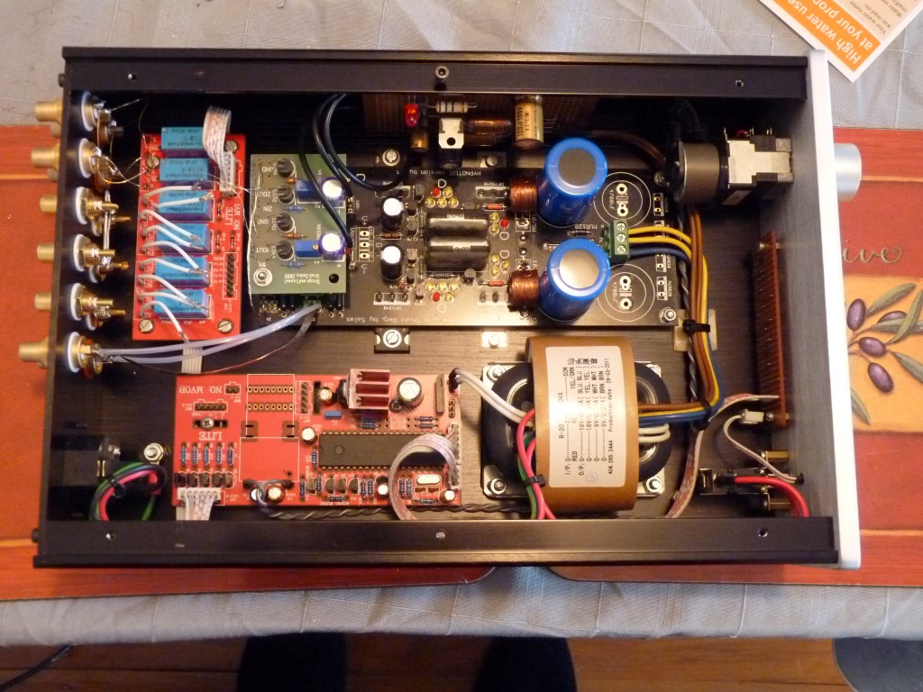

Completed DC-B1
Hi Guys
I completed my preamplifier based on the DC-B1 several months ago.
I would just like to thank Salas and others for there input and time. The project turned out great and I am very happy indeed with the sound.🙂
The preamp has full remote control with a "Lightspeed" attenuator controlling the volume.
Here are some pics-

Very orderly. Congratulations. In what configuration you implemented those extra PSU coils?
Like a choke input filter? TO-220 CCS MOSFETS? What type?
Hi Salas
Thank you. The CCS are IRF610 and IRF9610 as used in your SSLV regs. I had them on hand and they seem to work well.
The coils are actually bifilar wound copper CCS resistors
. They have very little inductance. I found that the sound is influenced a lot by the resistor in this position. After trying different types including Mills I settled on this DIY "copper" resistor. After break-in it seemed to be the most balanced sounding (to my ears).

The coils are actually bifilar wound copper CCS resistors. They have very little inductance. I found that the sound is influenced a lot by the resistor in this position. After trying different types including Mills I settled on this DIY "copper" resistor. After break-in it seemed to be the most balanced sounding (to my ears).
A very nice DIY touch those handmade resistors then. Some DCB1 and SSLV picky on parts quality people insist on Caddock thick film MP series being very suitable there regarding off-the-shelf solutions. Did you use any of those in the tryouts? Also, what make/type are those shiny dark coloured film capacitors?
BTW, what gear make the rest of the system that your remote controlled DCB1 serves in?

I did try the Caddock as CCS. They sound very clear and precise. Quite analytical sounding though. For a warmer and airier sound the 'BI Technologies' thick films are worth a listen. The film caps are WIMA MP3-X2 0.22uF.
My power amplifiers are AMP2 Tripath kits from 41Hz. They are fed off big EI core transformers. Your excellent SSLV1.1 shunt regs provide the 5V and 10V Mosfet drive. Usually I listen to CD through a clocked Marantz CD17KI, but I have just purchased a used Gyrodec turntable which I am looking forward to hearing. So a new DIY phono amp might also be on the cards!😀
