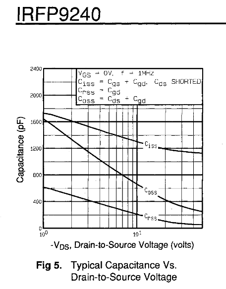

The first mosfet appears to drop from rail to 10 volts..... the next steady at 10 volts.
So, as long as your pre-regulated voltage ensures that Vsd is within the operating limits of the first mosfet then the regulator should work. Assuming the heatsinks can dissipate the power due to the voltage dropped by the first mosfet.
Yes. Its the more VDS you allow for the input MOSFET the less Ciss it will show (leveling out at a point) but dissipation goes through the roof meantime when in hot-rod.
Hmmm I will have to take a look at the data sheets. May have to change the caps in the pre regulator.
This will also be limited by the K170 I suppose?
For the K170 and the LEDs headroom to ground with 20V raw across the PCB smoothing caps you have enough, plus mains drop margin. To kill the K170 it takes over 46VDC across those caps which would guarantee furnace dissipation on the input MOSFET with the mA current level you work now long before you went so high in voltage.
Look for this chart. 10V is good enough for that concern also.
Excellent! Thank you! Clearly 10 is preferable to 7. In my haphazard testing, I thought there was more grip in the bass with better ambient cues at a higher Vds

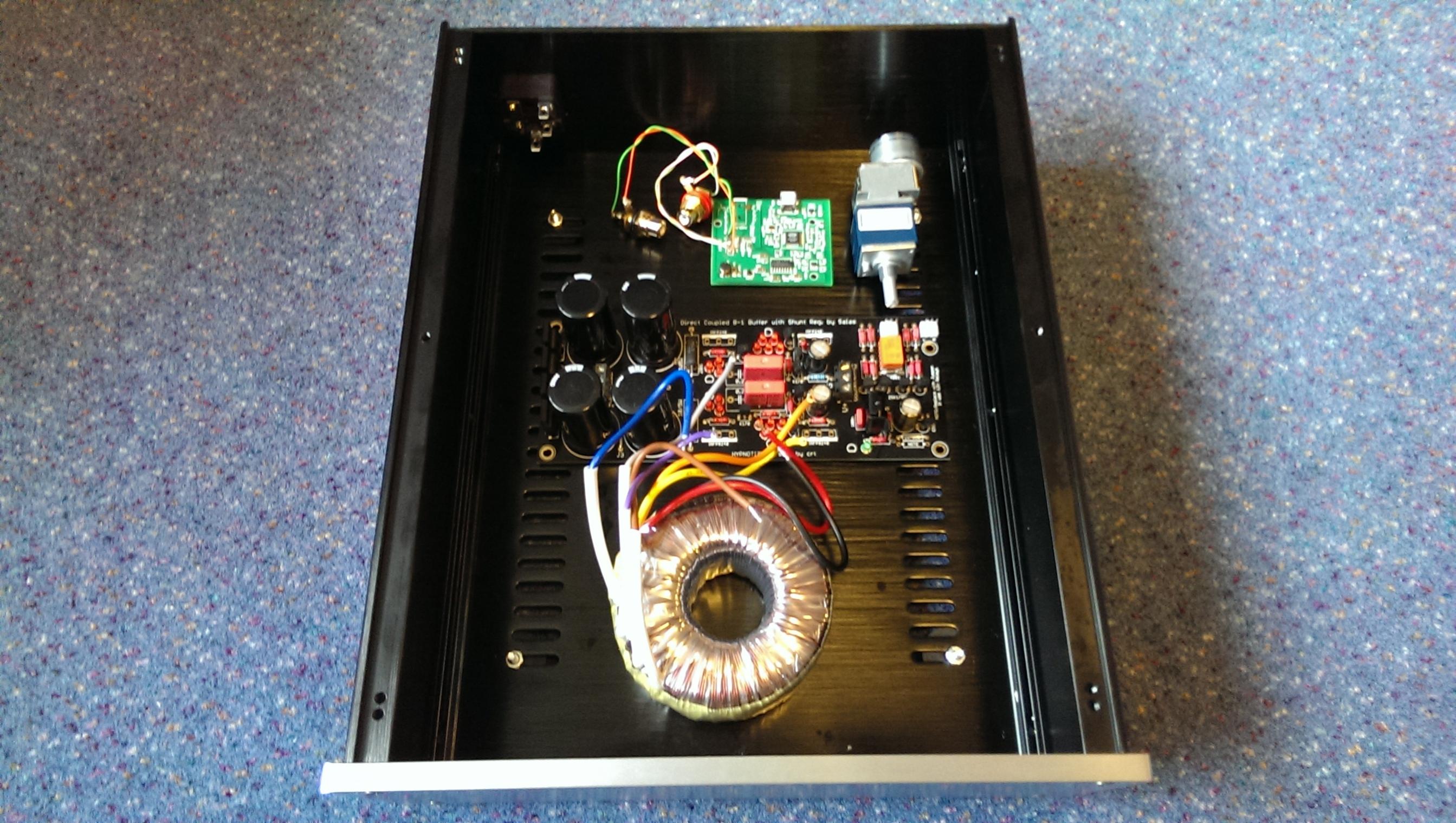

I'm just about there with gathering all the bits to put my pre together.
All my music is digital sourced so I only need a USB input therefore I don't have an input selector. I may add one later if the need arises.
I've attached a picture of my proposed layout. The green board is an ODAC and in the future I may implement some kind of remote system once I get my head round how it works hence the motorized pot. Ive had a look at other layouts and they all vary so I was hoping someone would kindly sanity check my idea.
I have the board, pot and DAC at the rear to minimise signal runs and the tranny at the front. This way the MOSFETS are in the centre as I will be using the base as a sink. Ignore the outputs on the DAC - I put them there for testing.
Thanks in advance.
Thanks in advance.
Using an oscope would help to make sure there will be no bleedthru of clock harmonics in the analogue stuff, better use different transfo for analogue and digital, and maximize boards distance or use right angles between them.
Thanks for the reply salas.
The ODAC is powered from the USB so the transformer is only powering the DCB1. I don't have an o'scope so I was hoping you may be able to give me blind guess and some guidance.
When/if I get the remote stuff sorted I will attemp to get another transformer in there.
