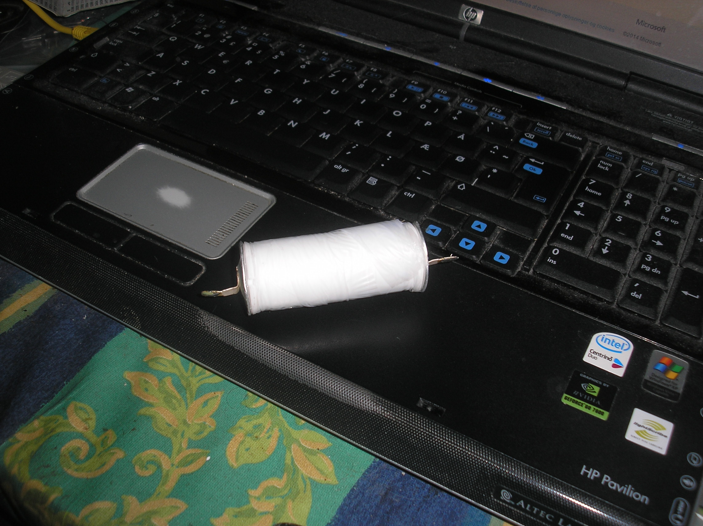

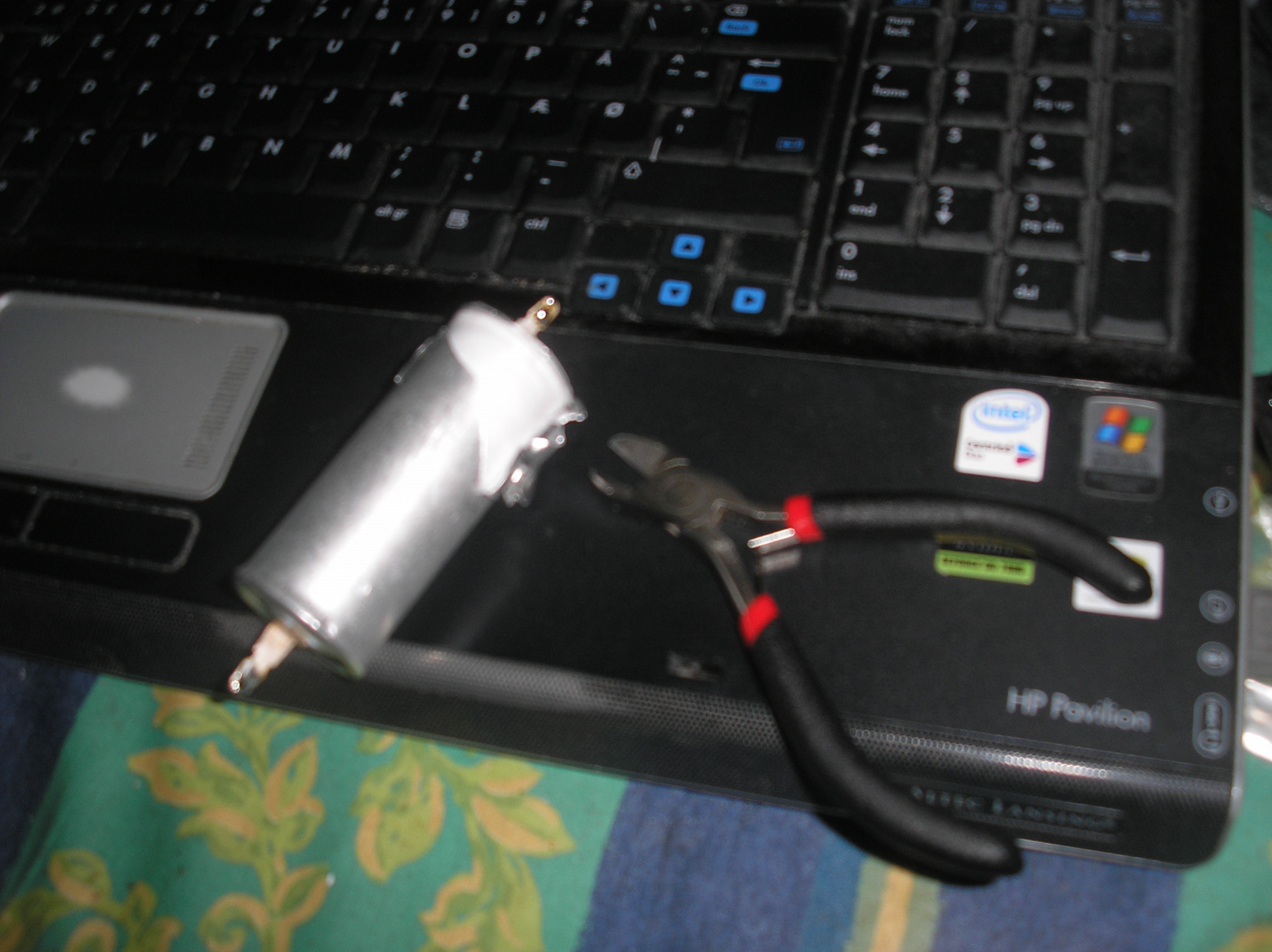

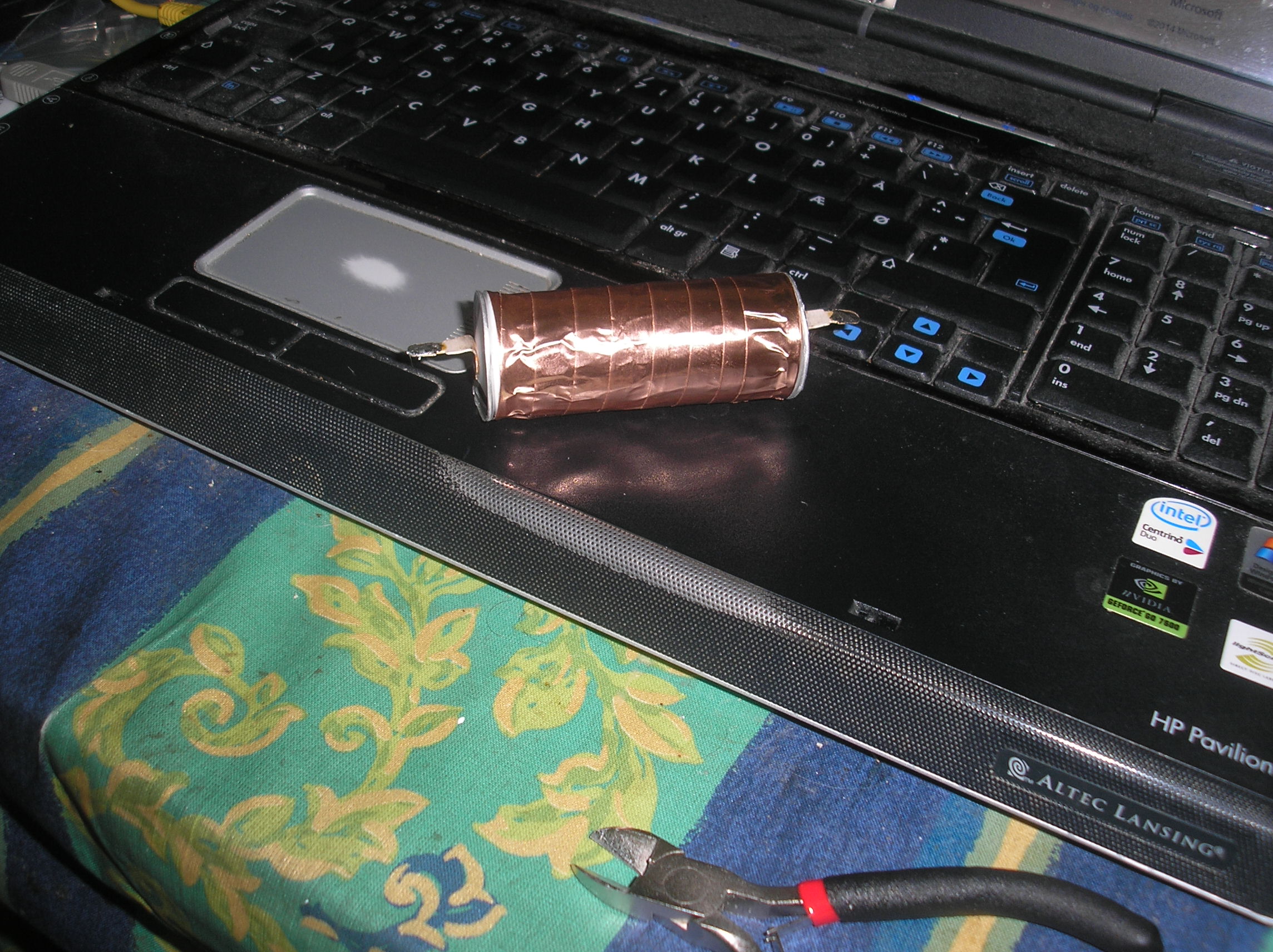

I also think Teflon Ft 3 are good. But they are better if you replace aluminimum housing with copper tape. Have you tried pure polypropylene ?
Aren't the wima poly pro?
How do you remove the casing? Right now, it is a good path to ground and it can be safely squeezed against the case to hold in place. The case is at earth potential.

It was not hermetic. There was holes in the alu. Teflon do not need that I think. Now it is less resonant and hermetic sealed.
Before the sealing was paramagnetic now it is diamagnetic.
