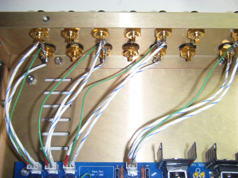

Can any one share experience/recommendations on thin coax shielded wire for the case internal interconnects between the board, input selector switch and RCA connectors.
Very short connections combined with higher capacitance should result in no ill effects.
The screening will help keep the electric fields out.
But you must be careful to ensure low loop area at the ends.
I suspect that rigorous use of twisted pairs will perform just as well.
As Andrew said, short runs is key.
I would add to that, that you should try to keep the spaghetti effect at an absolute necessary minimum, even if it means having RCA sockets at weird places.

Nezbleu, it looks that your coax R and L shields are conneccted togehter at thye RCAs side and from this point, true the green wire connected to PCB GND. Not cconnected to PCB GND at PCB side.

I recommend you look at where the Signal Current flows from the (external interconnect and back to the interconnect. It's the Return route and it's closeness to the Hot route that determines LOOP AREA.
Using coax connected at ONE end and taking the Return Current via a separated Return wire achieves nothing, I mean nothing !!!

Yes, that is how I wired the jacks. The PCB input connectors have 3 pins, L & R hot and a single ground. I chose to join the grounds of the jacks and the shields of the cables at that side, and run a single wire to the ground pin of the input connector. I make no claim that this is a good way to do it, but I have not had any problems (that I am aware of).
Andrew: I'm sure you are right. At the very least tying the 3 wires into a bundle would probably help. I assume I am saved by the fact that the whole mess is enclosed in a grounded aluminum chassis. I simply wanted to use shielded coax so that the signal conductor would be wrapped in an electrostatic shield, while solving a mechanical problem by using a single wire to tie the 3 ground points together (L & R RCA's plus the ground connector on the circuit board).
How would you assess turntable wiring schemes that use a separate ground wire?
PS: Please excuse my wiring, the photo was just to show the coax cable.
the SIGNAL is a two wire connection.
The amplifier measures the difference between the TWO ends of that signal connection and does it's best to reproduce a copy of that difference signal.
If you have a loop area in the signal connection then even when it is inside your enclosure it can pick up interference from all the other emitters inside that enclosure and if the chassis has big gaps (I mean long slots or gaps) the the external RF can also affect the signal loop.
You really must aim for LOW LOOP AREA in every wire pair.
A R+L + single Return can be bound together with the R & L on opposite sides of the Return. The intervening Return will help to reduce crosstalk. That slight crosstalk intrusion is far better than a big loop area and all the interference that the loop will pick up.
This close coupling of R+L will probably apply to the external interconnects. They usually come from a common ground source and a gap between the interconnects will pick up interference when they are recoupled inside the enclose. That's a big probelm that is forgotten about in multi-channel amplifier and overcome in monoblocks. Dual monodoes not solve this as far as I can see. The old and ridiculed interconnects that came as a figure of 8 pair kept the loop area low !!!!!!
